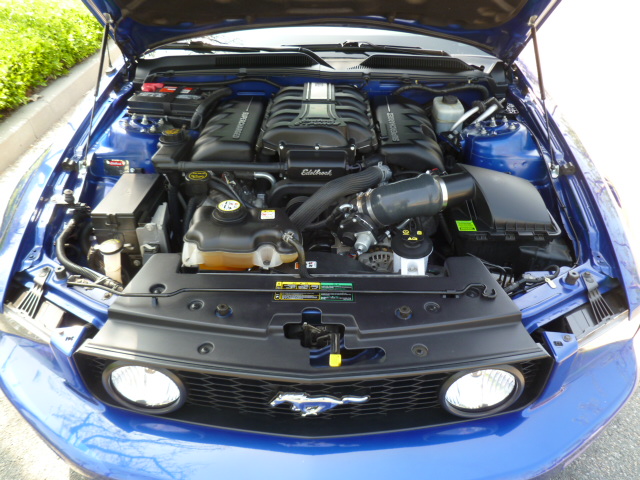

Duke - It's a little rich but I still get 21+ freeway MPG if revs are kept in the moderate range. Consistent runs over 3500 rpm brings the average down to 15-18 mpg. A/F mixture at idle is perfect.
John SCB wrote:Duke - It's a little rich but I still get 21+ freeway MPG if revs are kept in the moderate range. Consistent runs over 3500 rpm brings the average down to 15-18 mpg. A/F mixture at idle is perfect.
That is good....under WOT, you are rich and have some HP on the table. Any way to tune WOT fuel tables?
John SCB
Posts: 1869
Post by John SCB »
Yeah, the tuner wants $500 to do it. I'm damn near broke already.
John SCB wrote:Yeah, the tuner wants $500 to do it. I'm damn near broke already.
Find out what he is using for the tool, buy it, and do it yourself.

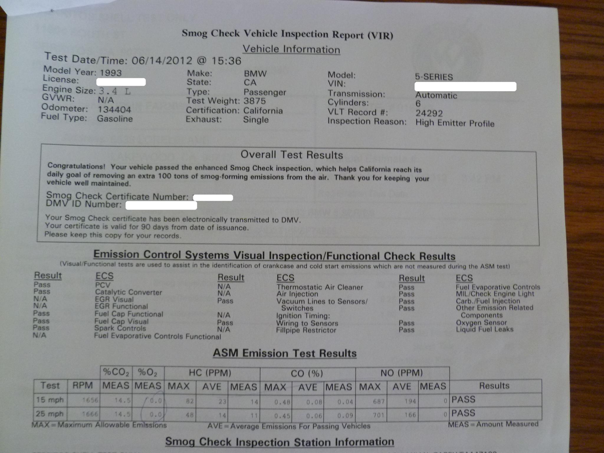

That was the original plan. I couldn't convince KSK to sell me the Alpina B10 Bi-Turbo kit for the E34. They told me it would never pass smog in California. That's when I decided to supercharge the mustang instead.

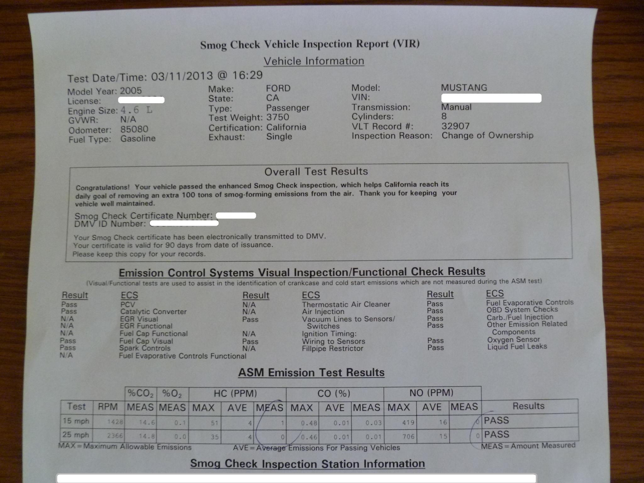

Both cars burn clean, but check out how much more efficient the GT is over the E34:
Both cars are fun to drive. One has a stick and more balls, that's all.
Posts: 27418
0 PPM on Nox on a BMW??? :shock: :shock: :shock:
I've never seen anything like that, even on the newish ones I've got. The old E28 did pretty good for me and was still down to 4HC and .02CO on an unloaded test at 2500 when I sold it with 330K on the clock, but zero on Nox? Unbelieveable! :up:
Or is there more to the story? :laugh:

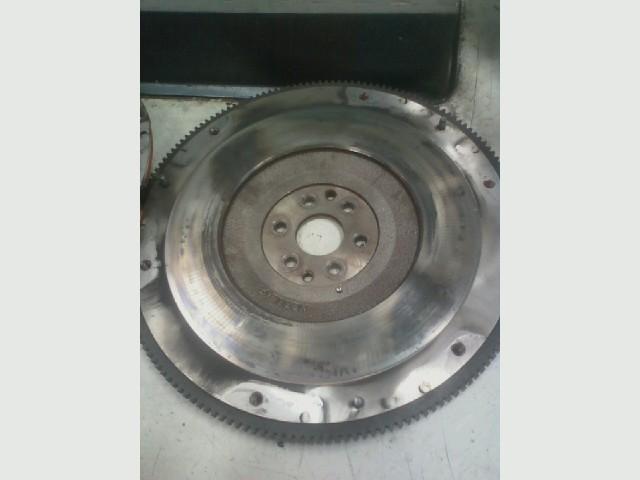

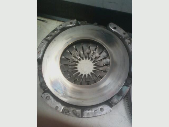

Last October I had the local speed shop install a new Centerforce Dual Friction performance clutch. I was told it was race ready and could easily handle the HP of this car. I took it back three times (starting from the day after installation) complaining about problems with pedal travel, slipping, dragging, etc. Each time I was told it was normal during the 500 mile break in period. No burnouts. I tried to get used to it. Even my gas mileage took a hit; about 3 mpg less than before the install. Two thousand miles go by. Two weeks ago the speed shop took it out. Here's how it looked:
Pressure Plate
Flywheel
What do you guys think?
Posts: 6859
Joined: Oct 10, 2008 1:48 PM
Post by Coldswede »
Looks to me that pressure plate might not be flat. Two hot spots 180* apart. :dunno:
John SCB
Posts: 1869
Post by John SCB »
Coldswede wrote:Looks to me that pressure plate might not be flat. Two hot spots 180* apart. :dunno:
Exactly. The pressure plate was severely warped. The most annoying part of this exercise was being told everything is "normal". I had to tell the guy to pull it apart. Based on my experience with this shop, I don't know if the problem was with the parts or installation. It may even have been a combination of both.
After it was clear there WAS a problem, I had them install a genuine OEM Ford clutch kit. The guy was going to charge me $300 for the reinstallation, but finally agreed to charge nothing for labor. The Ford parts were $800. Then there were problems with the second installation as well. Even guys that specialize in these jobs can't seem to do it right. With thanks to Mark from Bahn Motorworks, he fixed it. That guy is not only the best automotive tech out there, he's a great friend as well.
So, nearly $2k later the new clutch is working great. Lessons learned:
1. Don't fix it unless it's broken (or very nearly broken).
2. Go OEM every time.
As for installation: Unless you're doing it yourself or with a known expert, it's a crap-shoot.
