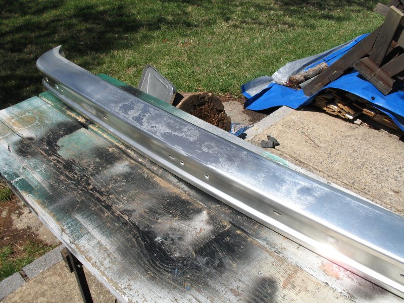

Doing something about the anodized finish that is failing
and looks like failed clear coat paint.
| Coarse 240 grit wet sanding started to remove anodize coating. |
| The anodize is very hard to remove and requires a lot of sanding. |
| Test polish an area after 1500 grit to see what is going to be possible. OK, keep going! |
Update Dec. 3, 2009
(Links to webpages no longer available have been removed)
Very difficult to remove anodize from bumper surface, starting
with 220 grit wet/dry silicon carbide paper and two different pad type sanders, to get the anodize off and get down to the
aluminum. Make sure that you are using a straight line sander when you get to the aluminum, to do all your resurfacing
work. Don't use an orbital sander at this point! Discussion with several owners of other model year E28's (1987 and 1988)
makes me suspect that the anodize applied in 1982 production was much thicker than applied to later models. These exhibit
anodize removal simply by using a steel wool pad, after applying some oven clearner.
Hmmm, oven cleaner and even a solution using 100% lye didn't
touch my bumper anodize! Perhaps an anodize was not used on later production, but something like a clear coat finish? That
would explain the easier removal process involving steel wool and household cleaners on some E28 bumpers. These chemicals
had absolutely no effect on my bumper.
On this rear bumper, I have had to use a draw file technique
to cut through the anodize enough to allow the silicon carbide to be able get a hold on the surface for removal. I've got
to find a better way to deal with this, before I attempt to polish the front bumper.

| Rear bumper in the sun. |
| Rear bumper in the shade. |
With the rear bumper finished and a lot of knowledge gained
in the process, I'll start on the front bumper later this summer, but the process I'll use will be much different. I'll elaborate
here, when I start on the front bumper. Such fun.
