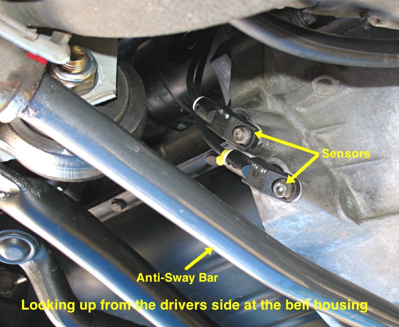

Excellent reminder, Mike, thanks! I use a small colored cable-wrap (yellow one in the pic) at both ends. Goes on easy and lasts well.

That's a great idea. I love my Costco assortment of 1500 colored zip ties, I use them for everything.
BTW-has that car ever been on the road? that thing si CLEAN underneath...lol
