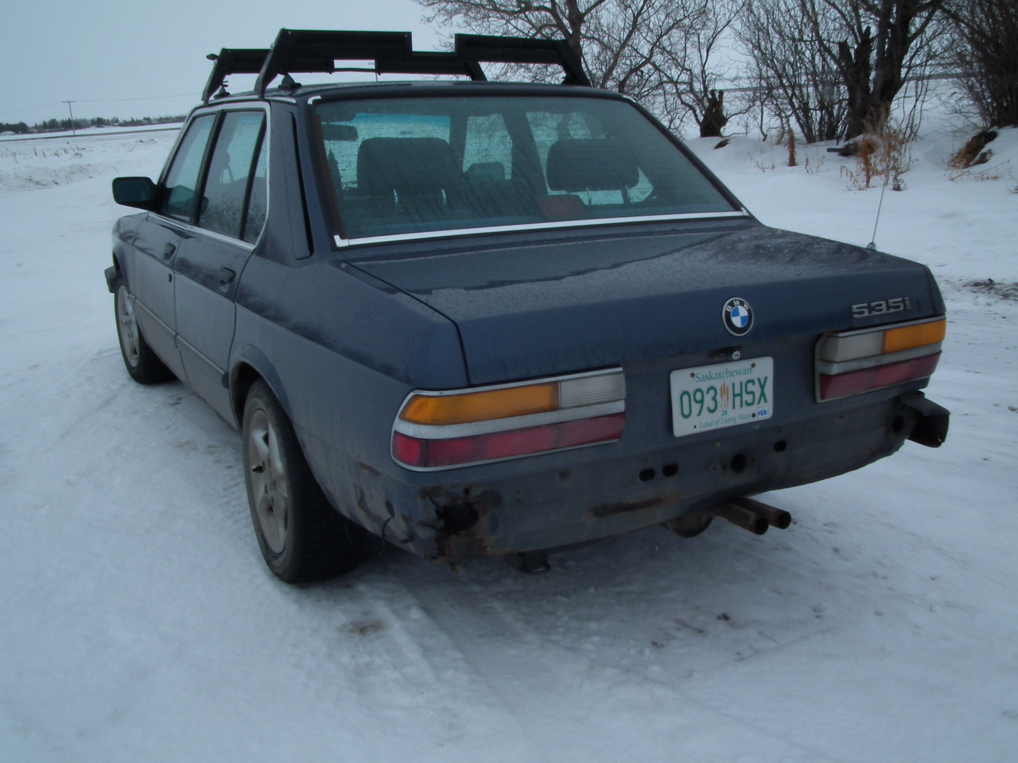

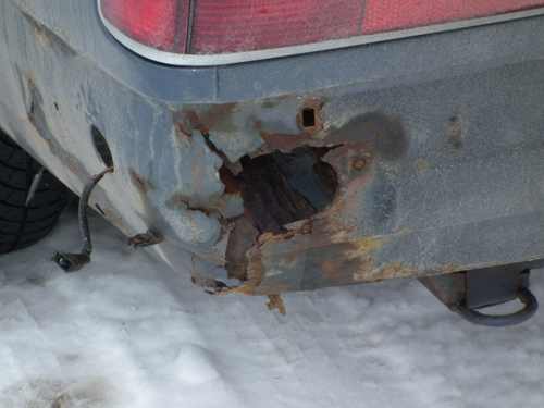

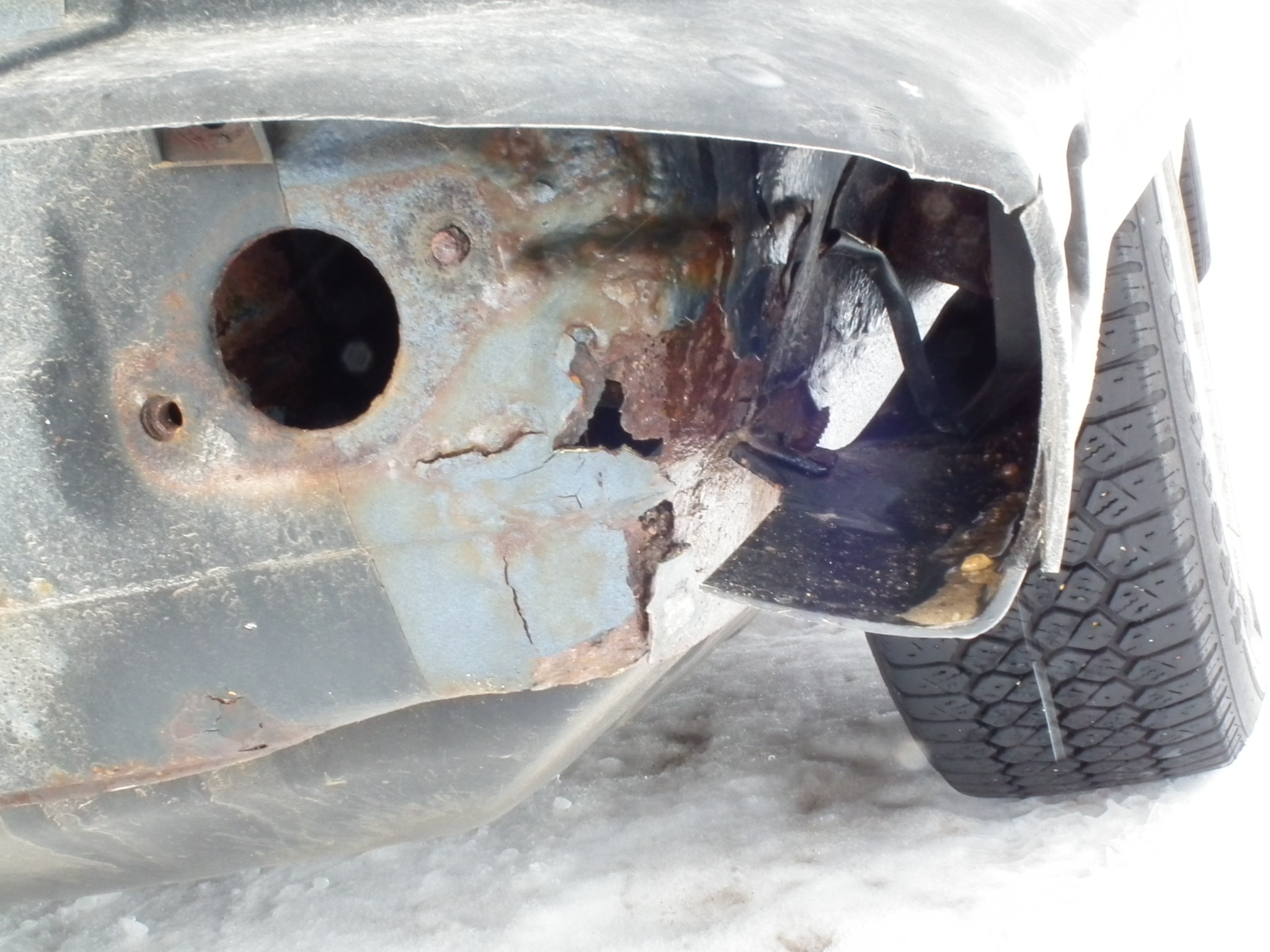

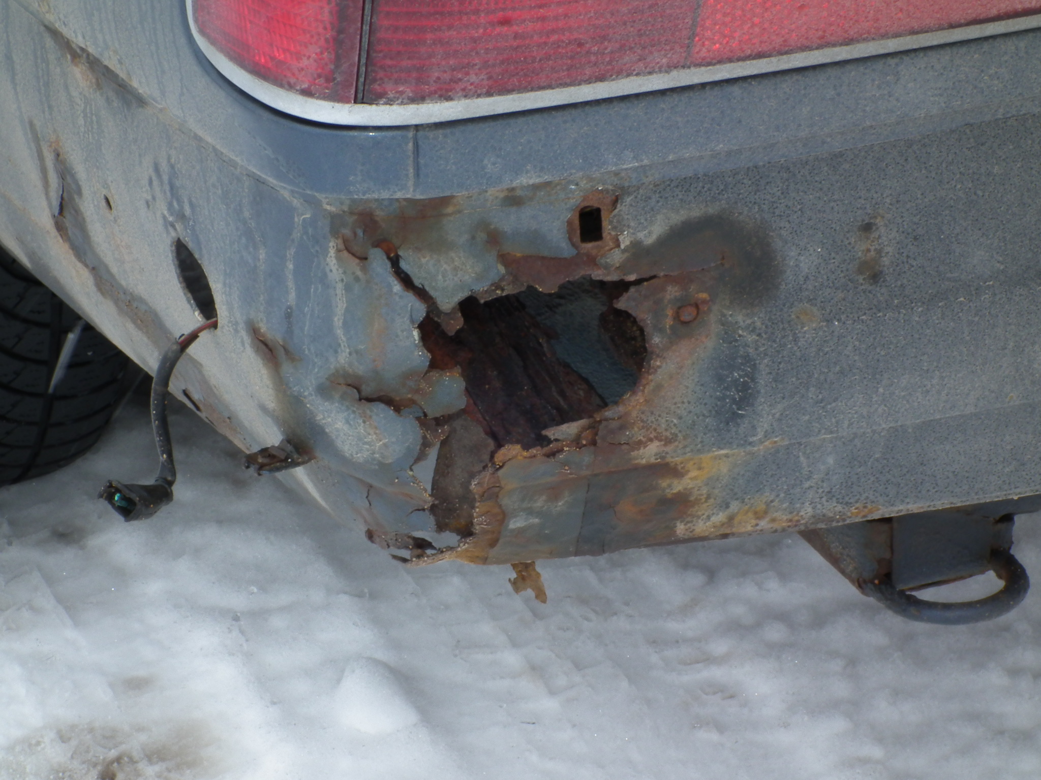

bought an '85 535i a while ago, as well as an '86 parts car. The 85 had a smashed up rear bumper, the 86 didn't, so off goes smashy and surprise surprise:
2 of the bolts snapped off, left and right sides of the bumper, and one has nowhere left to go.
Full sized pictures:
