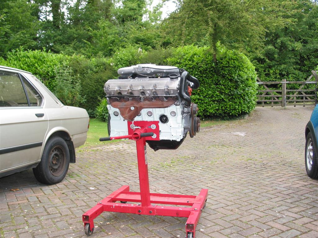

mounted like this

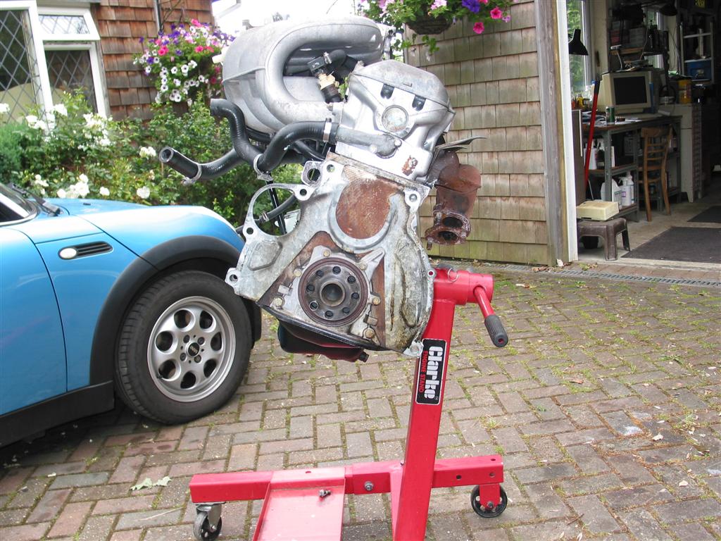

I can recommend Clarkes H style engine stand. Heres mine with a lowly M20 on it, but it shows you the idea.
The thing about this one is that it leans the engine back at about the same angle its in the car.
