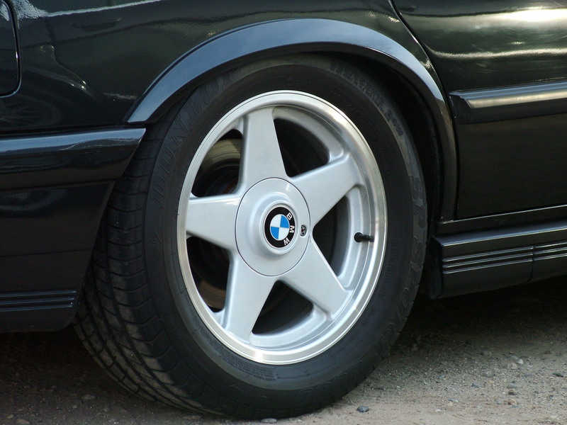

Hey, I like those wheels! :) They're Azev type A's, which are pretty uncommon. I've only ever seen one other e28 with them and if I remember that was in a picture of a car somewhere in europe. At least I don't have to worry about meeting another car on the road with the same ones.

stuartinmn wrote:Hey, I like those wheels! :) They're Azev type A's, which are pretty uncommon. I've only ever seen one other e28 with them and if I remember that was in a picture of a car somewhere in europe. At least I don't have to worry about meeting another car on the road with the same ones.
To be clear I love the wheels, but they look white to me. I am now thinking that is light at play in the picture. C'mon give me a daytime pic.! :banana:

Here's a closeup of one of the wheels:

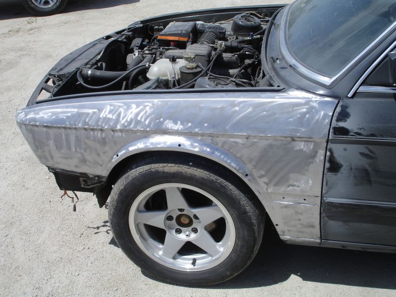

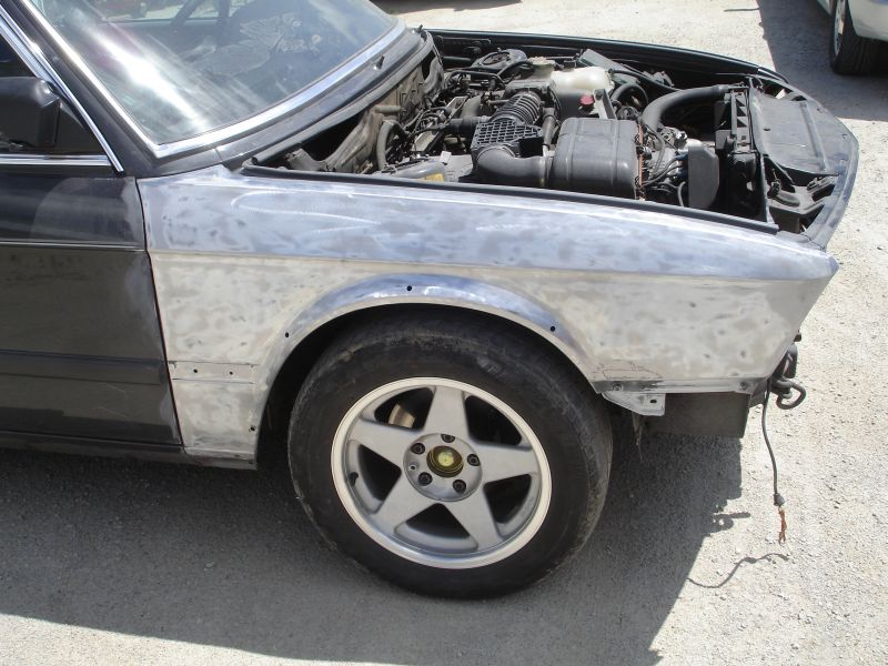

Here are some of the first photos. The bare metal looks pretty good in these, but not surprisingly there's more rust than I was aware of...it will need some patching in the rocker panels and floorboards. The hood and both front doors will be replaced (which I already had planned) and there's some rust in the driver's side rear door that was hidden underneath the weatherstrip.
Are they stripping everything down to metal? Looks like a big, big job! Are the wheels gonna be ok through the process? I think I'd feel better having some old TRX's with ratty tires on it for rolling around the shop. FWIW, I think the wheels look great on the car too. :up:
The big question; will it be done in time for 5er Fest? :banana: (or are you going?)
Posts: 9753
Yeah, the whole thing is going back to bare metal. This place goes by the theory of it's best to start from scratch, so they 1) find anything hidden that should be repaired and 2) so they have full control over the paint. They've already found some things that would have otherwise gone unnoticed - for instance, I thought the replacement front doors I provided were totally rustfree, but when they stripped off the paint they found some rust in the seams that needs to be cut out and replaced with fresh metal. I'm not planning on 5erfest this year, the car may or may not be done by then.

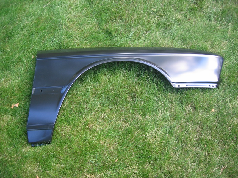

The right front fender initially looked good, but they found the bottom edge behind the wheel was pretty rotted. This could have been fixed, but it ended up being just as cheap to buy a whole new fender.
New fender goodness. :banana:

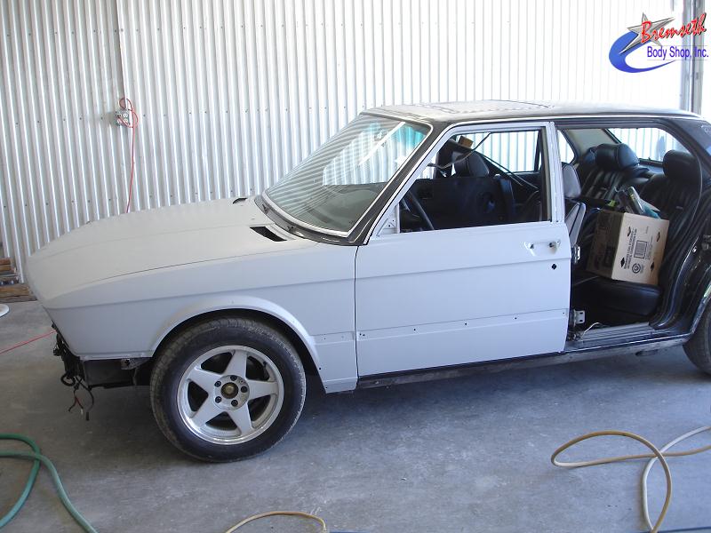

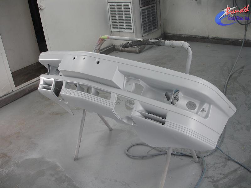

Finally, they're about done with the repair work and the fun stuff starts: In these photos there's several coats of wash primer (an acid etch that bites into metal for good adhesion between the metal and the epoxy sealer), 2 lights coats of epoxy sealer, and several coats of sanding primer.

did you leave the gutter trim on?? i cant really tell but it looks like it
