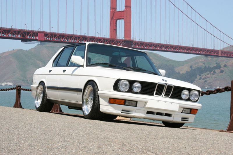

I know people run 255's in the rear with a 9" wheel and an offset of 24-26. Also, since I know you're looking at lowoffsets...eze56 (Edgar) has 17X9.5ET13's in the rear and he seems to be well off with a 235 on there...Note this is all with rolled/trimmed fenders.
Here is Edgar's car:

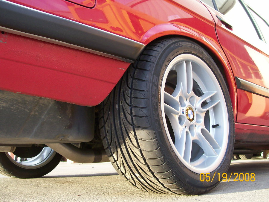

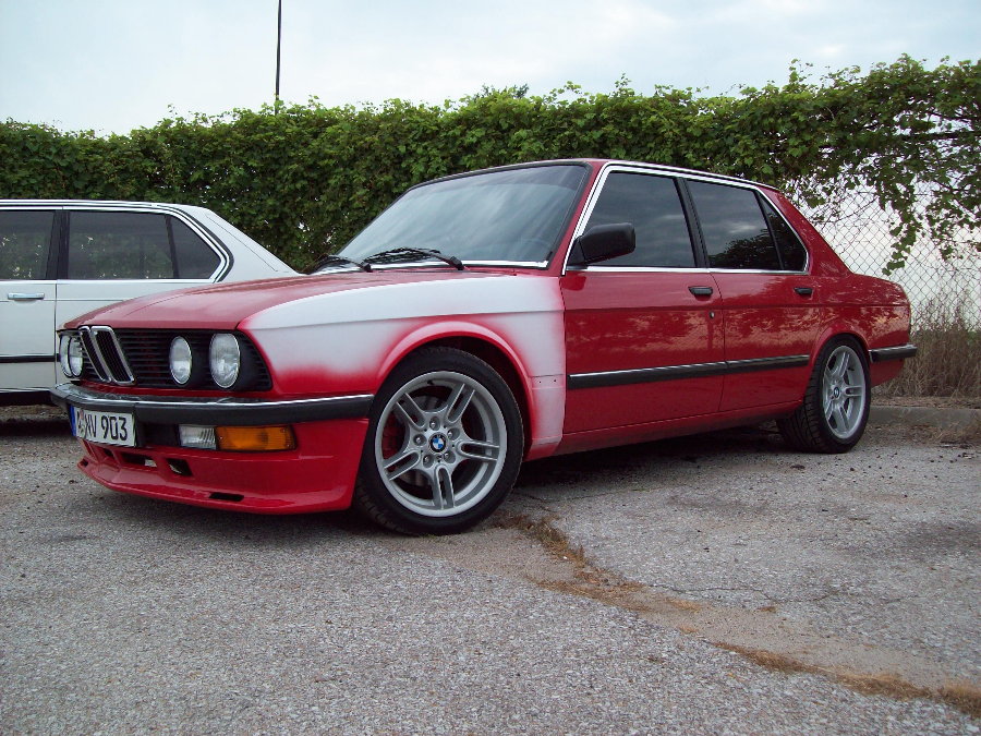

Chris nailed the wheels specs even though his brain hurt. Tires are 235/40/17 and 255/40/17.
Fenders have had heavy metal "persuasion" inside the well. I may massage it a bit more as it will rub a bit with weight in the back when hitting a large bump. It should help out when I get my stiffer suspension on as it's pretty low but with a low spring rate. I've got more pics if anyone cares.
