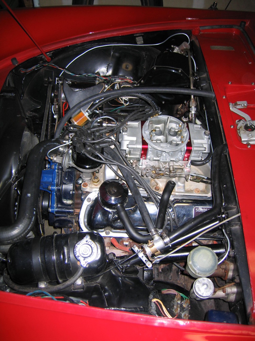

Here is a picture of the custom carburetor that Paul Burke made for me. The main body is a 600 CFM, double pumper with custom made metering plates for tuneability. Notice the jets that he installed in the barrels, cool stuff. Also see that there are idle mixture adjustment screws on all four barrels. It does indeed idle on all four and the throttle response is amazing. No vacuum secondaries either, manual linkage. The car runs like a dream too. It still is just a 260 but is fun. Paul an I have a plan for a larger engine in the next couple of years.

Wow that is one cramped engine bay. How do you get to the rear spark plugs?
Anyway, cool ride dude. What day are you coming out to Big Bear?

4 corner idle is pretty nice. Can be tricky to tune, I had a Holley street dominator on my 442. The secondary linkage ran through the center of the main body, it was freaking huge! It really helped on 455 cu in. "poor breathing" olds engine. The car would still run 12's though. Ahhhh, memories!
Thanks guys....Tammer too ;) ...!
The spark plugs can all be remove in the engine bay except for #8. There is a plugged hole in the firewall on the drivers side to get that one. There is another hole to get to the rear valve cover bolt too.
