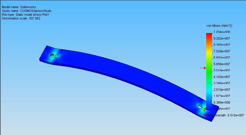

<img src="http://e28-535i.com/upload/e30-e28seatbrackets-6061.JPG">
That's plenty strong for me. That converts to about 12 million pounds of force. It will be even stronger than that because I will use countersunk flat head screws for all the holes, effectively giving me studs to mount the e30 seats on. I'm reasonably sure that the seats or the body will fail well before that point. I will do more calculations tomorrow for the tab style.
Would someone tell me what material and dimensions are used for the other style of adapters?
I need to get to sleep, so more will have to wait until tomorrow.
Ian in Portland
