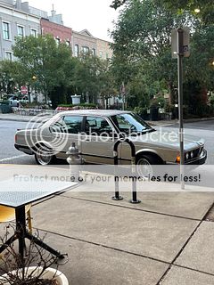

I will. In the meantime this is my 85' 745i (California Car)

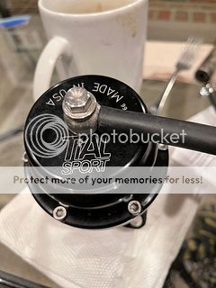

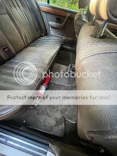

Nebraska, I got 2 of 3 components installed.

You will be amazed the responsiveness when coupled with an updated turbo. At some point down the road, you might also consider installing a Superior shift solutions kit to firm up the shift points a tad.

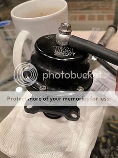

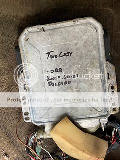

HA, glad to see my WG and ECU still working. Did this car come from GA? I only recall making a few black ones as they ran more than plain silver. All sourced from TCD except one.
I have a GTX3582R wheel in my black 745, stock turbine wheel. Moves a pile more air and boost threshold seems about same as stock. It will knock around 9-10psi, before with stock 47mm comp wheel? Not a chance.
Nebraska e28 beta tested my original proto back in 2017! I will never forget the call as he was with Steve and he was copilot 'winner, winner chicken dinner' he yelled when they hit 15psi.
