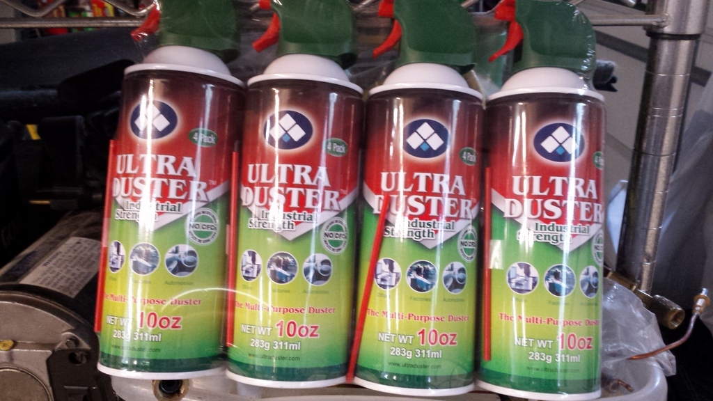

Forget 134a and go 152a. You know this stuff
google it and get convinced.
cheers
