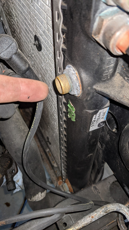

Next PO removed the frickin AC so I can only assume this is where some sort of AC lines used to attach?

Looks like an automatic radiator in a 5 speed car. That port is for the automatic cooling I believe.
Posts: 27975
Re: 88 535is engine bay questions
It is an A/T radiator. The only problem it might be is cosmetic. It will work just the same.

Thanks for the reference pics. I thought the radiator might have been a trans cooler adapter. I should probably at least plug them huh. Also knew the battery cable management was stupid. I think maybe that extra cable was done by the stereo installers. I took all that junk out but there is definitely wires I think are related to that. I do have the ground strap from the motor and it looks good and the negative from the battery does mount to that mount on the sidewall next to it. So I'll look into taking more wires out. Fun stuff

Kowalskicw wrote: Dec 06, 2020 5:24 PM Thanks for the reference pics. I thought the radiator might have been a trans cooler adapter. I should probably at least plug them huh.
It's not a trans cooler adapter -- that is the trans cooler in that side tank. No need to plug them -- nothing will leak out.

Oh ok that's kinda cool it's built into the radiator. I plugged them just to keep anything from getting in and ruining it from the inside out like the rest of this car. Still waiting on a new trans cross member from Germany so this project has been on complete hold.
