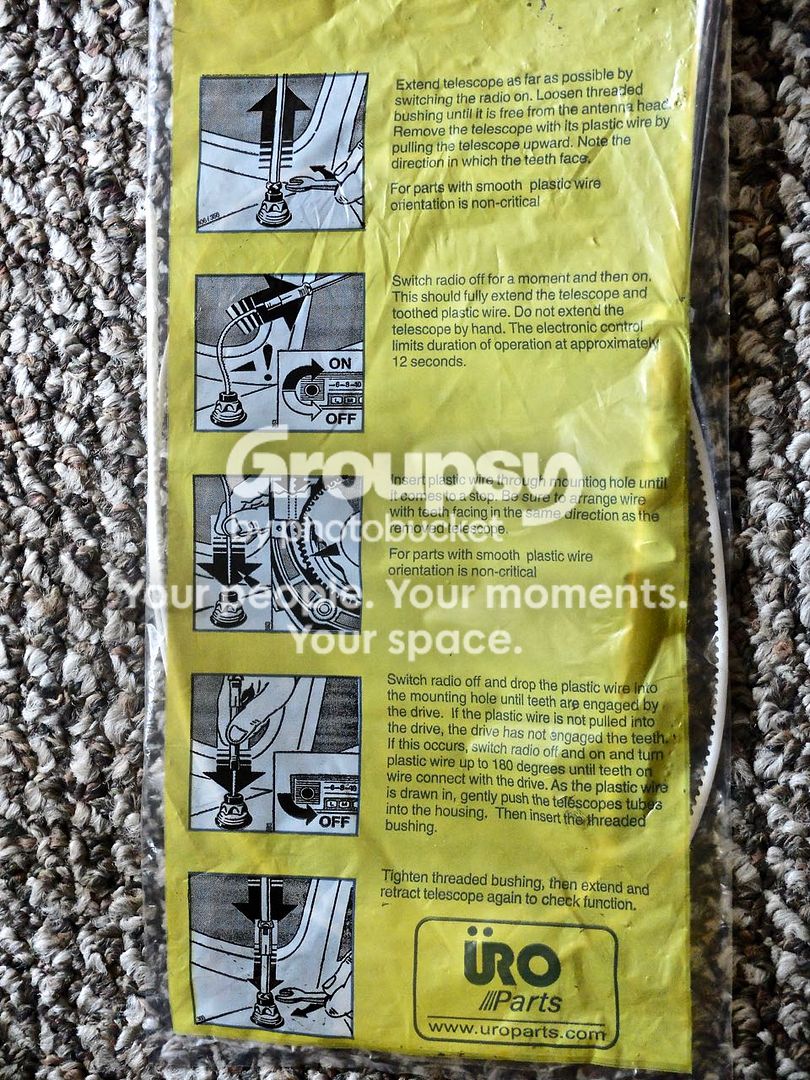

Uro antenna mast arrived today...
Nicely made for an aftermarket part, I think. Feels substantial, operates smoothly, nice instructions with diagrams. I'm thinking this was a good buy.

Yep, that's basically how the Uro instructions describe it.Mike W. wrote:Long ago now I replaced mine by just motoring it out and feeding the new one back in. YMMV.
Of course to do it this way you need a working motor/drive unit and a way to switch it on and off. I've got a working motor but will need to rig up a 12V control voltage.

Got the new mast installed. Works perfectly.
It's just as described earlier. Loosen the mast nut, then motor out the old antenna by commanding it to raise. Feed in the new antenna cable until it engages with the drive mechanism teeth. Command the antenna to lower which will cause the cable to be pulled in. Thread in the mast nut and tighten it. Raise and lower the antenna a few times so it can find its home position and you've got it.
BTW, earlier in the thread I mentioned loosening the upper grommet nut that has the two indentions. That nut does not need to be loosened for this procedure. Only the mast nut needs to be loosened which is easily done with an adjustable wrench. I know this is obvious to most of the folks around here but I'm noting it for people googling this thread in 2035.
