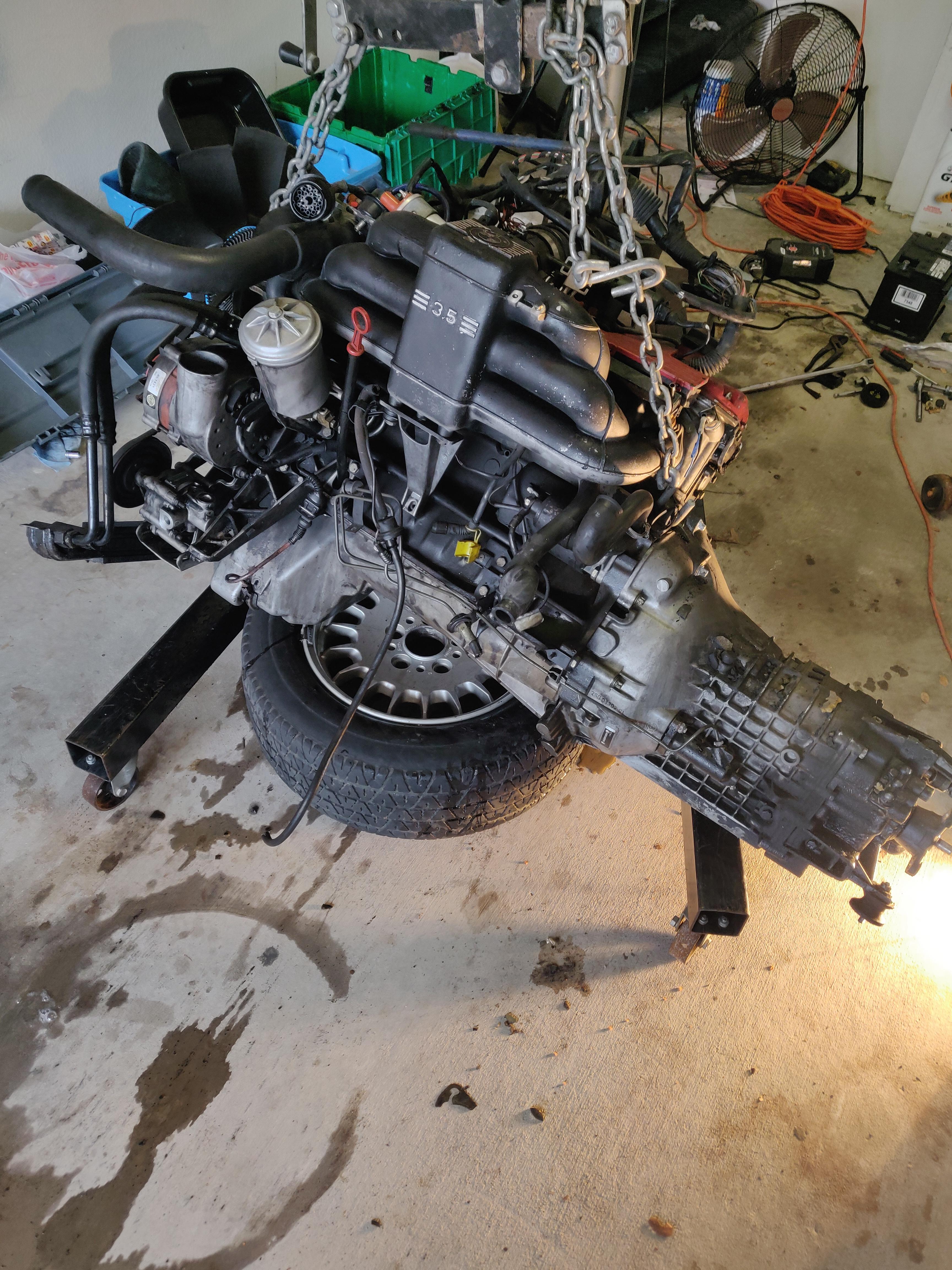

So I've got an M30B35, early style, out of an 88 e32 735i. I'll be dropping it in my e28 with the full harness from the donor car.

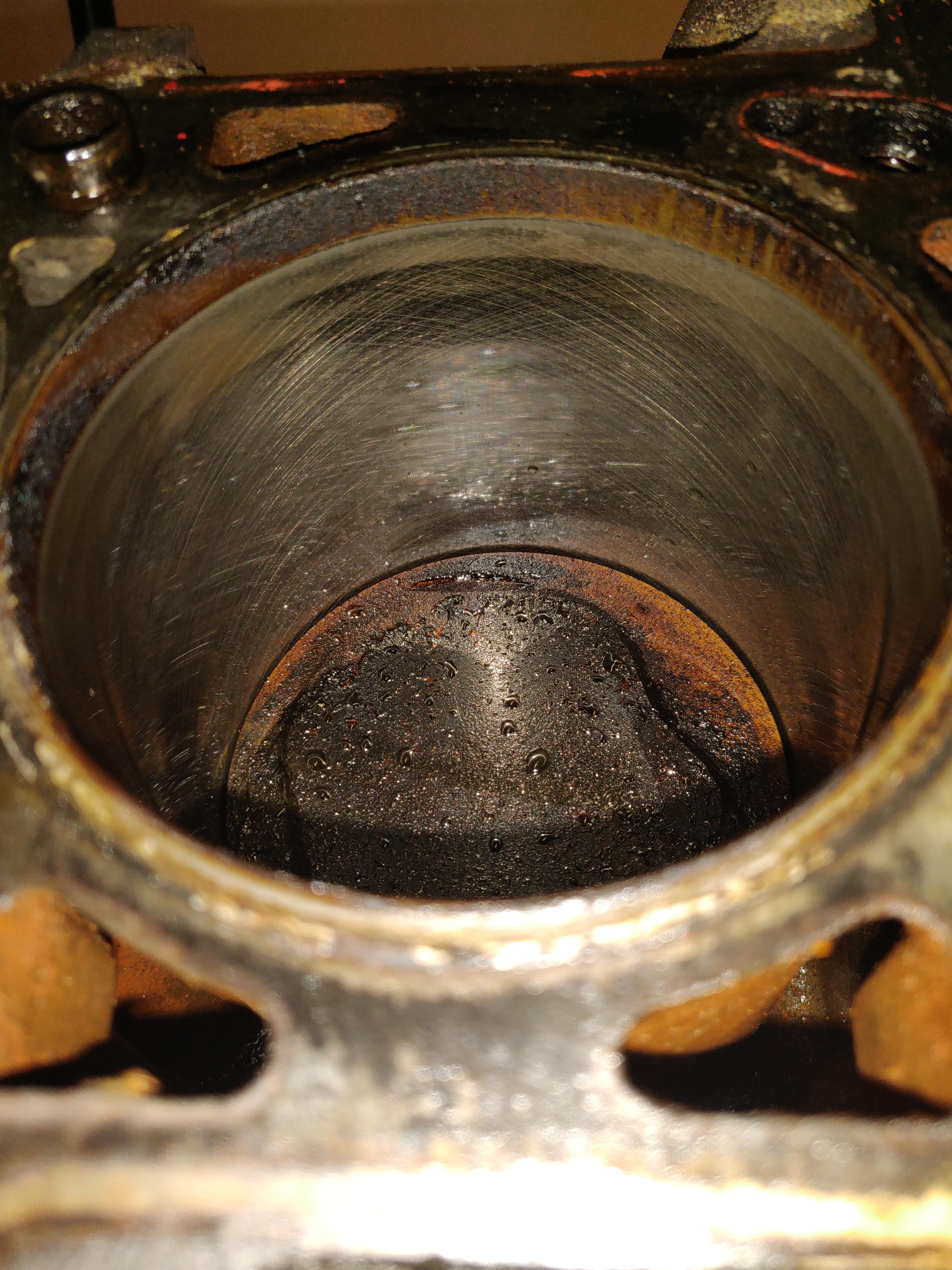

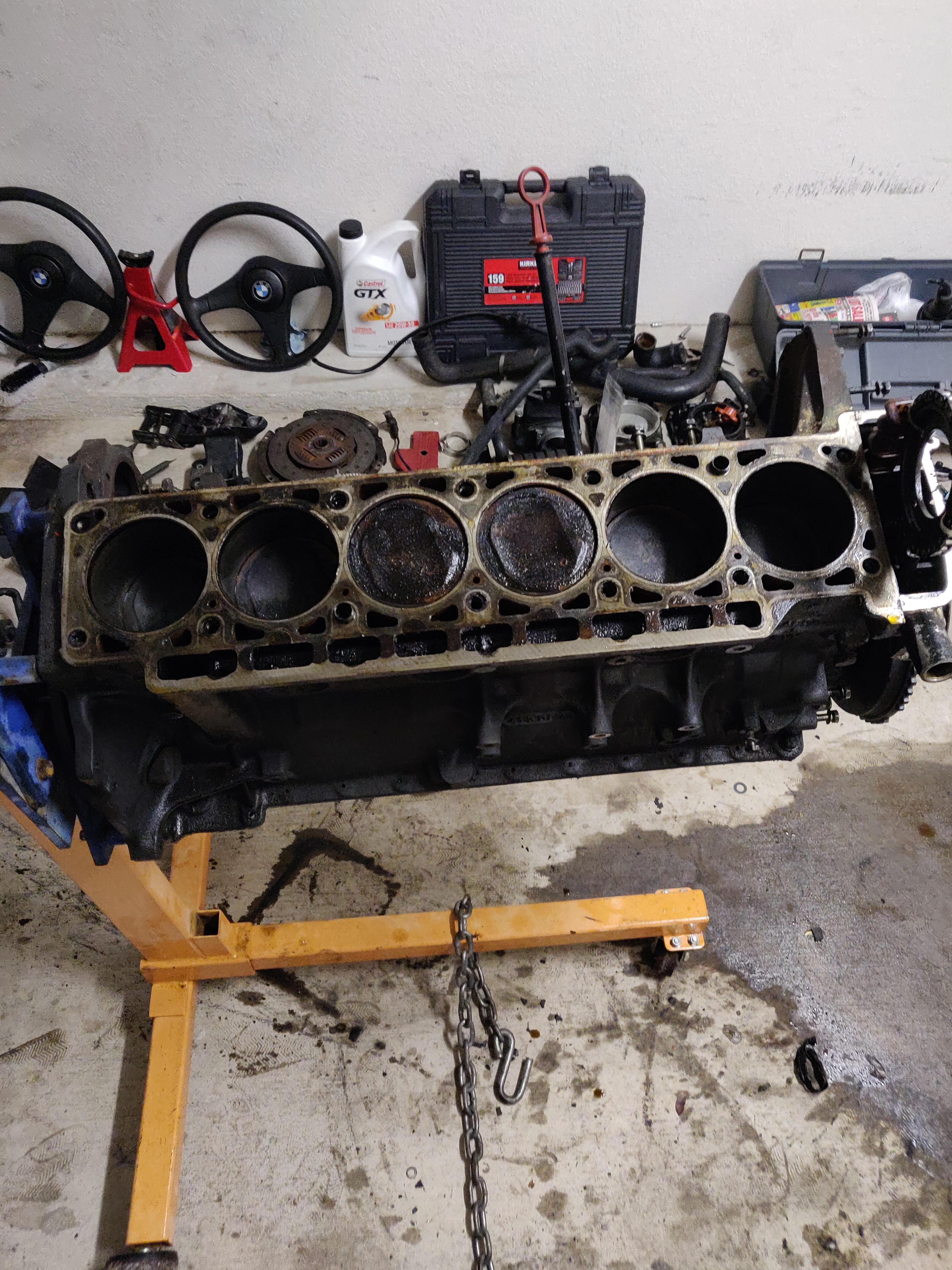

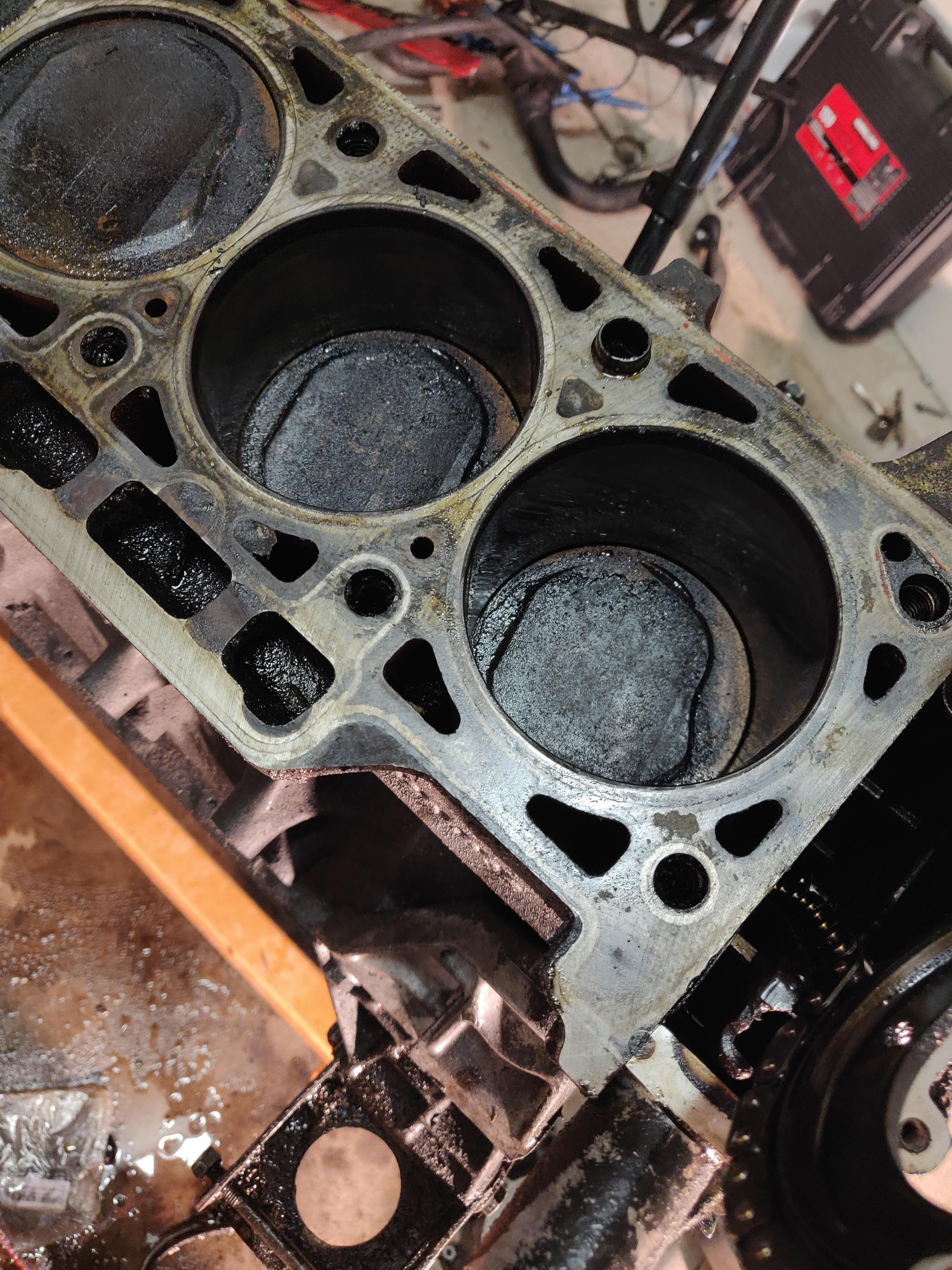

So far, I've stripped the engine to the short block, but I think I'll be leaving the crank and pistons alone as they look pretty decent. Cylinder walls still have cross hatching. My machinist buddy is decking the head and will rebuild it to OEM spec. My plans are to keep it NA for a year or two, then go for 10-15 lbs boost. I will be using an Elring (OEM) head gasket and ARPs when I put it back together.

4. I just used a high-quality gasket scraper and made sure the surface was exceedingly clean. Goofing around with a battery and sandpaper sounds like the kind of thing that could do more harm than good. Decking the block properly and doing a full rebuild of the bottom end is well and great if you have the money, but none of these are usual M30 problem areas unless the engine has been abused.

M30 blocks are pretty stable, I wouldn't even think about trying to deck it unless you throw a level on there and it rocks, which is only going to happen if it's been overheated to an absolutely absurd point. You do want it absolutely clean, I use razor blades. You're not going to hurt cast iron with a razor blade no matter how wild you might get. Getting way out there into things technical, there is actually supposed to be a certain roughness to it. Holds the head gasket in place. There's a spec for it in the BMW manuals. And the head gasket installs dry. Dry means dry, clean the block with lacquer thinner. I've seen gaskets blow due to sealants used on them which allowed the gasket to move more easily I would polish the crank either yourself with crocus cloth or by having the machinist do it. Bearings? Of course! Especially the rods.
