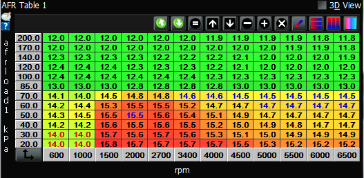

Re: E28 Megasquirt 2 Slight Misfire Issue
Here is mine in terms of general shape. With autotune, it tends to make the map less smooth so sometimes you have to go back through and and smooth out the cells.
My recent AFR targets
I run 91 octane on m30b34. Still had been working into the timing map and was probably a bit rich in the 80-100kpa region but my tuning got stalled again lately.
