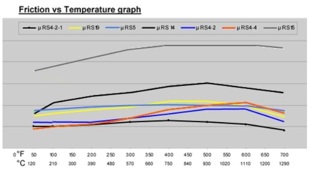

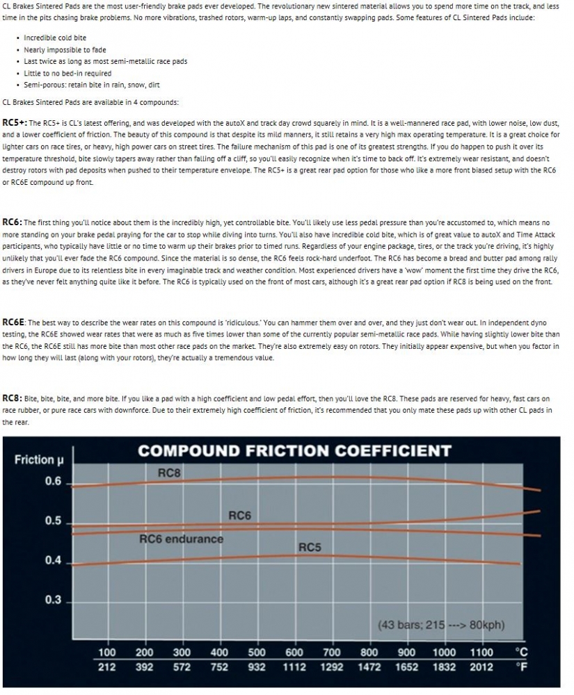

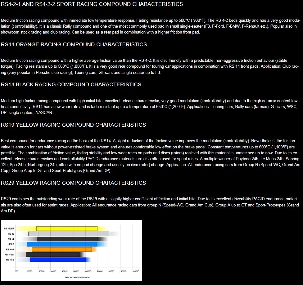

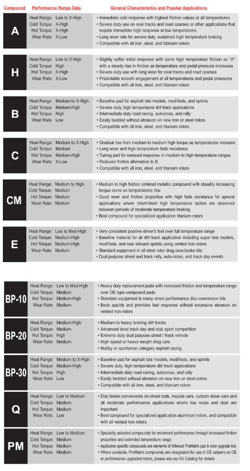

I found this online and thought it was worth sharing. I also did some digging and got images for coefficient values & descriptions from the manufacturer/distributors:
The temperature ranges and friction numbers come from the manufactures of the pads. We can not be certain the information is accurate, this is for reference only.

Wilwood
BP-10 100-1000 .42-.46 Flat torque curve, wide temperature range for street pad, quieter than the Q pad.
BP-20 100-1100 .37-.54 Medium track pad.
BP-30 100-1300 .53-.62 Track only.
BP-40 Track only.
Q 100-800 .38-.47 Good street pad. Low dust and noise.
E 0-1000 .4-.48 More aggressive street pad or light track. Harder on rotors than Q.
H (ST43) 100-1300 .54-.66 Race/track only. Very flat torque curve. high friction.
A (ST41) 200-1300 .55-.70 Race/track only. Higher max bite not as flat of a torque curve as H.

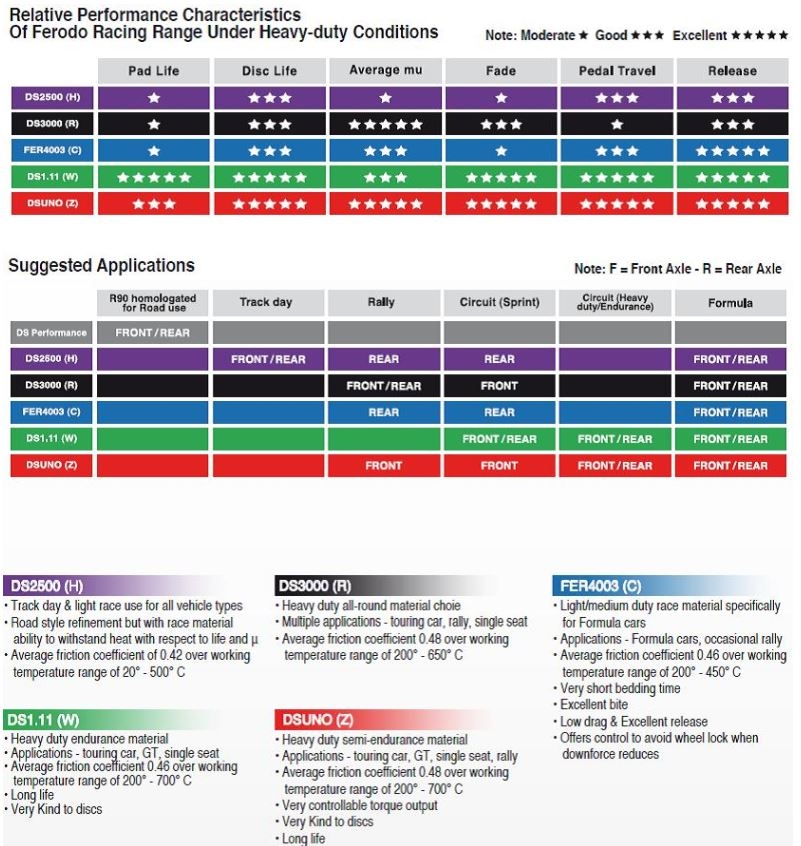

Ferodo
DS2500 70-930 .42-.50 Good autoX, street, light track. Some dust, fairly quite.
DS3000 300-1200 .4-.52 Track only.Raising torque.
DS3000+ 0.59 Track only.
DS3000 Enduro 0.5 Track only. Longer lasting and less torque than DS3000
DSUNO 300-1300 .45-.51 Easy on rotors. Replaced DS2-11.
DS1-11 46-.48 Track only. Very flat torque curve, easy on rotors. Ceramic.

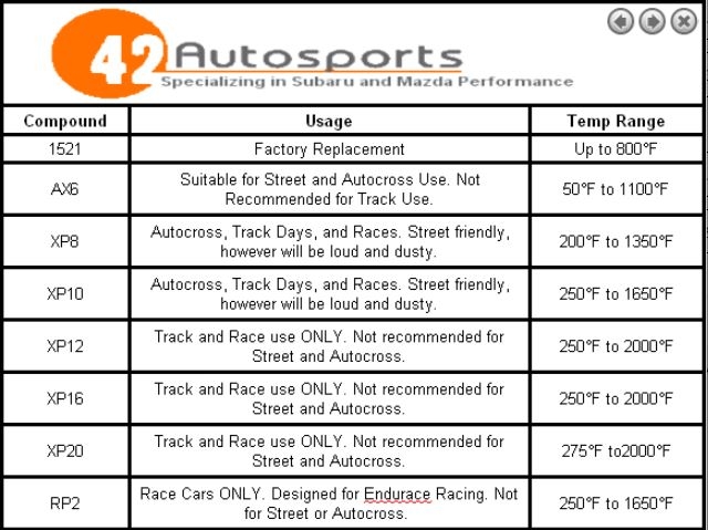

Carbotech
Bob Cat 1521 40-900 .45 Good performance street pad.
AX6 150-1250 .45-.56 AutoX, light track day, noisy for the street.
XP8 1108 250-1350 .58-.6 Race use only. Easy on rotors & paint does not mix well with other pads.
XP10 1110 250-1400 .6 Race use only. Easy on rotors & paint does. not mix well with other pads.
XP12 Race use only, Easy on rotors & paint, most bite. does not mix well with other pads.

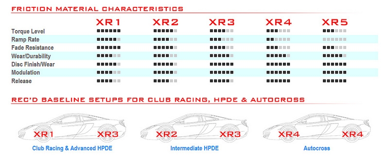

XR1 100-1600
XR2 100-1600
XR3 100-1200
XR4 50-1200
XR5 50-1000
CSR 50-1000

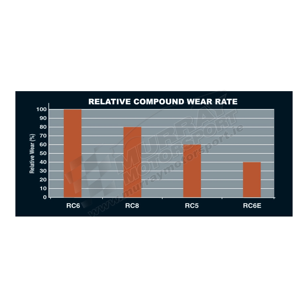

Carbone Lorraine Sintered, not supposed to require transfer layer.
RC5+ .4 Noisy for street use, autoX, track day.
RC6 0.48 Good cold bike, flat torque curve
RC6E Endurance .5 Endurance version of RC6
RC8 .6 Good cold bite, most bite. flat torque curve

Pagid
Black RS4-2-1 -1000 .35-.45
Blue RS 4-2 -1100 .40-.46
Orange RS4-4 -1250 .39-.49
Yellow
Grey RS15 -1600 .50-.62

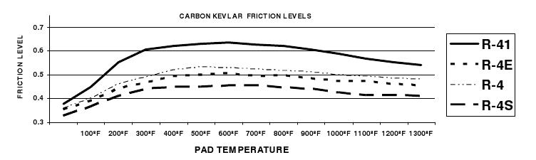

Porterfield
R4-S -900 .4 High performance street & autoX, low dust and noise.
R4 450+ .5 Track only, Carbon Kevlar.
R4-E Track only, Endurance version of R4.
R4-1 -800 .56-.6 AutoX, vintage/light race car use.

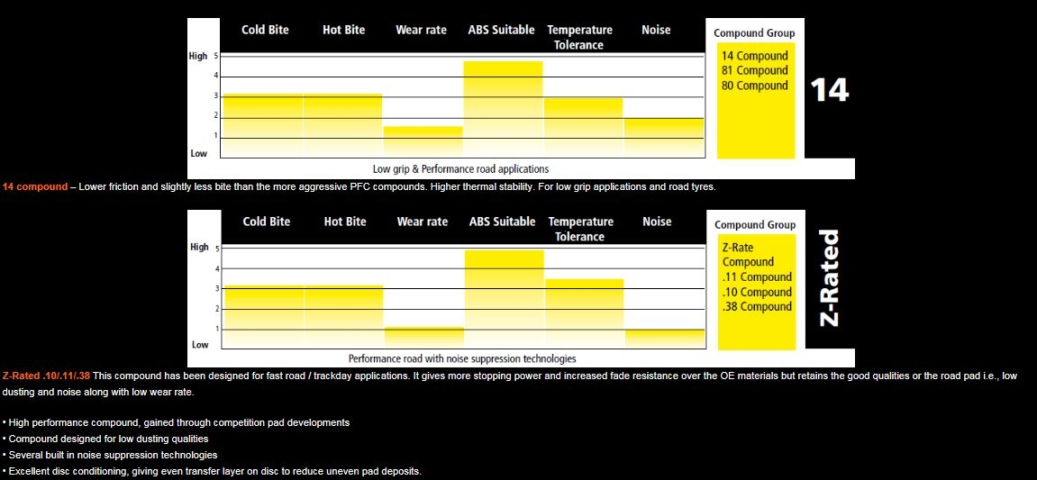

Performance Friction
Z-Rated 100-1000 Street, autoX, light track day pad, non-corrosive, easy on the rotors. Some noise when cold or light braking
14 Compound New- Less bite for better control in lower traction situations (street tires, loose track…) Track only.
13 Compound New- Highest bite PFC pad. Track only.
12 Compound New-Track only endurance racing pad.
11 Compound New- Replaces 01. Track only.
06 Compound Track pad. easy on rotors & paint. Similar to 01 but longer lasting and slightly less bite.
01 Compound Track only, very popular easy on rotors, high initial bite.
97 Compound Track only, endurance racing. Replaced by 08
93 Compound Track only.
90 Compound Track only, popular with racing schools. Higher cold bite than most
83 Compound Track only.
80 Compound Track only.

You ran PF CM pads, are they on the diagrams?
