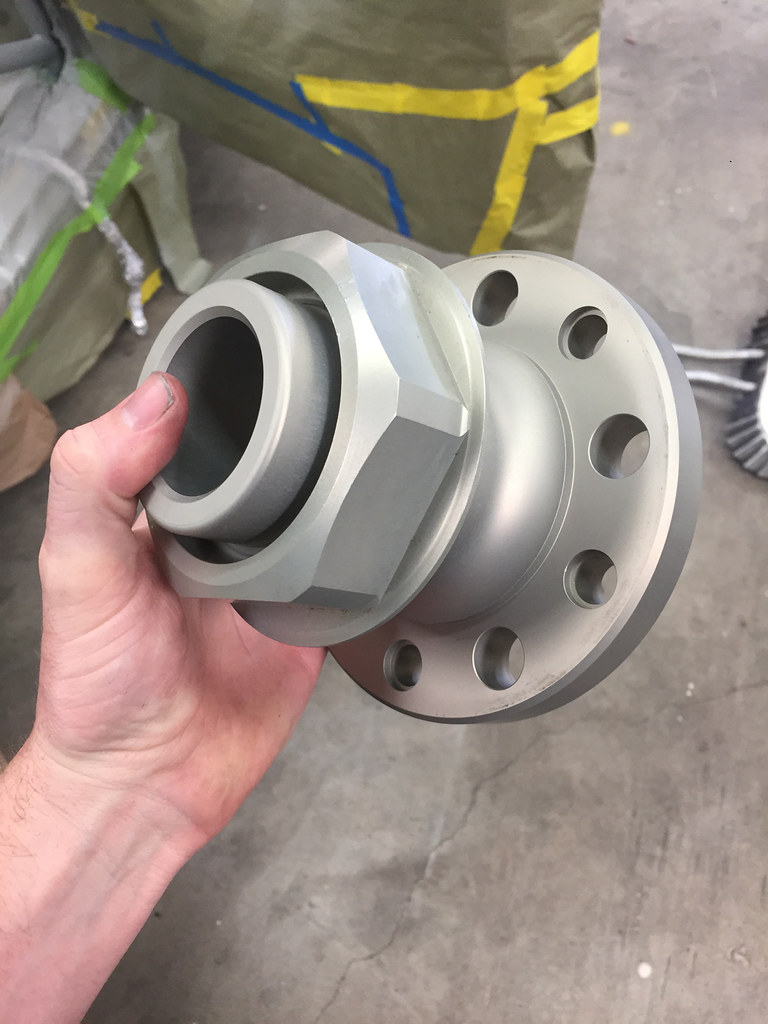

Custom 7075 alloy Centerlock hub adapters, Steel drive pins, built to Gr. A E28 spec

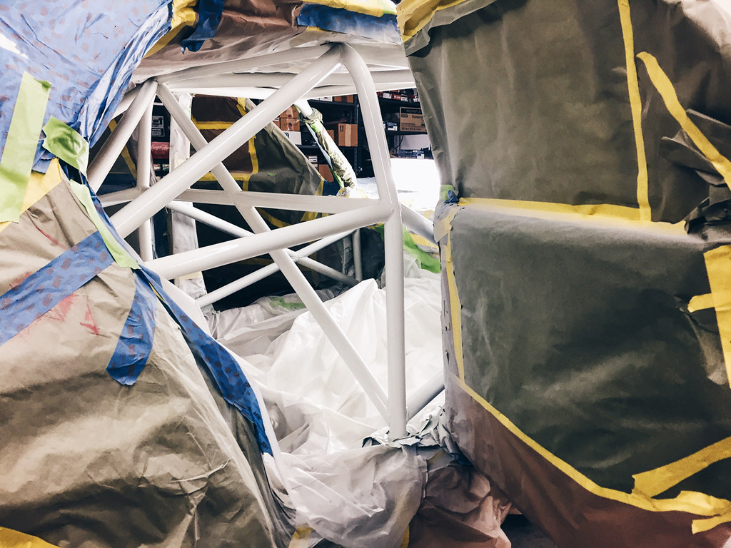

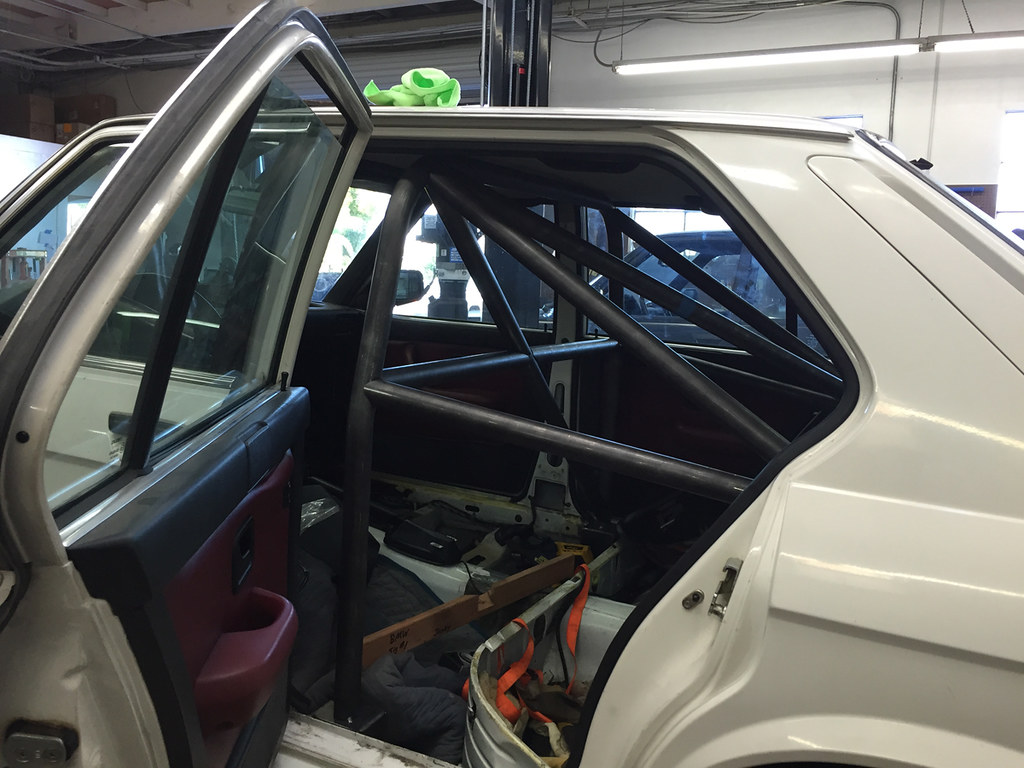

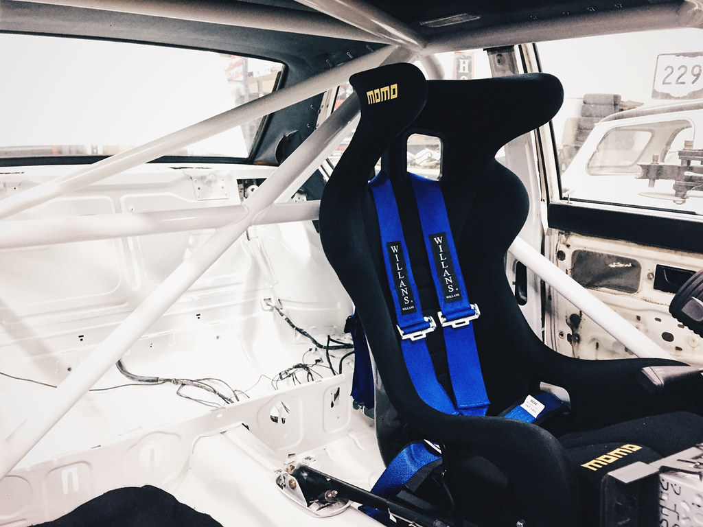

NASA legal, 1985 FIA Group A-spec 6-point Roll cage, 1.75” .120 DOM
Pair of Momo Daytona fixed back seats, FIA compliant til 2020
VAC machined seat mounts
Pair of Willains 6-point harnesses, FIA compliant til 2020

Stripped and fully painted interior

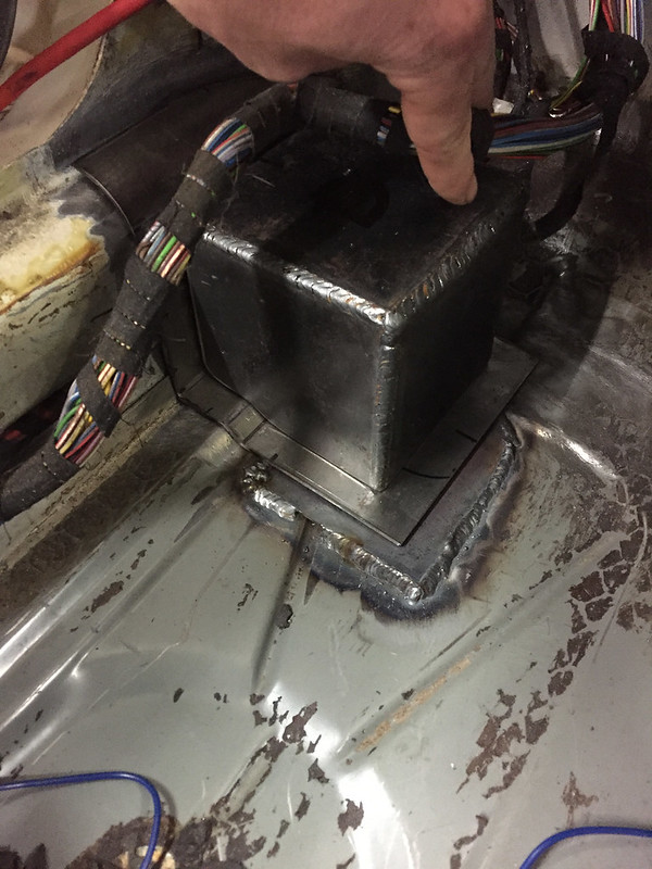

Fueling:
ATL 120-liter Aluminum fuel cell, 1982 GR. A touring spec
3-liter fuel swirl pot/surge tank
Bosch 044 inline fuel pump
Holley Red lift pump

More details would be great, especially of the interior and cage. My personal favorite of the '82 Group A cars is this one

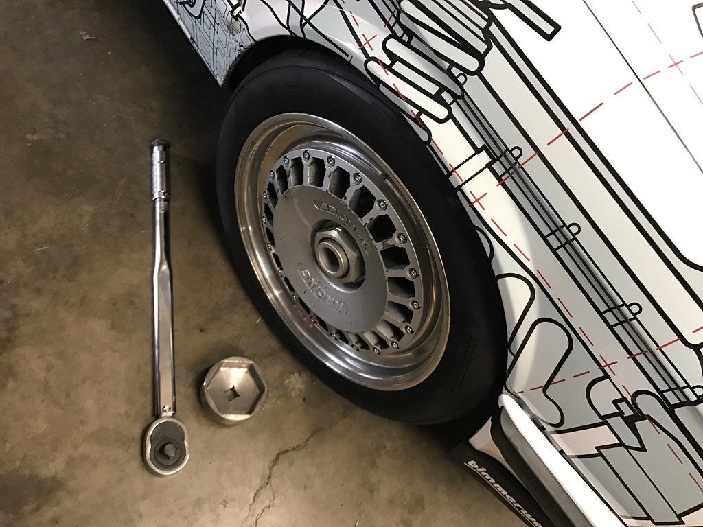

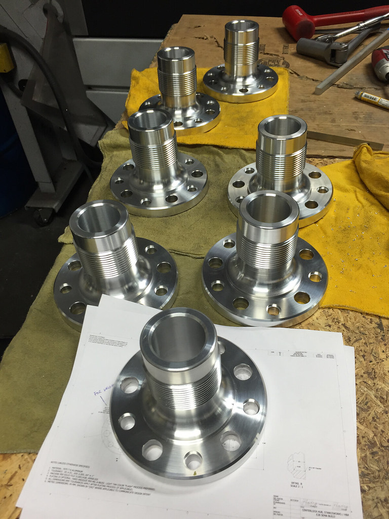

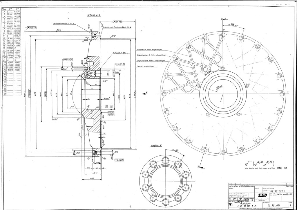

The wheels are probably my favorite part of the build, and might be the most important part. In wanting to build a spiritual “sister car” to the E24s, it was important to use the correct wheel. I found these Ronal splits, off of a Group A car, a few years back, I believe in 2012, and have been sitting on them ever since. They’re a spot-on match for the E24s, and as run on some of the E28s as well.
Using a few reference materials, primarily homologation papers for one of the Gr. A E28s, and an old rear hub I happened to have here at the shop, I joined forces with one of my closest friends, Nic Foster, to build a set of centerlock hubs for the E28. Pictured below is the original hub I had, which I sent to Nic up in Seattle, so that we could replicate it.
The factory E28 race cars are setup slightly different to our road cars, as their strut-to-spindle attachment is a a bit different from the road cars as it’s a BMW Motorsport coilover. However, it does utilize the factory geometry and the stock steering arm, so it’s practical difference is, well, none. You will note, however, that the hub assembly is almost identical. We used my spare factory centerlock hub for measurements and dimensions for both the hub and the drive pins. Pictured below are two photos from the E28 FIA homologation papers - the motorsport strut assembly, and the centerlock unit.
For our hub, we did add some lightening holes (as also used on the original hub I own, but not as seen on the Gr. A E28s in the pic above), however, they do use the drive pins to affix to the car - they’re not a dual-bolt style “adapter”. It’s as close to the factory centerlock hubs as we could venture.
We produced the parts with a 7000-series alloy and FEA testing shows the load capabilites well past 4x the German TUV minimum safety rating, so this is a true race-capable part. A crows foot and torque wrench is used to install them to the car via the drive pins.
Ronals were built, back in the day, to BBS dimensions and to utilize BBS hardware. BBS supplied me with NOS centerlock nuts, as well as the original ’83 CAD drawings so we could perfect our hub and mate them perfectly.
For the wheel build, I simply rebuilt them to factory spec with new BBS inners, outers, bolts, nuts, and sealing rings. I left the wheel centers as-is, opting to not refinish them in favor of retaining the patina and as-raced marring and imperfections.
All of the components fit together perfectly, and I was eager to see them on a car. At the time, the white car had no subframes, so mockup there wasn't an option. Here’s a few photos of initial test-fit on my M5 of all of the components. Sorry for the rusty surfaces - it’s been sitting since ’94, and is on my list of builds to do. Seeing them on an E28 had me excited and eager to finish up the suspension build on the race car.
And the original, for comparison:
Wheels on!
Mounting them on the race car was pretty straight forward, as per above. Torquing the wheels down required me having to have a custom 90mm socket made. While you can buy one ($1200 from SnapOn for the one socket, $400 for the cheapest out there), it was cheaper to have one made. The nuts are torqued to 400lb-ft.

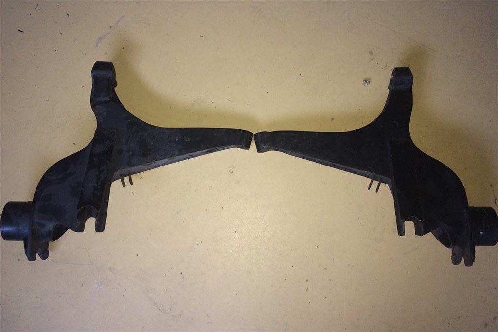

This is some good turkey. Could you show the pics of the rear trailing arms from the group A cars? I've never seen them.
I'm glad you're enjoying the tidbits and details. I worked really hard to get some of the details right on my car. She's far from perfect, but I'm happy with it, for the most part. The rest will come with time.
Here's some reference photos of the RTAs. The first photo is from the homologation papers. The second is an unmounted set so you can see them more easily. They mount similarly to the factory RTAs. The inner mount's orientation looks odd, but it mounts with a forward-facing heim/rose joint.

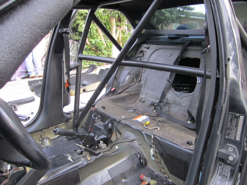

I've really grown to enjoy the ins and outs of roll cage and chassis design, and while I am very far from a pro, I'm happy with the outcome on the E28. It's one of the places I took some creative liberties from the original Group A cars, all in the name of safety. The Eggenberger E28s all ran bolt-in roll cages, and while they can be safe, I prefer something that is safe. However, I did source a copy of the 1985 FIA Group A rulebook, and built the cage to spec, preserving some sense of authenticity.
Inarguably, the most important aspect of cage design is strength and integrity, and while there's an immense amount of wonderful rollcage fabrication out there (and all far better than mine, no doubt), it's the place I see skimped out on most often as I peruse threads and facebook groups. More often than not, "cage builders" seem to skip building proper nodes - where tubes meet - in favor of quicker fabrication. Is it safe? Yeah, probably. But is it right? No, not by my book at least. It doesn't mean you or your cage is wrong, it's just not how I like to work.
An example of what I'm talking about (seen on an E36 sedan, from google images). None of the tubes "intersect." The door bar is below the belt bar, the diagonal misses the rear braces, etc, as does the a-pillar bar. Each of these tubes dead-ends into another perpendicular tube.
You'll see none of the tubes actually meet each other. It's quicker to build this way, but it provides poor load paths in the event of an accident. It also doesn't look very nice. The photo below is one of the few reference photos I have of the actual E28 Group A roll cage - bolted together, and also not incredibly well designed.
You can see in this picture, of my cage, a general idea of my layout and noding. Every tube meets another, "noding" correctly. Again, it may not be important to others, but it was to me, so I spent a lot of time getting it right.

For my roll cage, I opted to build atop plinth boxes, which are a bit stronger than attaching directly to the floor, and they allow the cage to be dropped away from the roof for final welding. Here's a bit of before and after for a front and rear plinth box.
Here's one in place - this one's on the driver's rear. All four plinth boxes are slightly different due to asymmetry in the floor pan. For the finished cage, there is a base plate to each plinth box - it is not welded directly to the floor. This was just mockup purposes. You can also see the adhesive I was dealing with. It covered every inch of the interior. It haunts me to this day.
More adhesive. In some instances and places in the car, it was a few milimeters thick. We had to remove ALL of it to ensure a good finish on the floor pan.
Here's the front two plinth boxes (and base plates) mocked into position. I'm no pro welder, so affixing my base plate material to the floor, effecitvely, was hard. Strong? Yes. Pretty? Eh, not so much. Sorry, professionals out there.

My position for the rear bars is a bit atypical. Normally, E28 cages head straight to the wheel well arch, forward of the strut tower. It's very easy to access and mount to, and it's very strong. I wanted to attach directly to the strut tower, and thus had to remove a sement of the rear bulkhead on each side. The sheet metal is in the way, normally. On the to-do list, to this day, is to rivet in some nice aluminum covers to seal it back off. It's the only part of the car I feel is "unfinished" in its current state.
My good friend Riley Stair joined in for the weekend to help knock out the cage, since my SEMA clock was ticking.
Following the cage build, and a WHOLE lot more interior cleanup, we were finally ready to prep and paint the interior of the car. A few of us did prep work, but it was my good friend Cory Hutchison that did the paintwork itself, and the outcome is honestly better than I ever expected. Masking took an impressively long time, with lots of paper, tape, and foil used to keep everything clean. We had to paint in stages, masking the floor off first to paint the cage, and then the cage to paint the floor, all in an effort to prevent overspray problems and to ensure a factory-like finish.

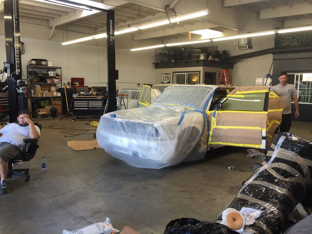

Here you can see the cage dropped down, so that the top could be painted. This was another reason for painting the floor separately - I had to lift the cage back into place, and weld it up.
Here's where things finally started to come together. Also in the mix was dying the headliner to black, to keep things true to the "M5" theme. I also, after everything was said and done, took the time to re-wrap the whole harness with black cloth tape, to clean up the inside of the car.
And a few final photos:
