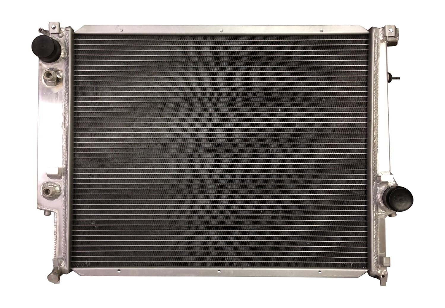

Re: 535i vs 524 td cooling capacity
If you are talking all aluminum E36 radiators you can get them stupid cheap. Not the 3 core like Slammin' is talking about, but still all aluminum would be sexy. Hoses are in about the right places for a M30 and I think the right size. Only 1 fitting for a fan switch so you would have to use a later double switch, but that's not hard.
Mounting would also be custom, but not difficult I wouldn't think.
http://www.amazon.com/gp/product/B00F0D ... 2GEV17YXFH
