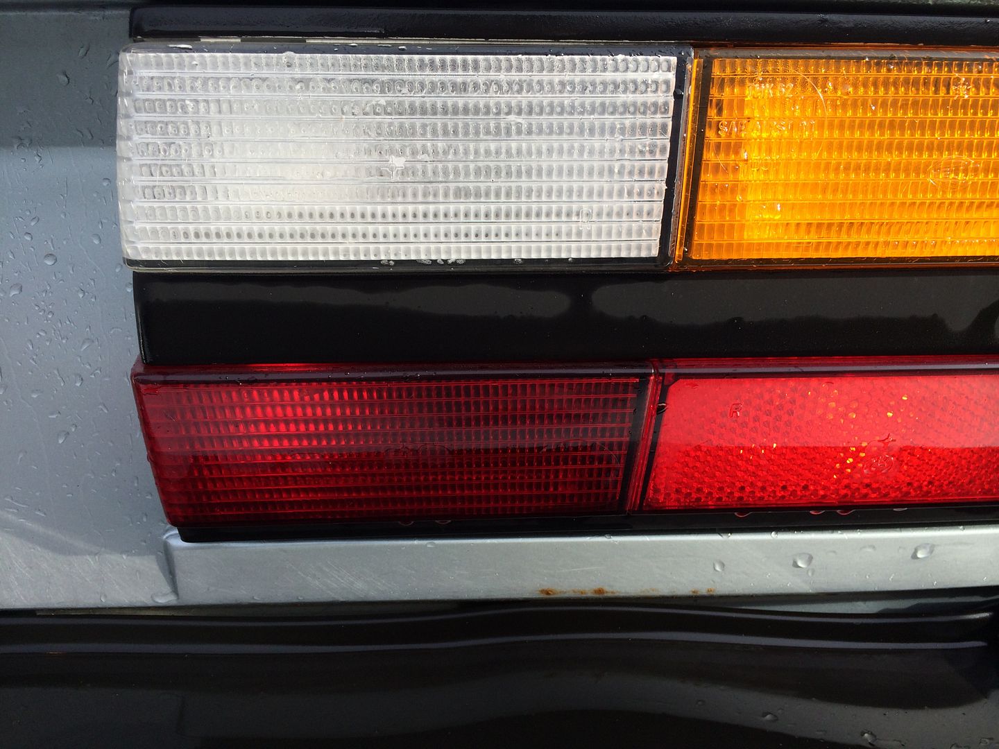

I plasti-dipped my tails 3 years ago. Driven the car about 25k miles since then in all of the Canadian seasons.Blue Shadow wrote:glossy tails...???
Crest is the best satin black spray paint. Other brands are ok.
Plastidip? I seen it talked about but not the result a year later
Taken the car through countless touchless and even 1 of the spinny brush-rags car washes, brush the snow off (whenever it arrives) and even classily clean them with the gas station squeegee if they're dirty and it's raining out.
Aaaaaand the plasti-dip still looks as good as it did the first day I put it on. I put it on thick though.
I can get pictures for you on Tuesday if you like.

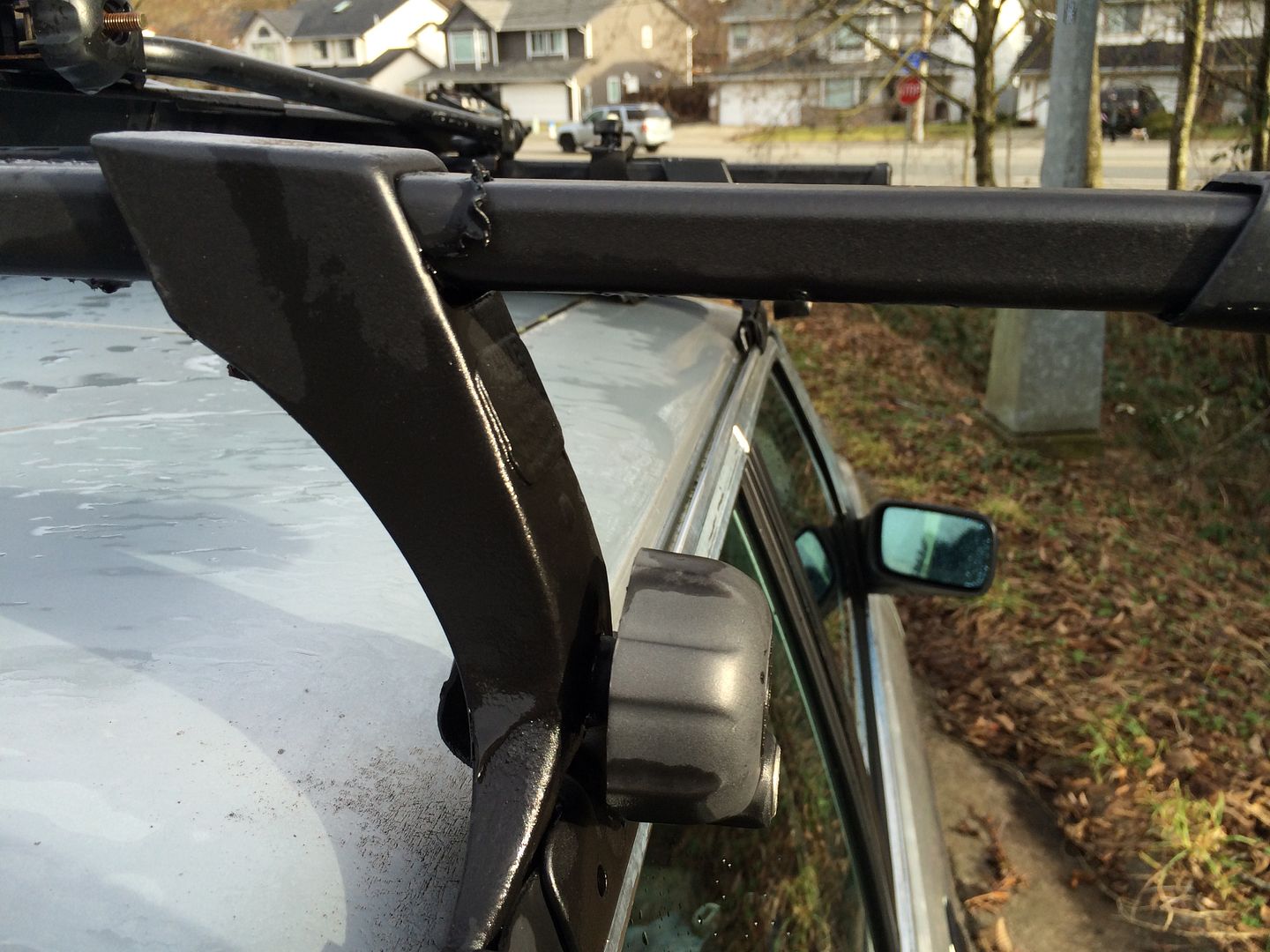

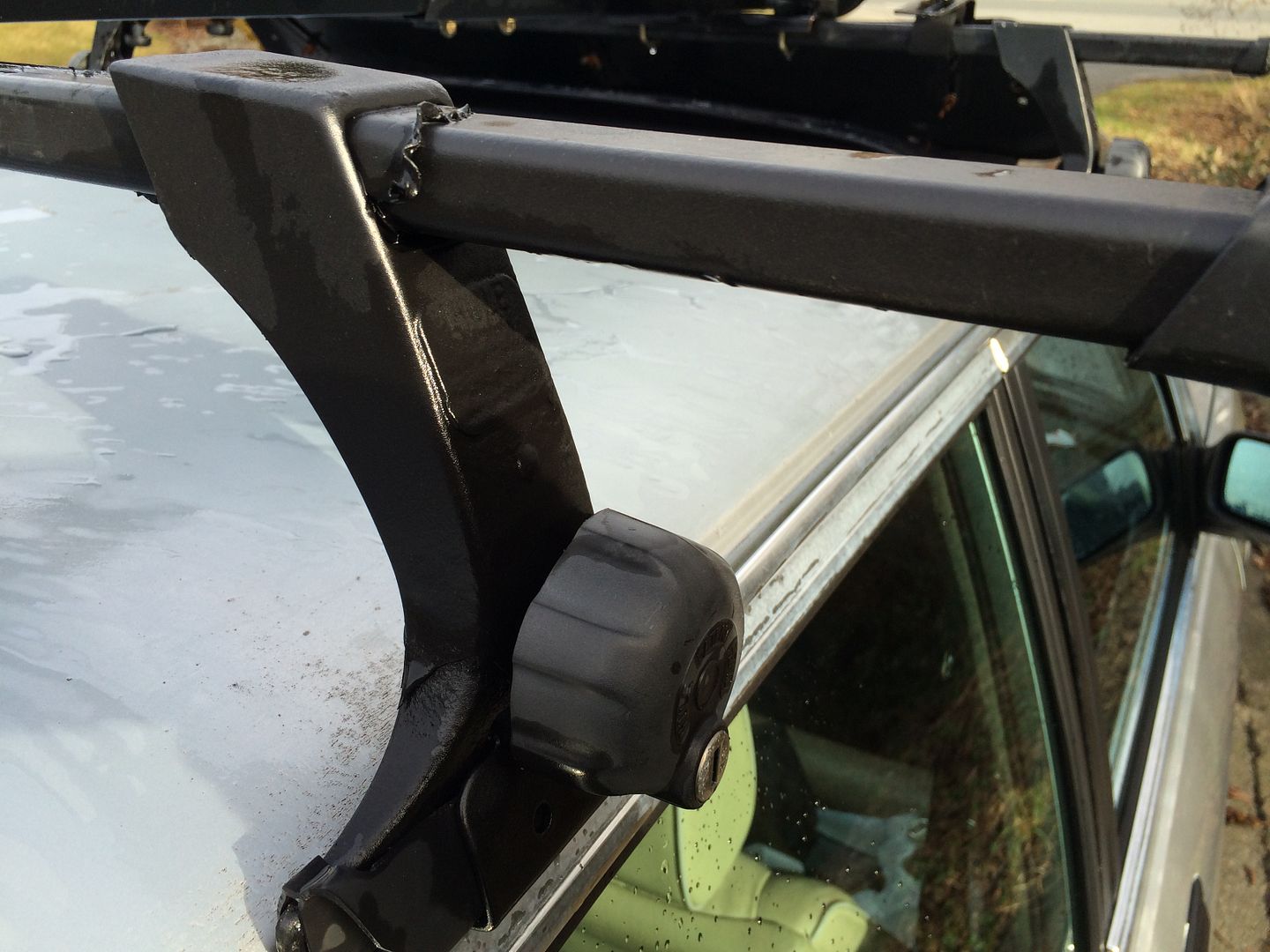

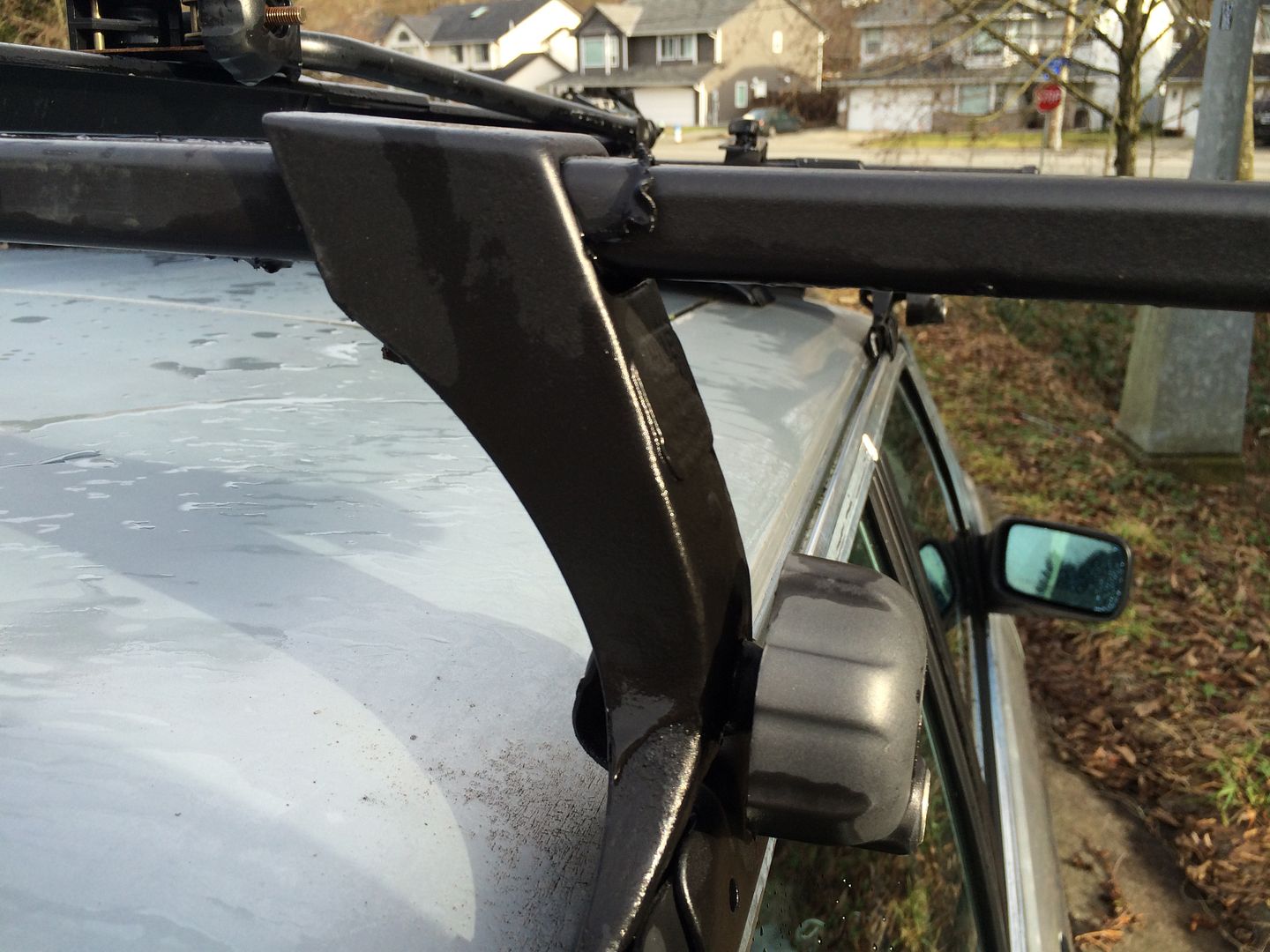

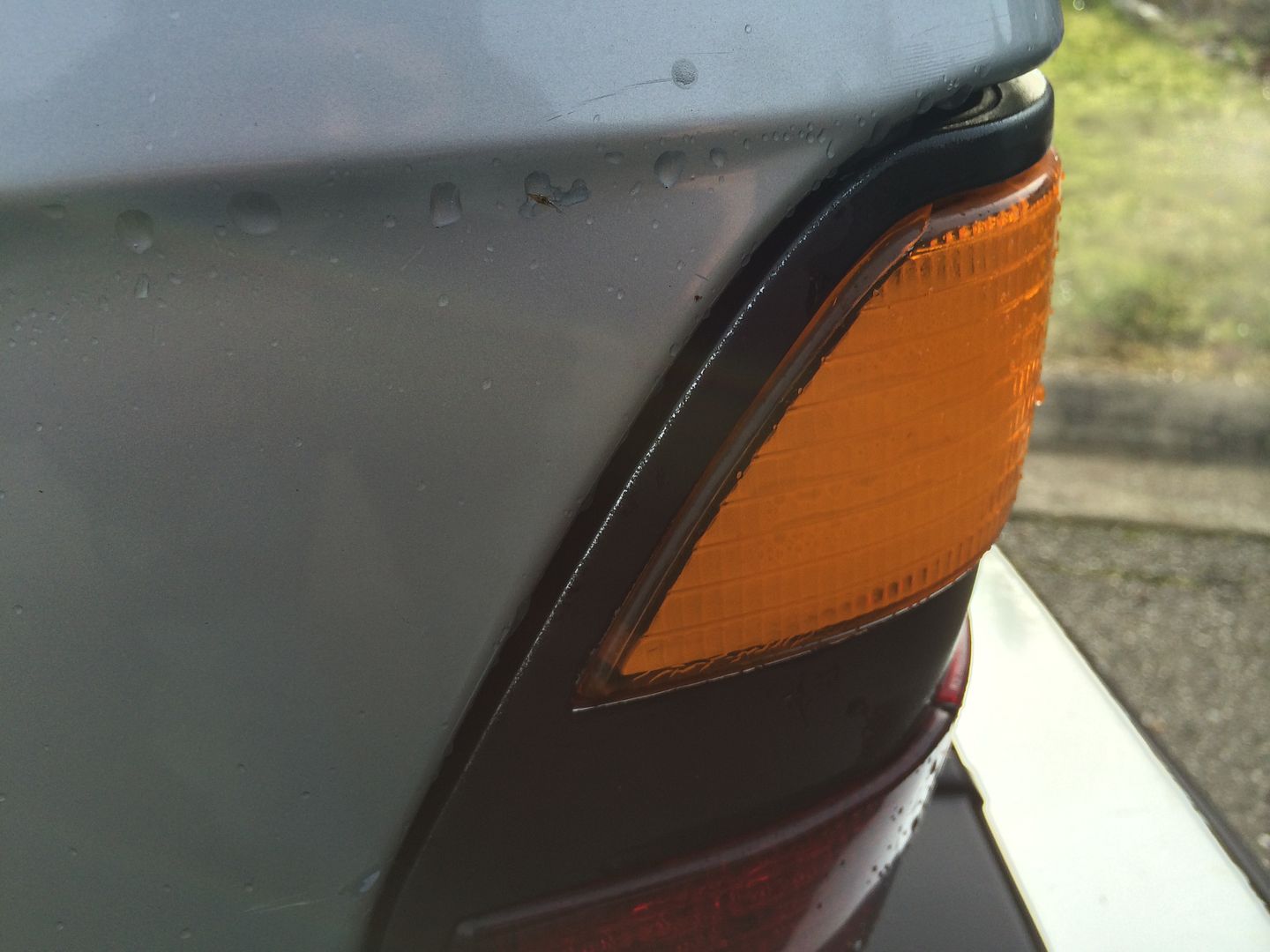

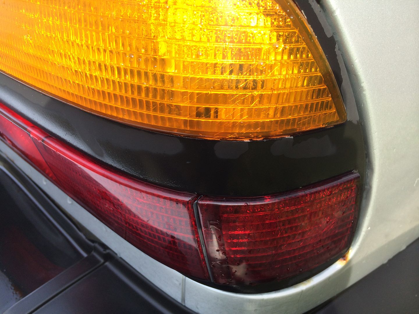

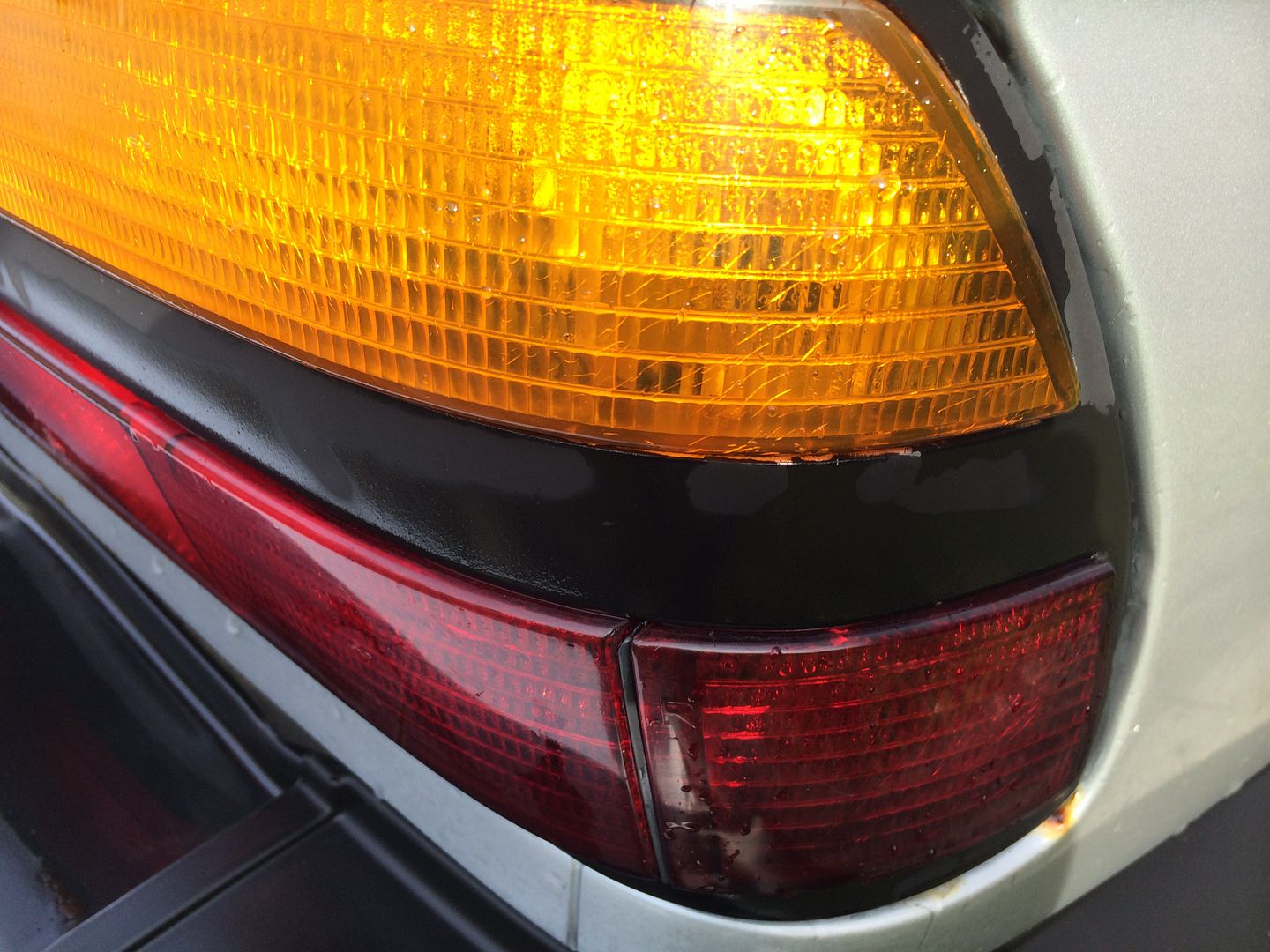

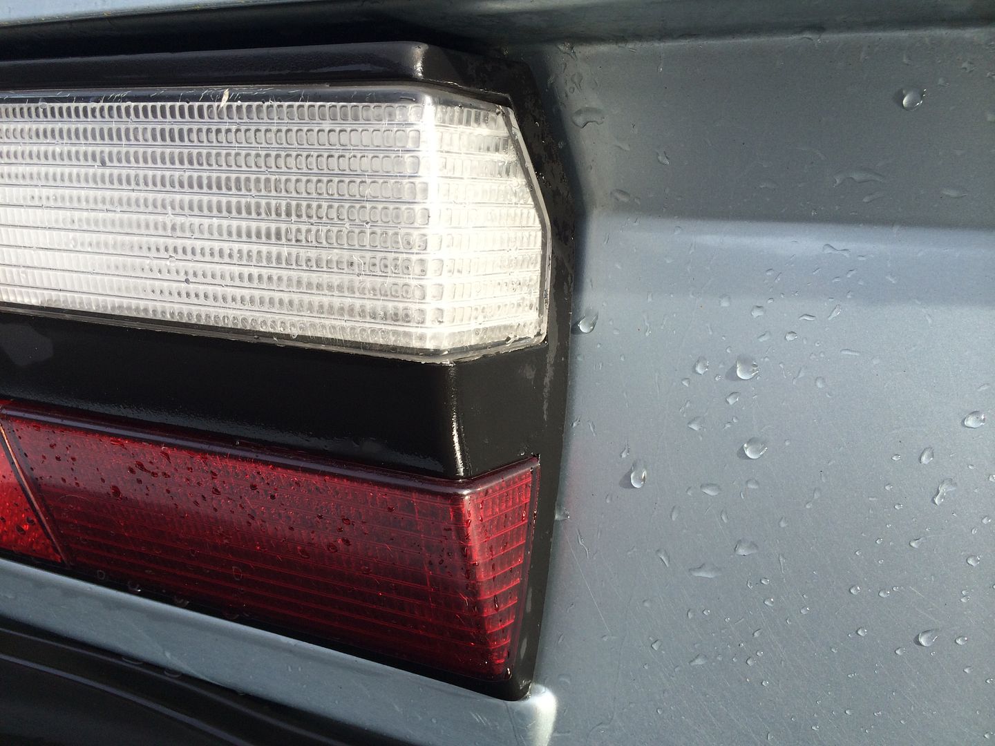

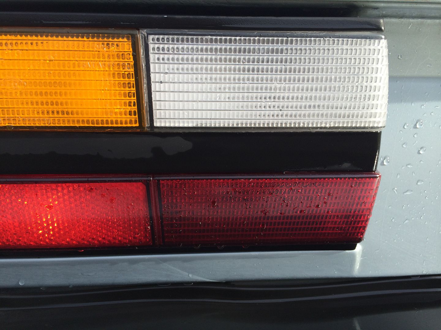

I thought I was off on Tuesday but I had my work schedule mixed up.
I took some shots of the lights today after a car wash. Tried to get some detailed one, as requested. The only wear I could really see was on some of the sharper edges that I didn't get it on as thick but still.. in my opinion, it looks pretty good for 4 years old.
I also took some shots of my roof rack and mounting arm. Both are plasti-dipped as of last year.
This car is always parked outside and driven all year round.
PS: Plasti-dip sells a top coat product called glossifier that can make it look.. you guessed it glossy-er.
