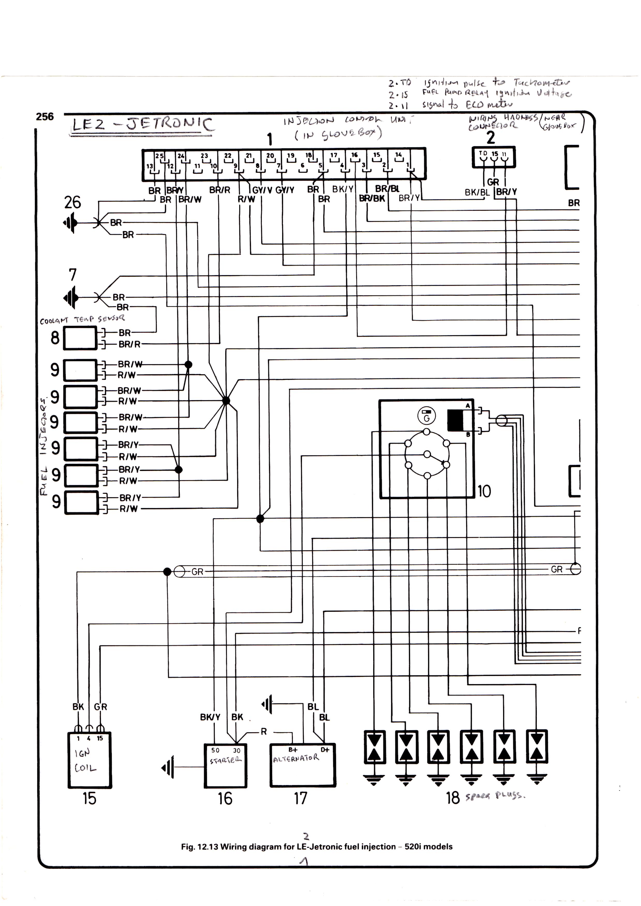

Heres the LE2-Jetronic wiring diagram. 8 is the coolant sensor and 1 to ecu.
To answer your original question. Yes you can unscrew the sensor without losing to much coolant if you are quick. It can be a bit fiddly.
