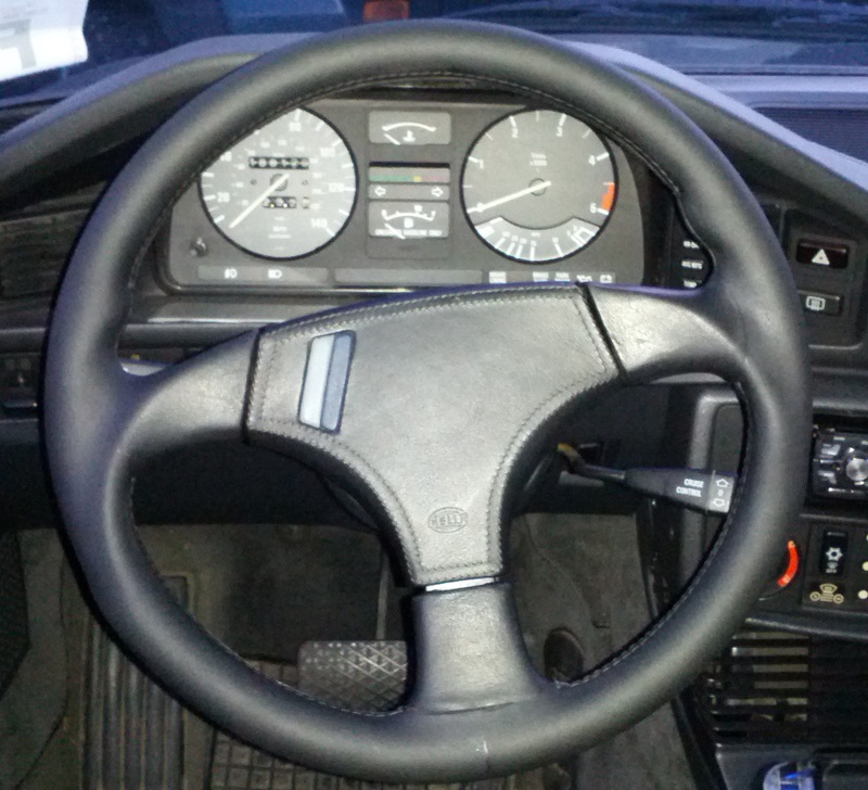

Thanks guys, I'll look into those. I had to pop out on an errand and remembered to grab a shot of the wheel. If anybody knows definitively what wheel this is or what's it's from, let me know.

I'm not a big Leatherique fan, but I have used their black dye on steering wheels with good results. It's a little soft and gummy for a while, but looks good and is protective. The worst thing seems to be when the dye wears off and it's down to bare leather, it wears quickly and right on thru.

I'm guessing that's what the "Klear Kote" is meant to prevent. I do like the Leatherique products. They're a little problematic if the finish is compromised in any way though.

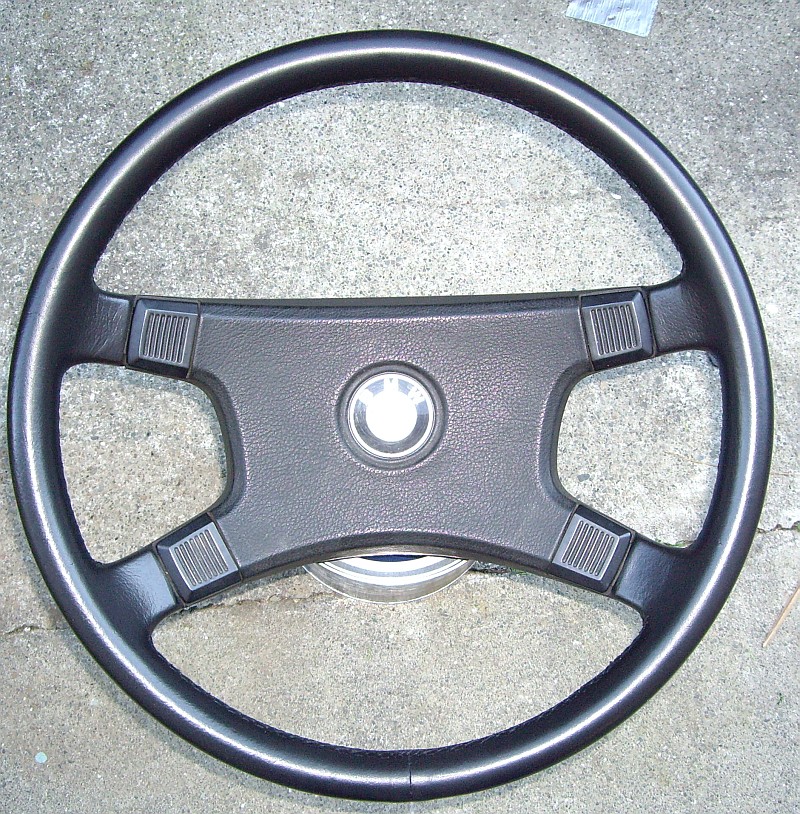

Re: Leather finish on steering wheels
A little shiny, but still. Leatherique dye.
