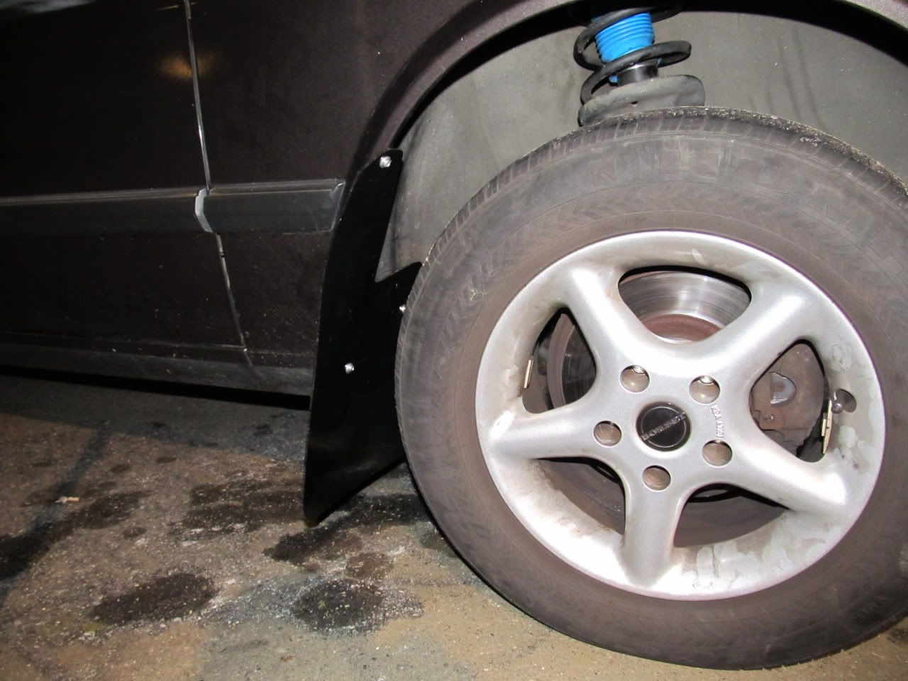

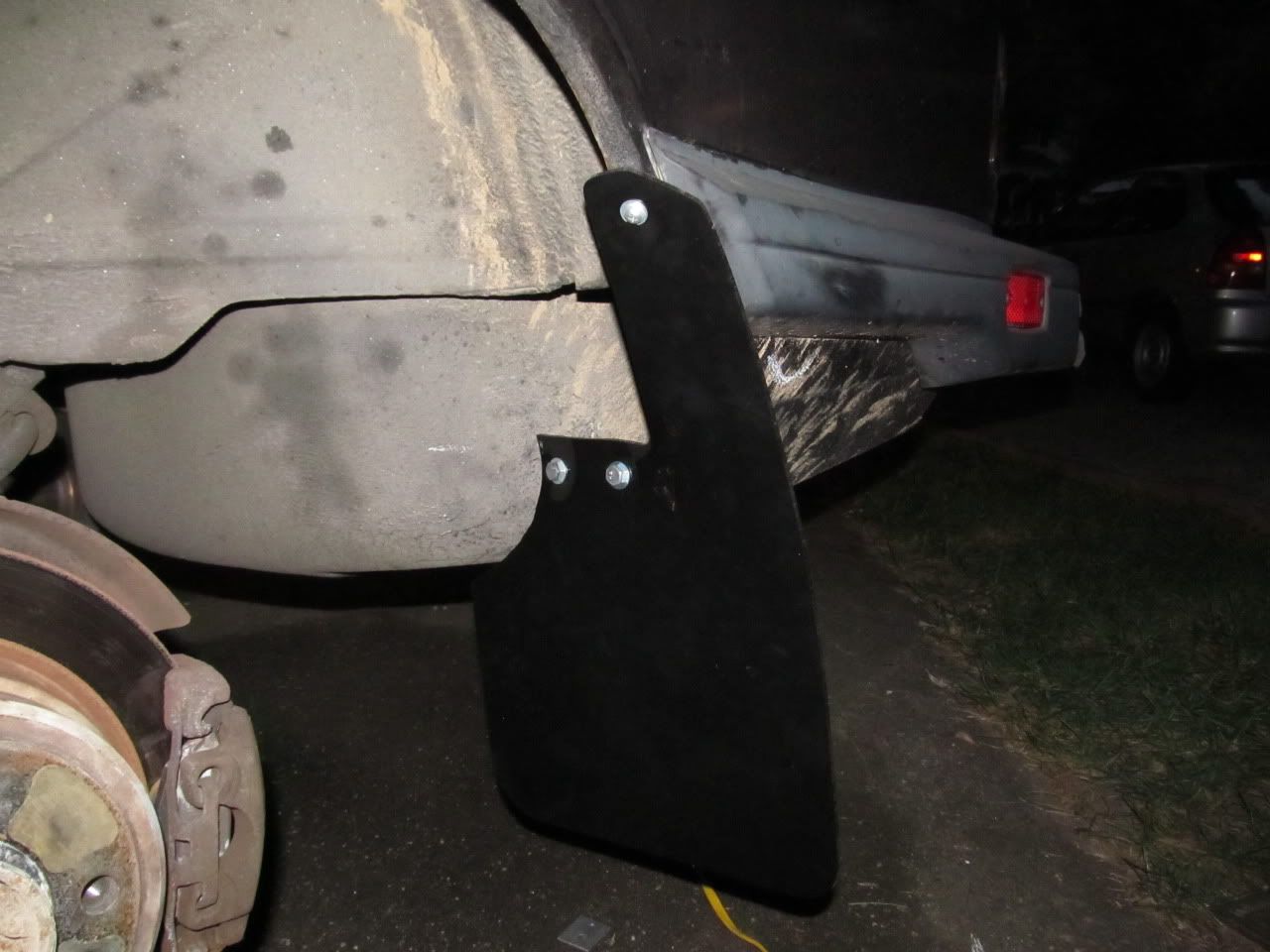

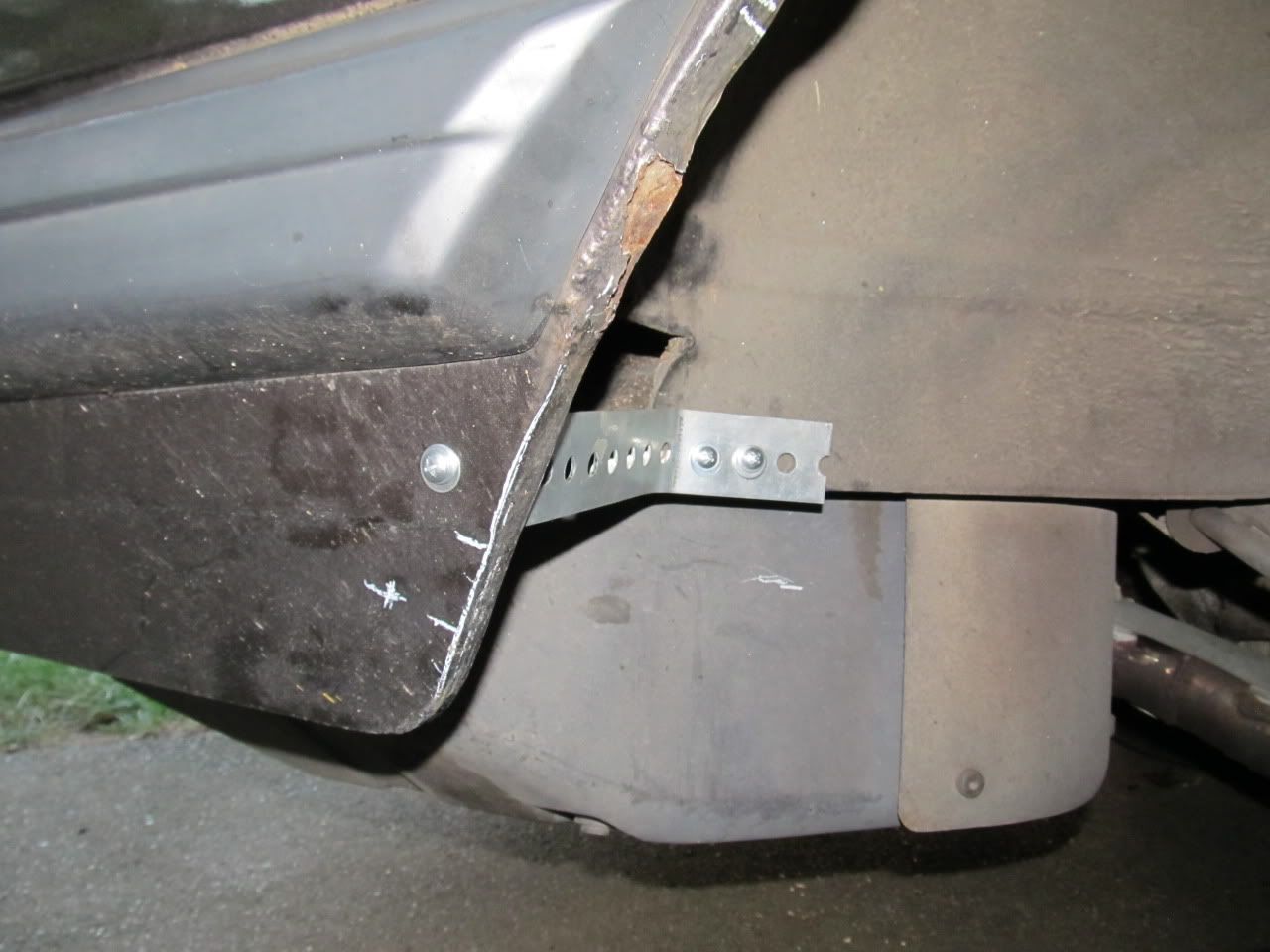

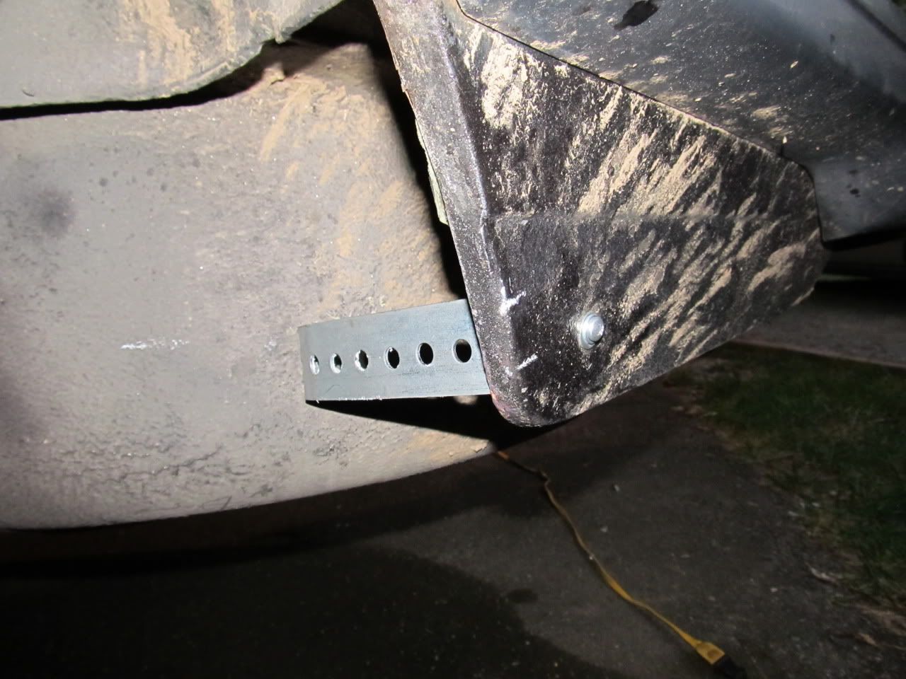

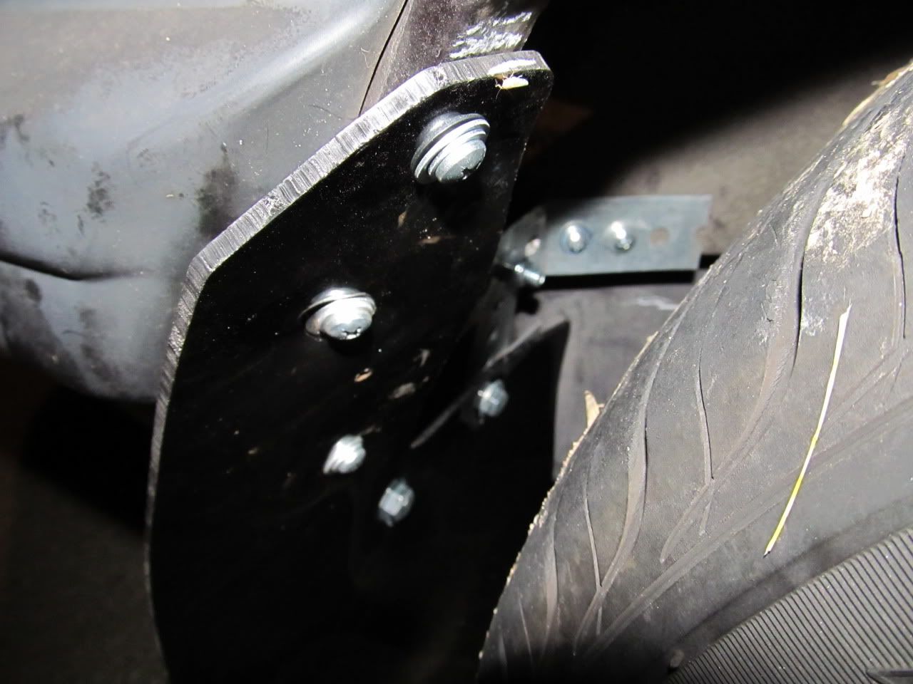

Going off of what Josh did to his car, we also got the large-size Rally Armor mud flaps installed:
Front:
Rear DS:
The rear PS was a little more difficult since the fuel tank is kind of in the way, but we rigged up a little extension for the main bracket and it all seems to be pretty sturdy:

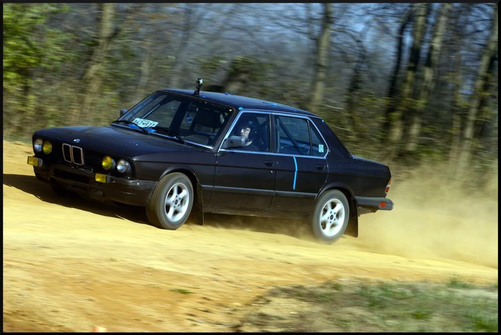

And some pics of the car in action. Approximately two minutes after these pics were taken I got a massive gash in the inner sidewall of one of my dry-rotted AS tires and the rest of the tune-n-tune was spent running around trying to find a tire to get home on. This week we're installing a set of 205/60/15 Firestone Winterforce tires, so we should be ready to rock and roll by the event this Sunday!

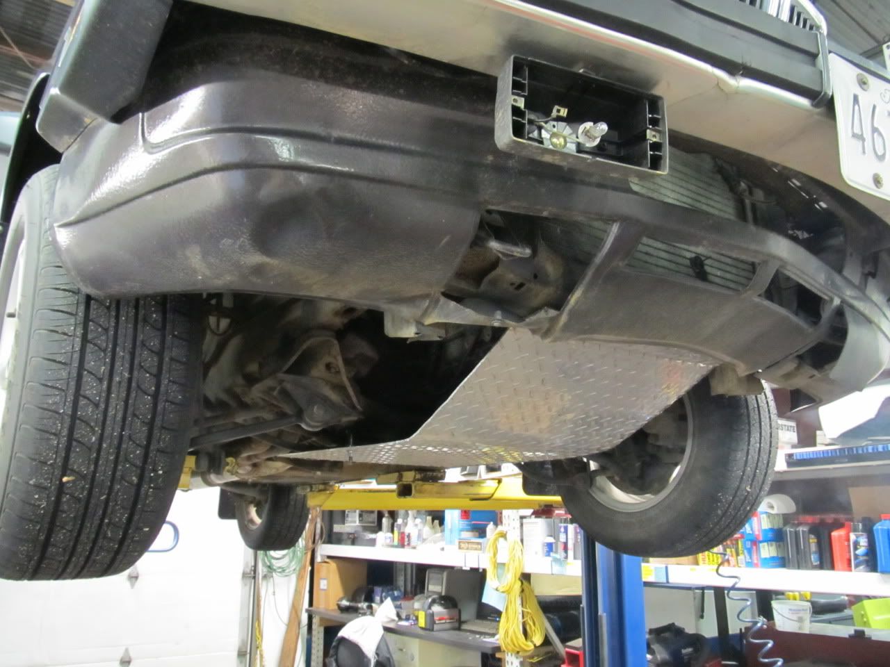

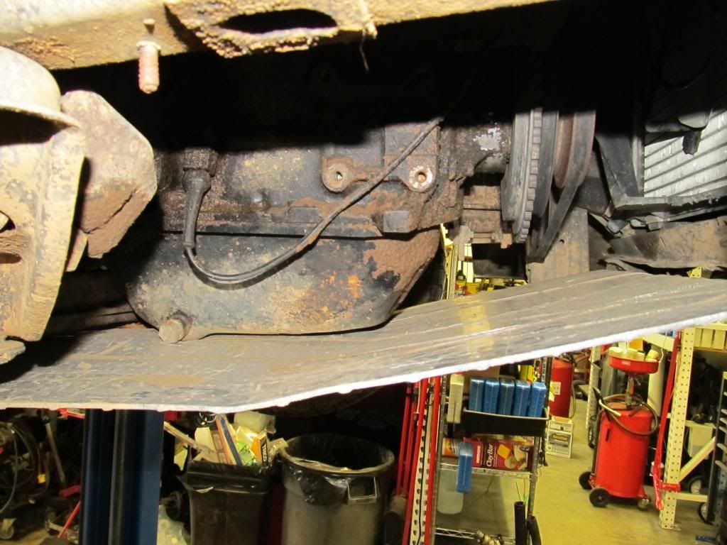

These E28s seem to be notorious for having low oil pans (the lowest point actually sits below the rear section of the subframe), so a skid plate was in order. There were two options we could purchase, but we wanted to keep it cheap, so we attempted to make our own. A friend had a sheet of diamond plate aluminum lying around, so we decided to try to use it. After much cutting, we had our initial section. Unfortunately, there wasn't a good way to attach it to the rear section of the subframe, so some welding was in order. Step in Eric at Joe's Professional Auto Care (the shop I used to work at). Eric was the one who welded on the fender braces for my I30, and I know I can trust him. Get to work!
Did somebody say pee beams??? (Krylon Stained Glass, Yellow #9024, $15)

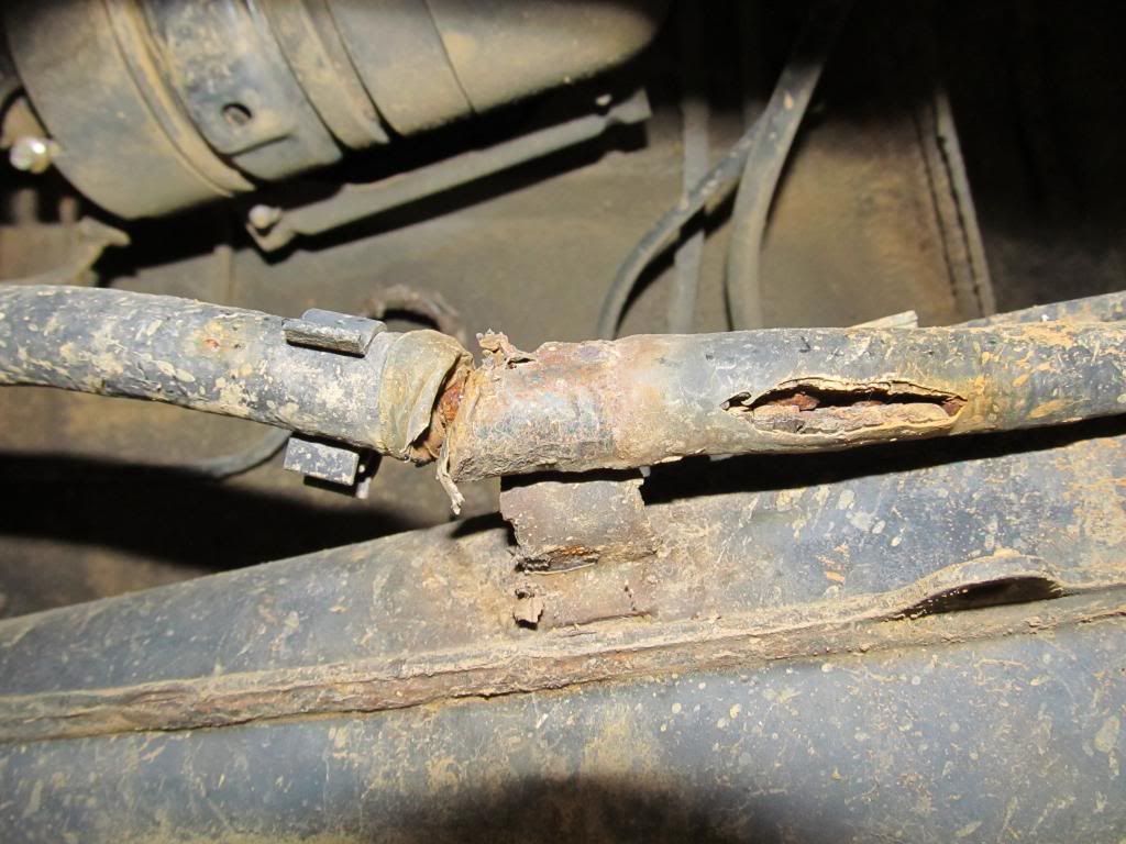

I also think I figured out why the e-brake doesn't work very well....

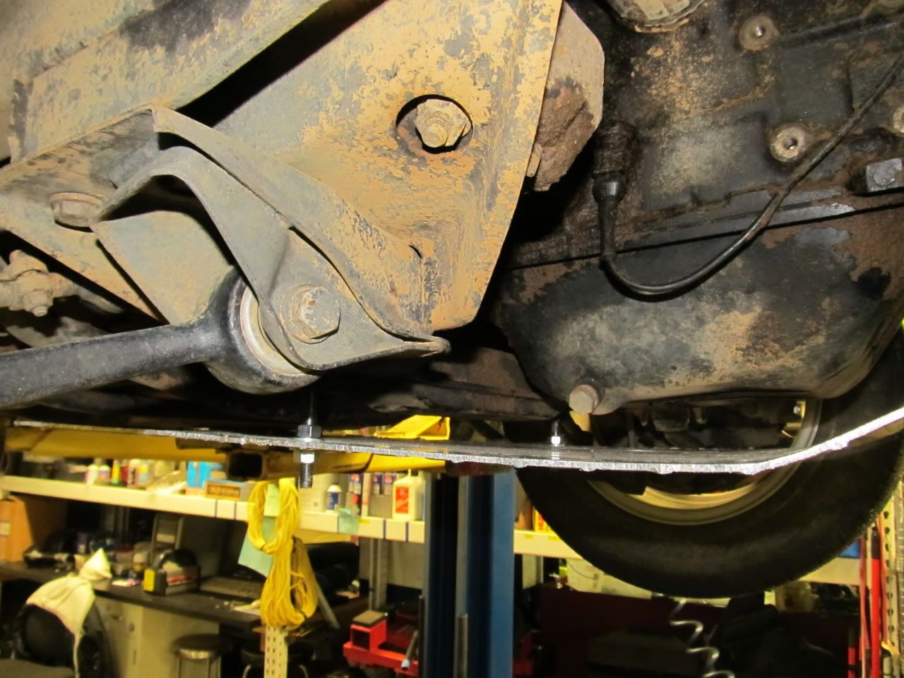

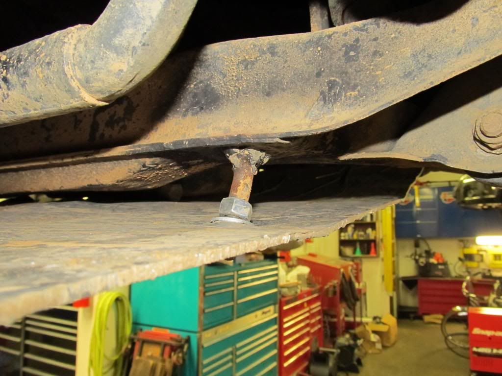

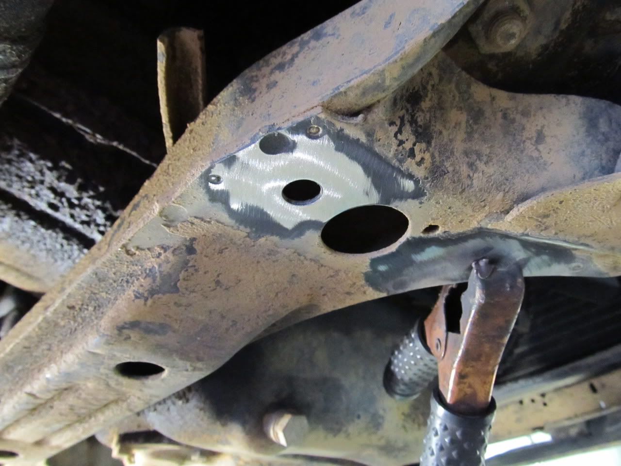

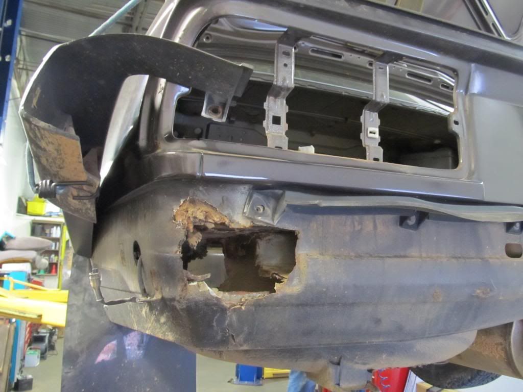

Oh, remember how much clearance we had between the skid plate and the oil pan? Well this sure didn't take long....
Time to fix it!

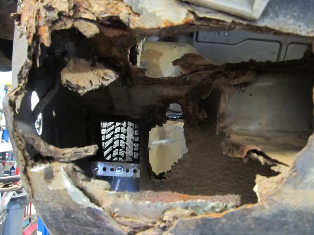

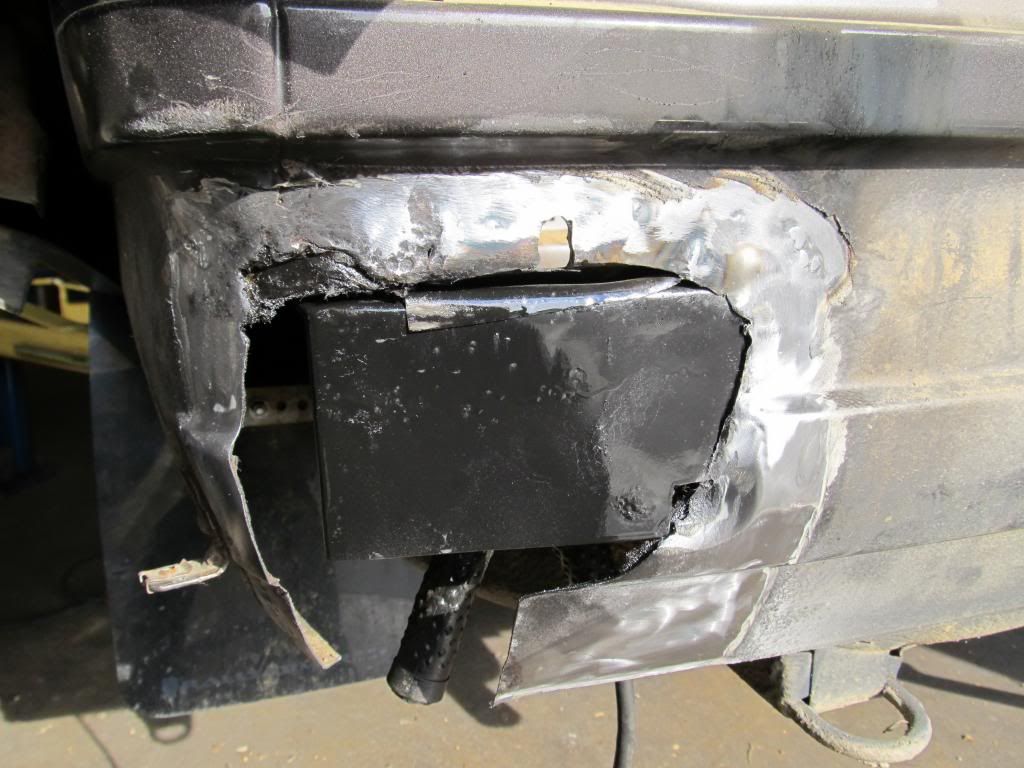

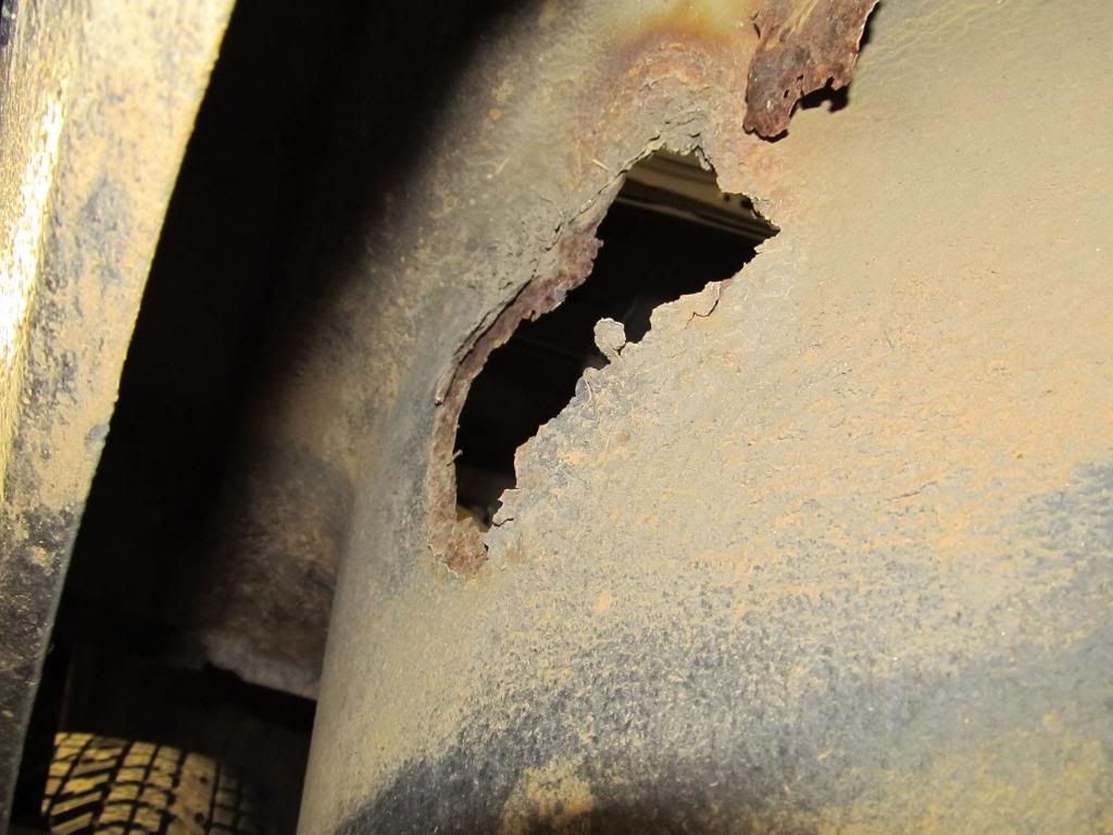

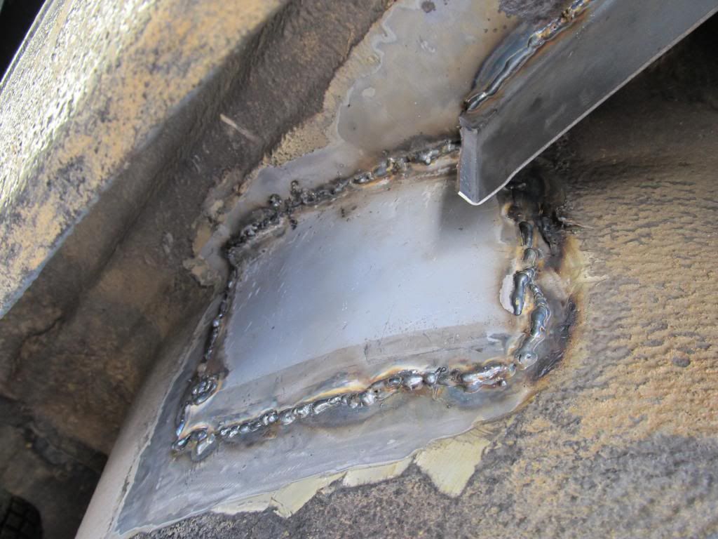

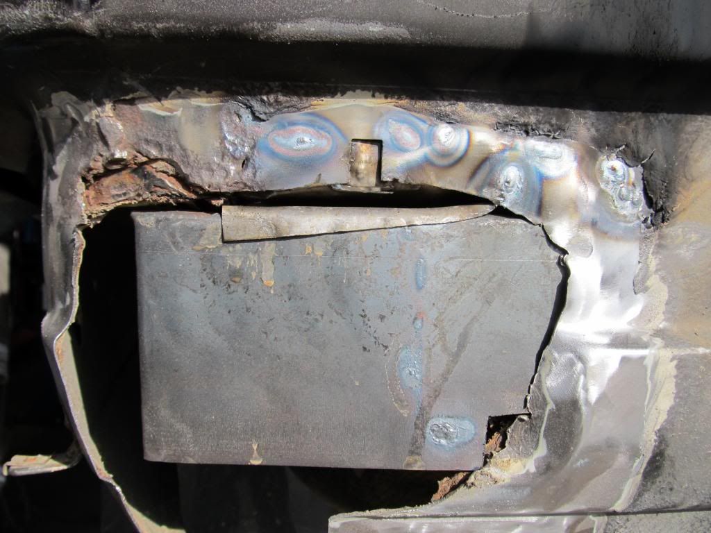

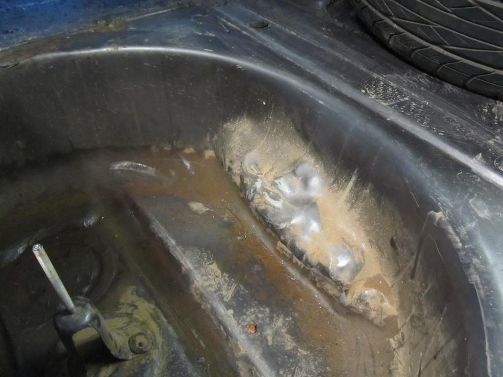

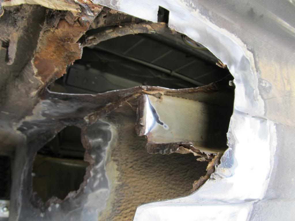

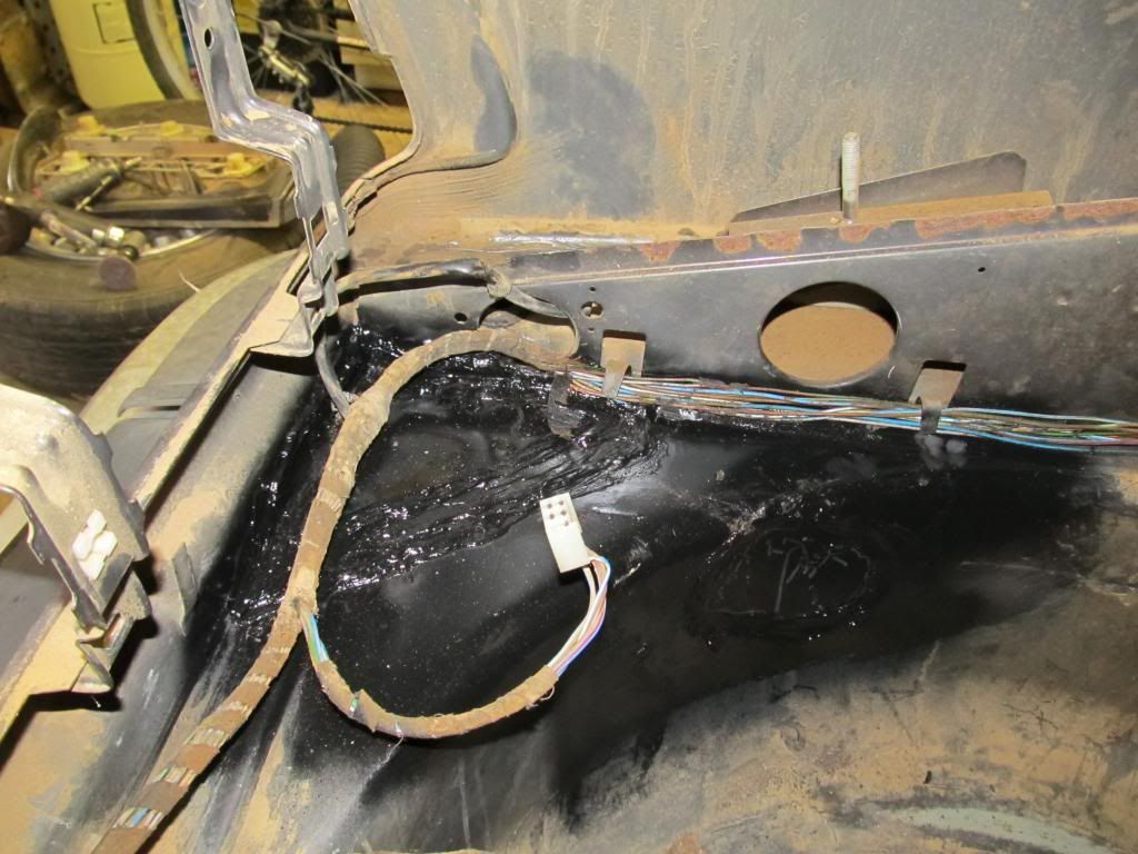

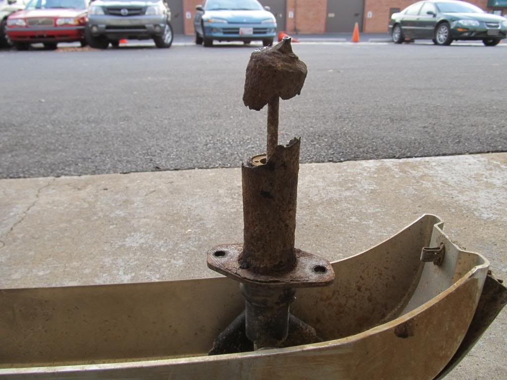

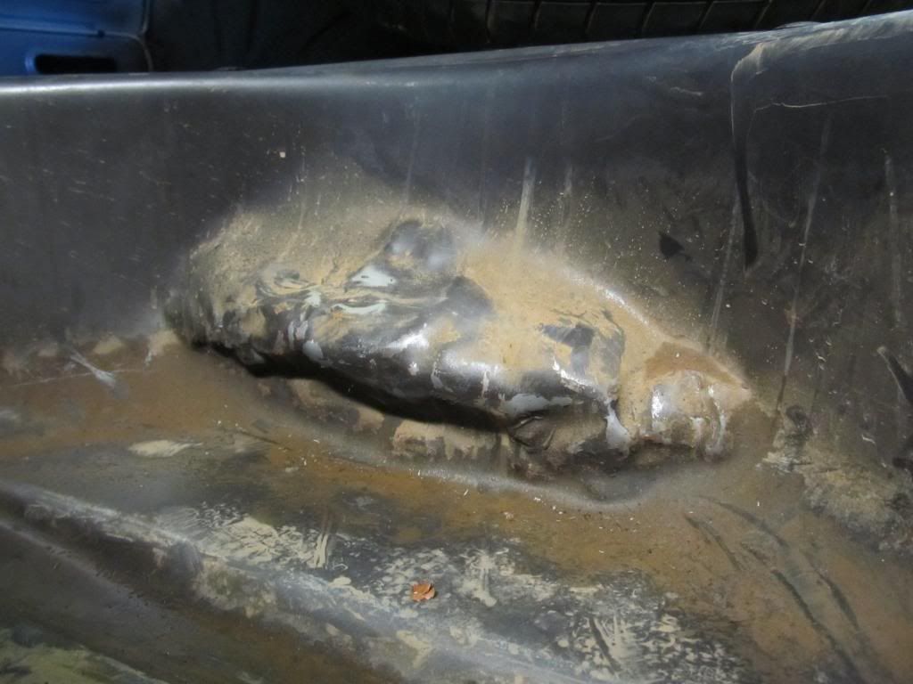

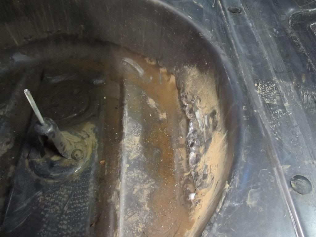

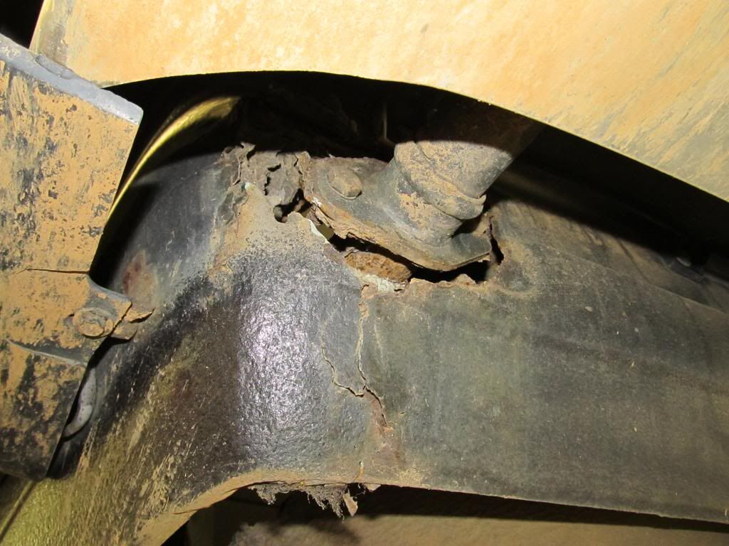

Also, after event 6 Josh pointed out that a piece of my spare tire well had fallen off. Turns out the rear section of the car on the DS was pretty much all bondo. Great. Get out the welding materials!
Bottom of spare tire well:
We already knew the mount for the DS bumper shock was gone...
Another view from underneath
95maxrider
Posts: 435
Joined: Sep 25, 2012 2:50 PM
Location: Herndon, VA
Post by 95maxrider »

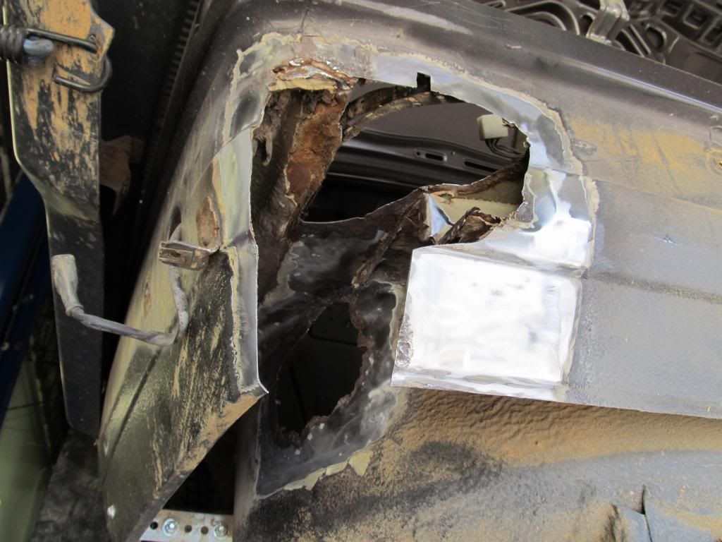

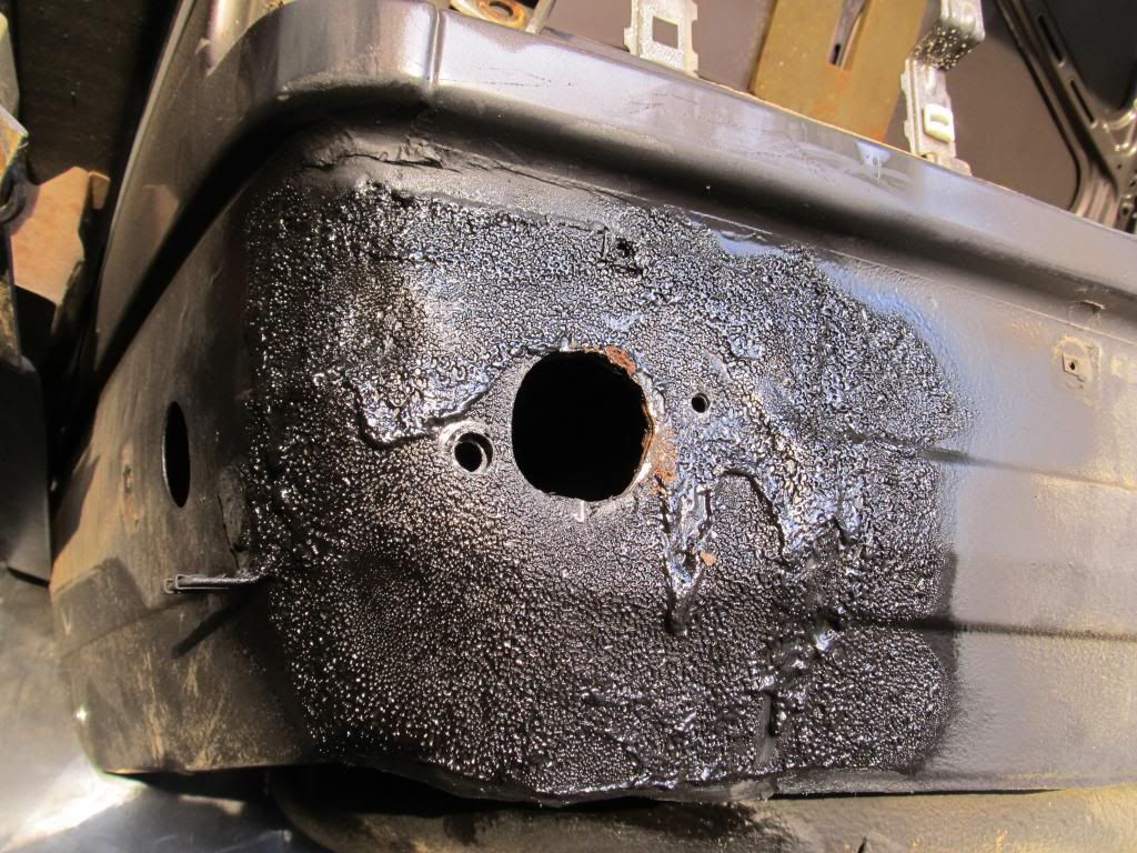

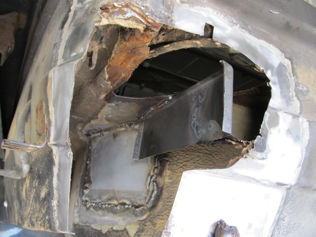

It gets worse....
What a view!
Cleaning up...
That was all bondo!!!
New spare tire well!

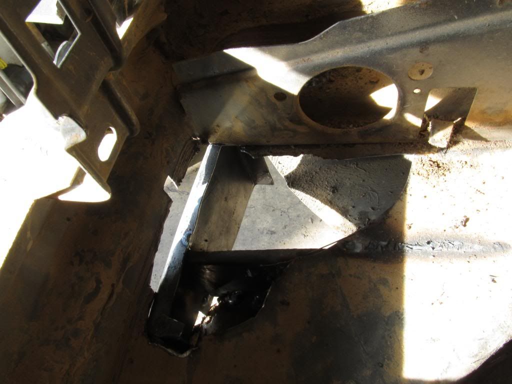

Rebuilding the body back to stock specs/design:

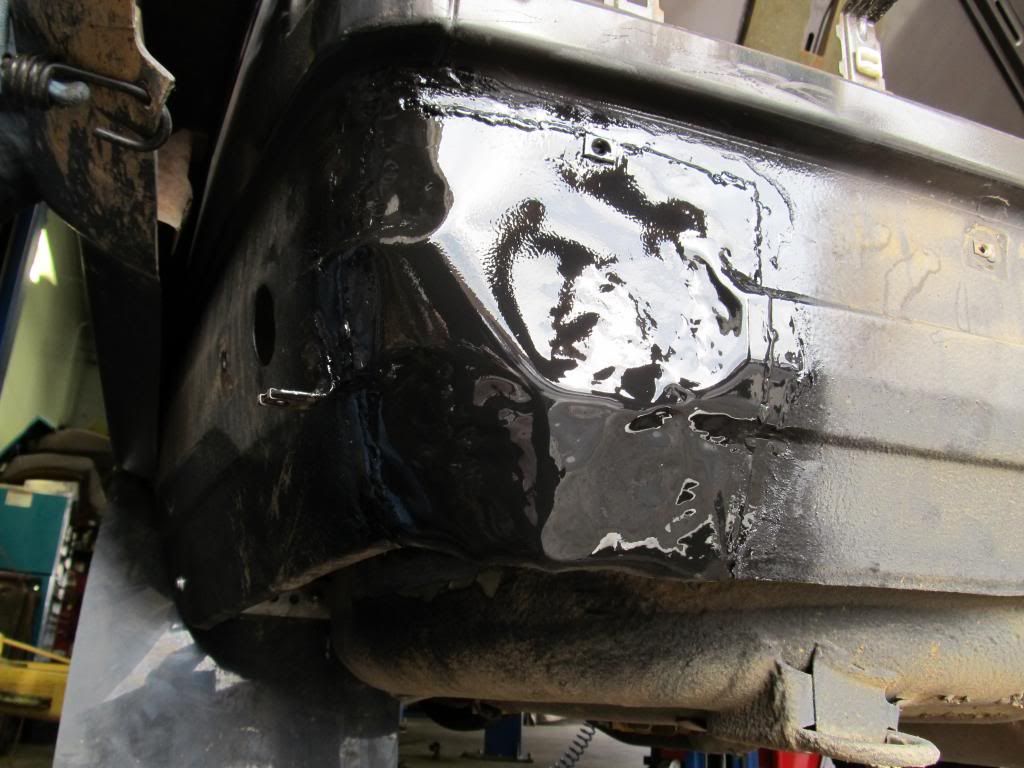

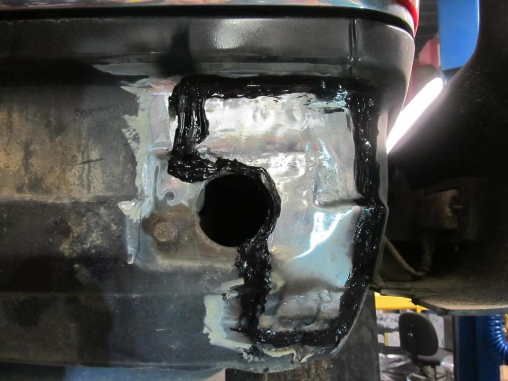

Time for some rubberized undercoating
All done!
Um, I think it's broken

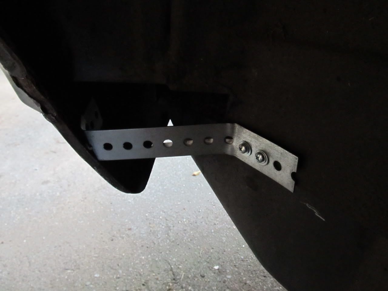

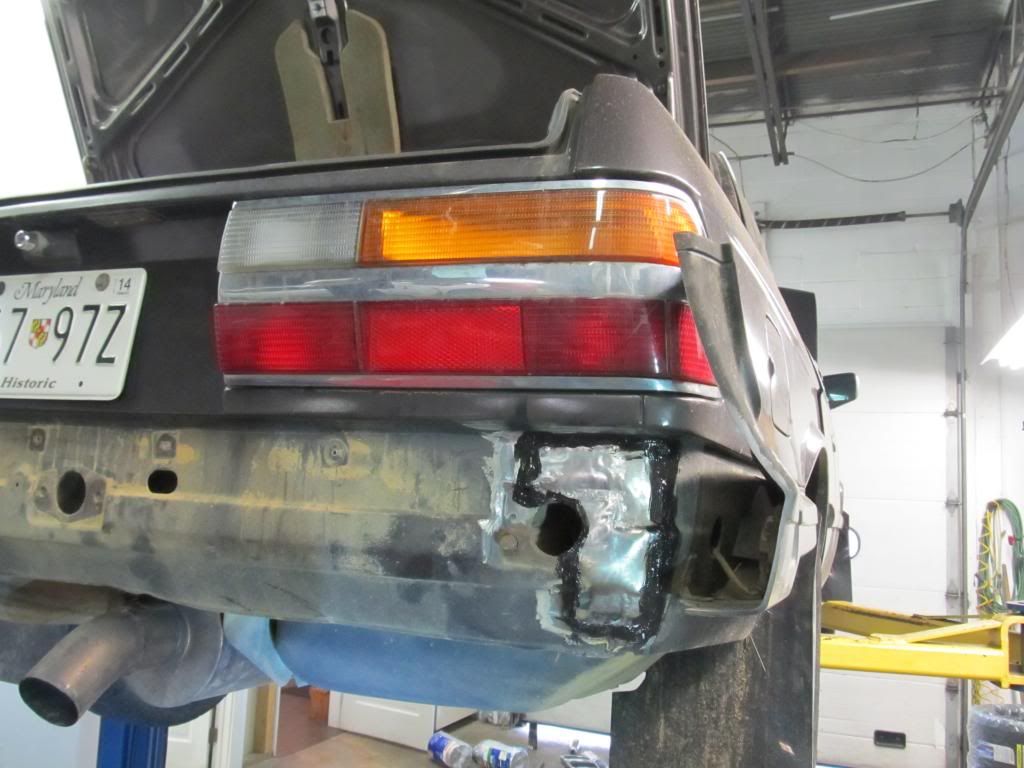

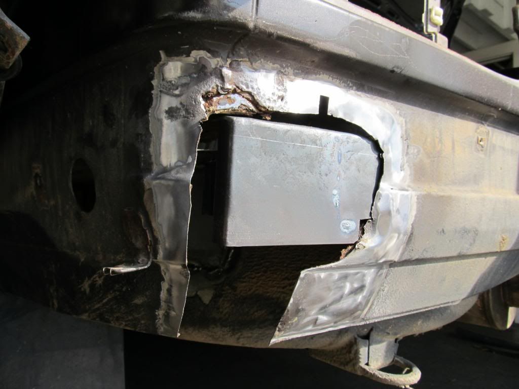

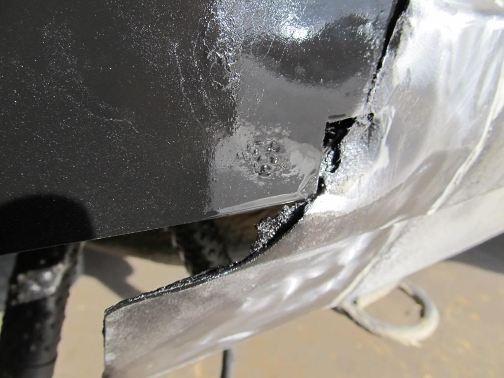

So we had planned to do the normal method of tucking in the diving board bumpers by drilling out the oil and sticking a bolt through to hold it in place. Eric had other plans!
We ended up tucking about 1.5" of the rear bumper. We had other plans for the front though...
Pictures of finished product are coming....

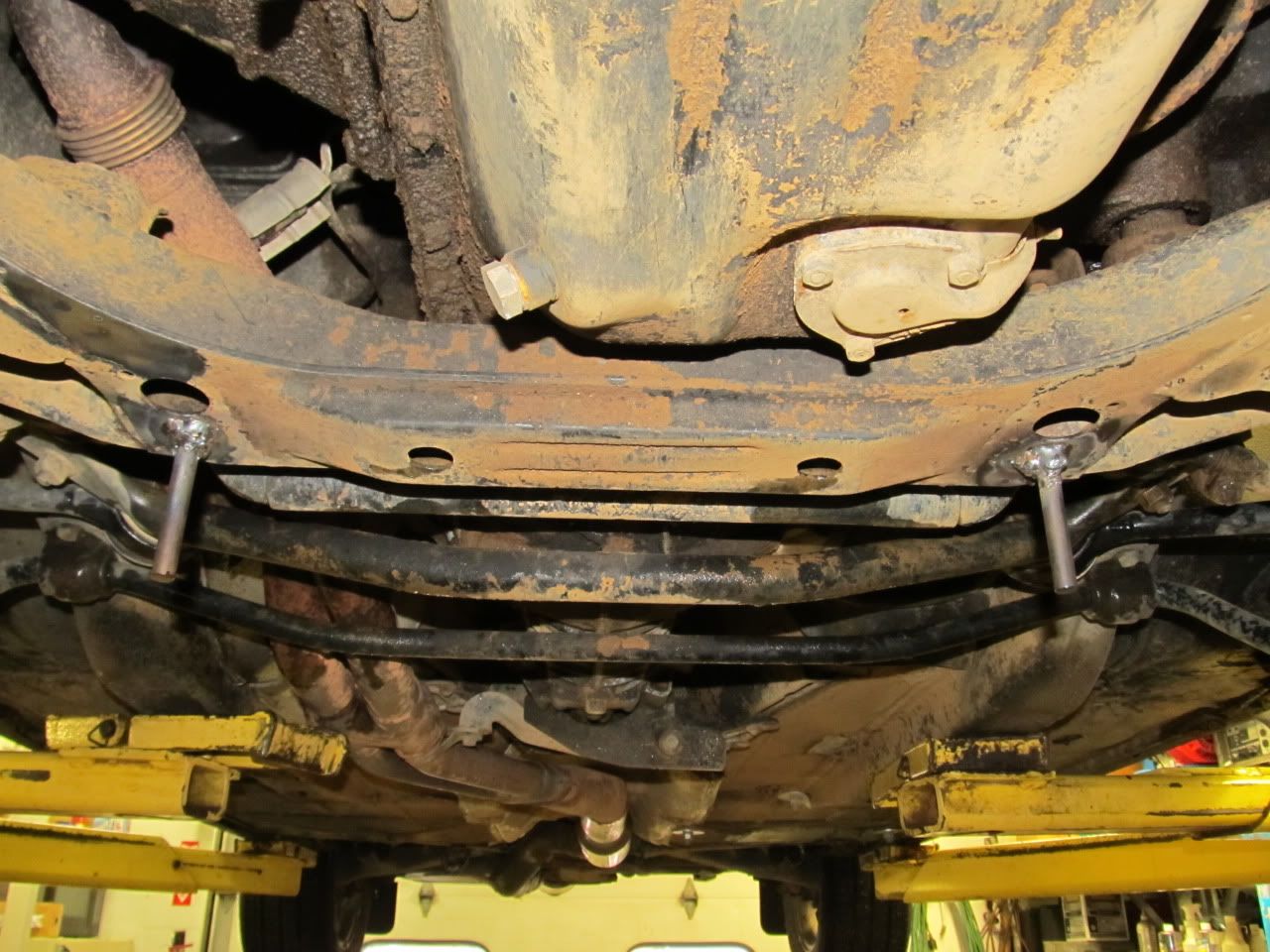

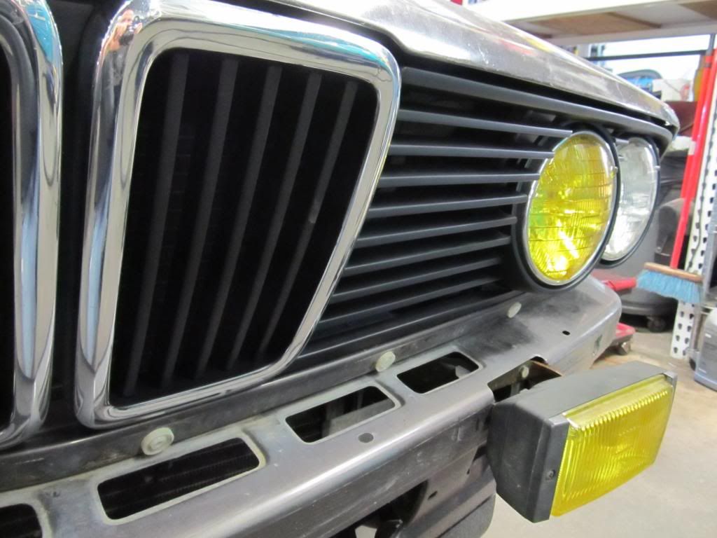

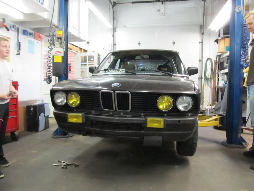

First, some pics of the car with the front bumper removed

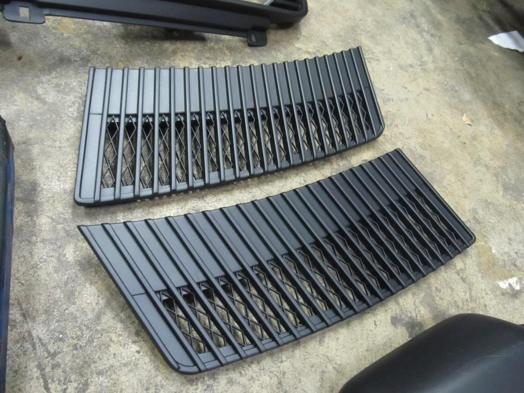

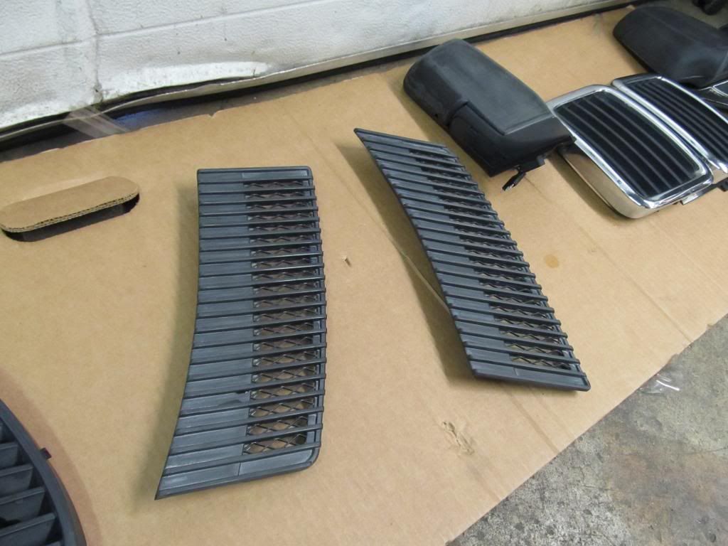

Then it was on to the passenger side to fix a bit of surface rust. It was only on the exterior panel and wasn't anywhere near as bad as the other side. Unfortunately, I didn't get any good before pics, so these will have to suffice.

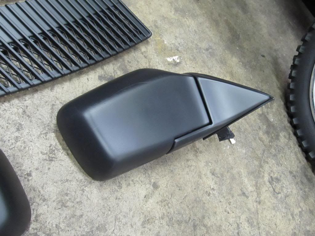

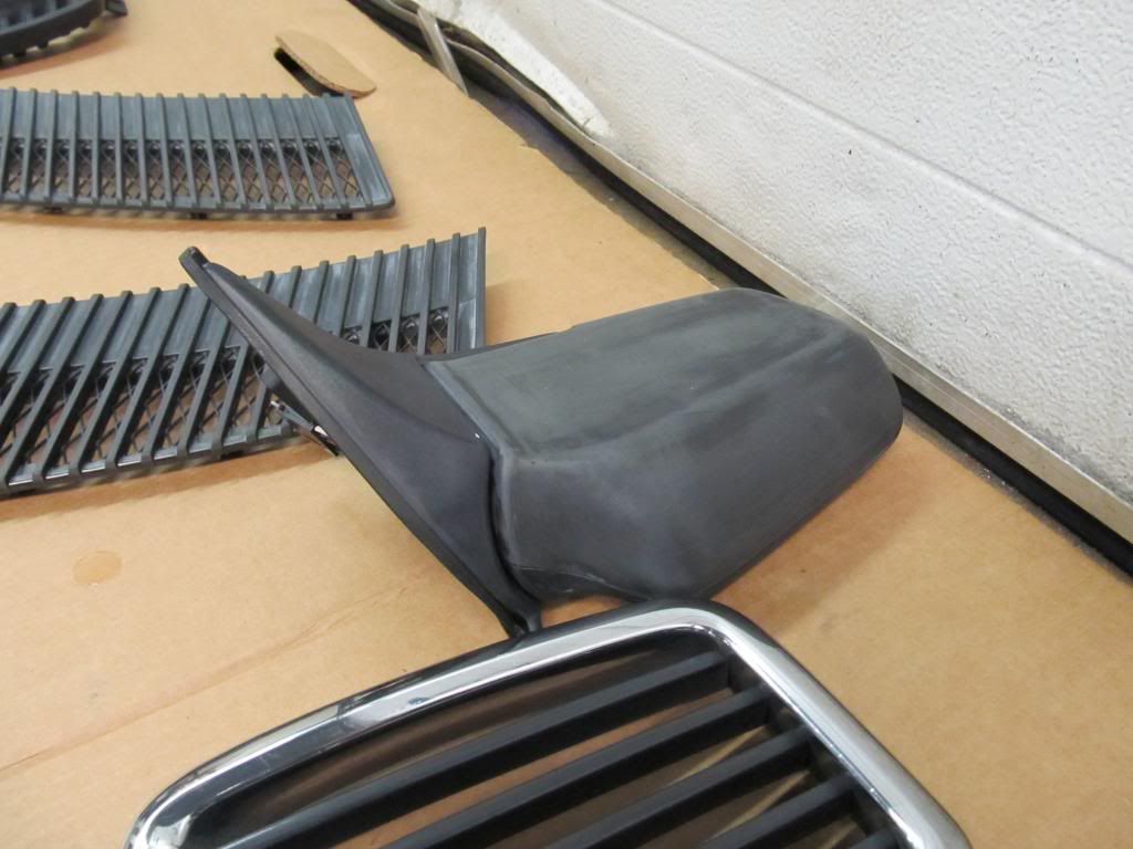

The black plastics on the exterior of the car were pretty faded, so I sanded them down, cleaned them off, and painted them flat black. Thankfully, it turned out pretty well.
Before:
After:

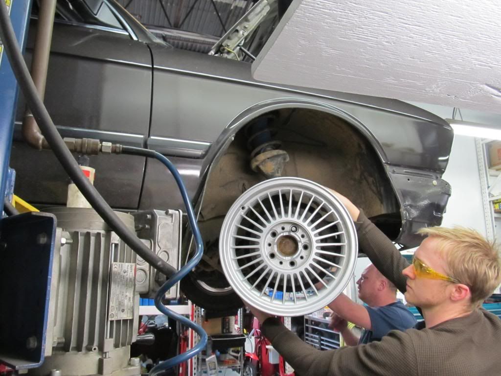

We decided to test fit one of the style 4 wheels, and learned it pretty much rubs against the strut, so we need at least a 12mm spacer.

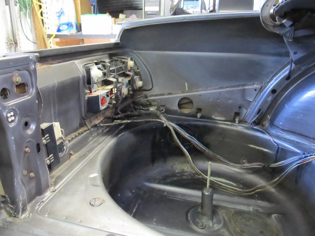

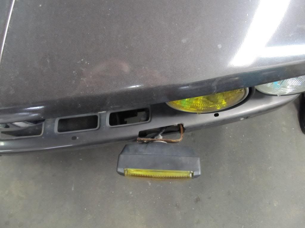

We then cut/bent the fog light brackets so they sat a little more flush in the holes:

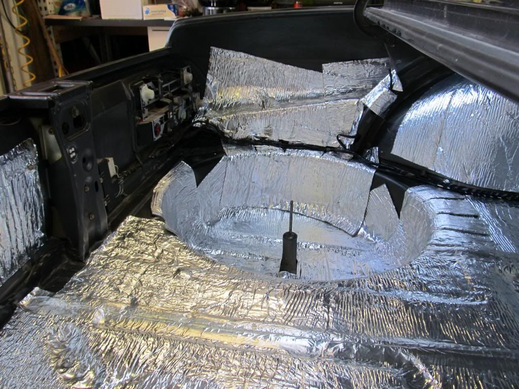

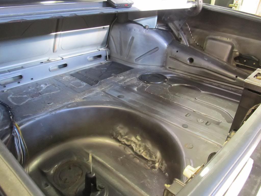

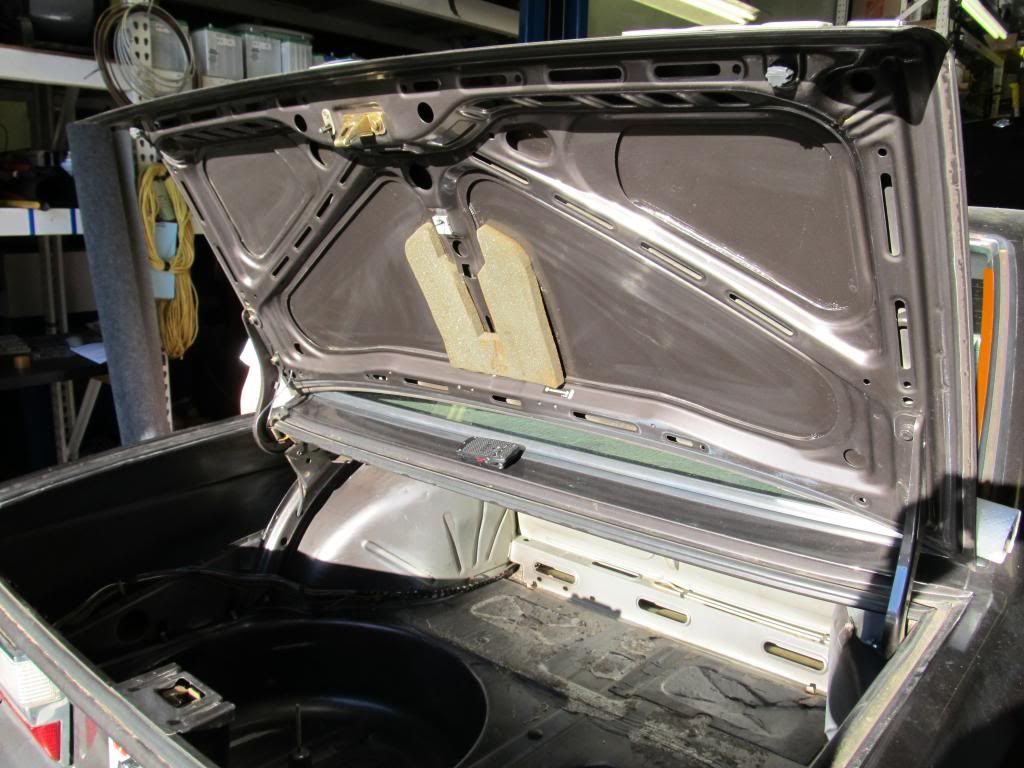

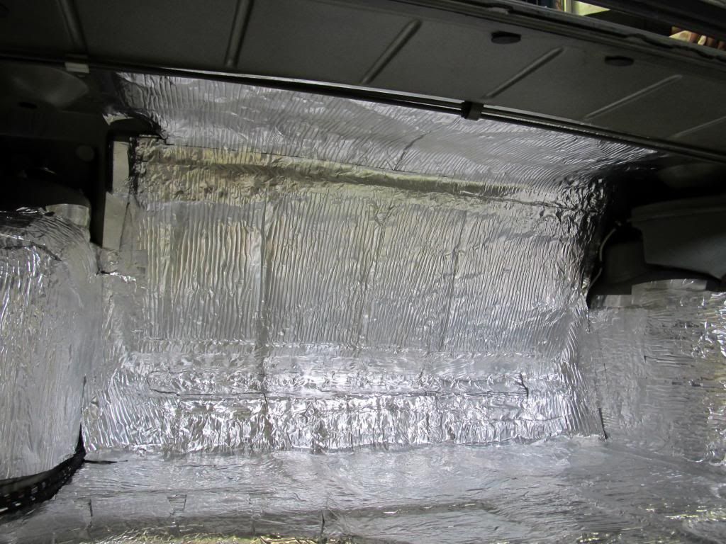

In preparation for the sound deadening and to get the spare to actually fit, we hammered out this crap in the spare tire well that the previous owner thought was necessary to get the muffler to fit, but I think he got carried away.
So we fixed it a bit

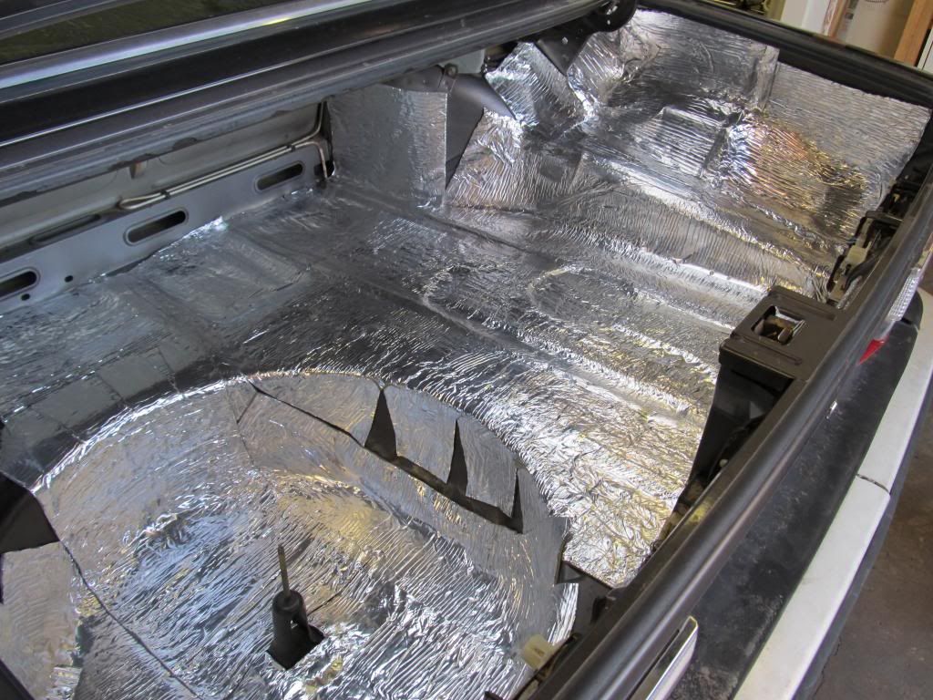

Cleaned out the trunk with soapy water, simple green and then brake clean:
Then it was on to stage one of the deadening:

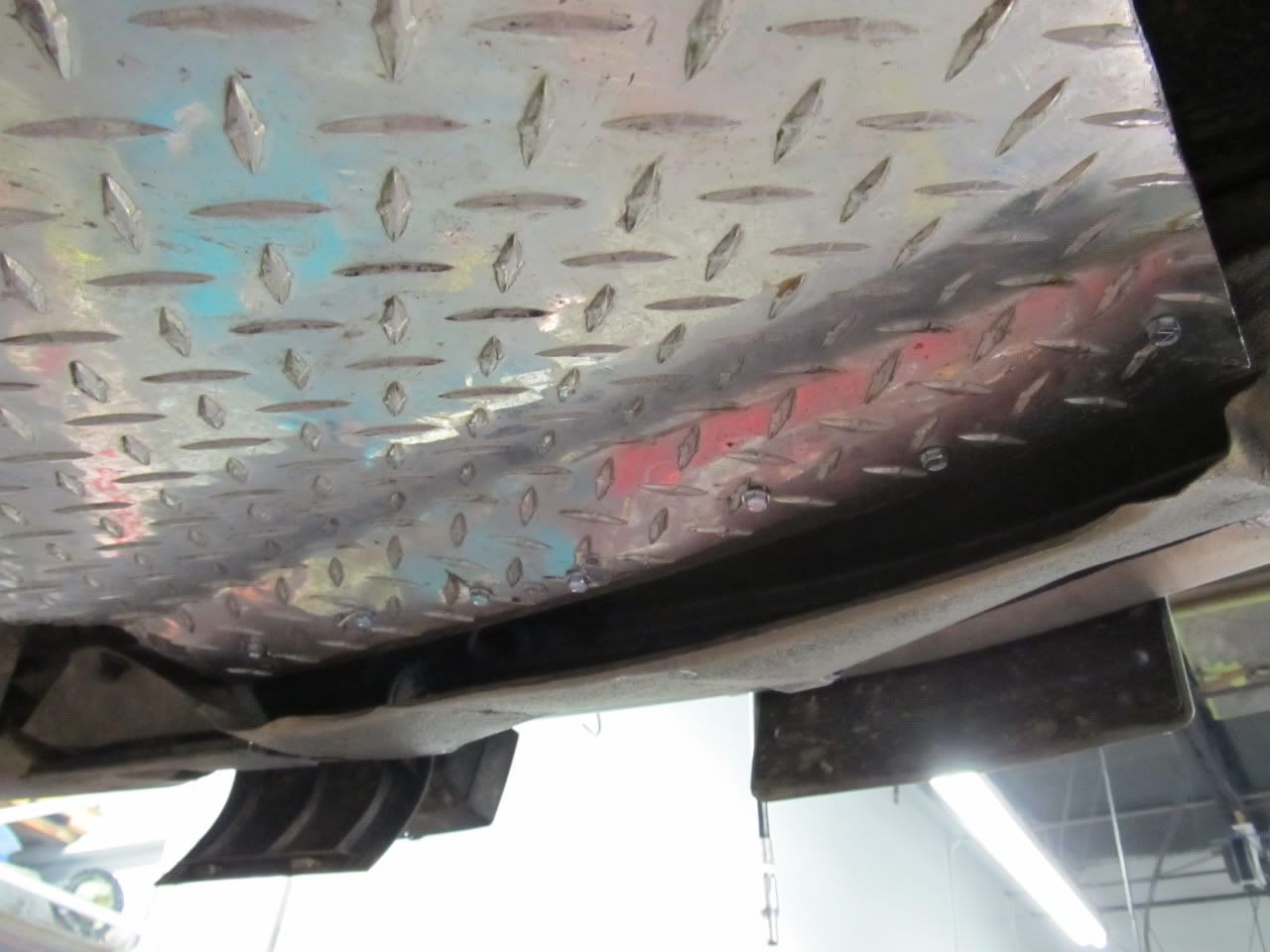

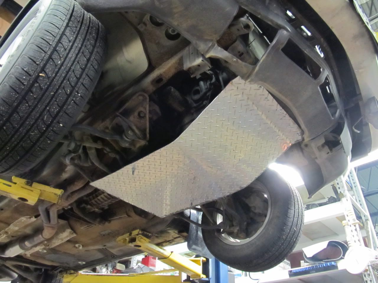

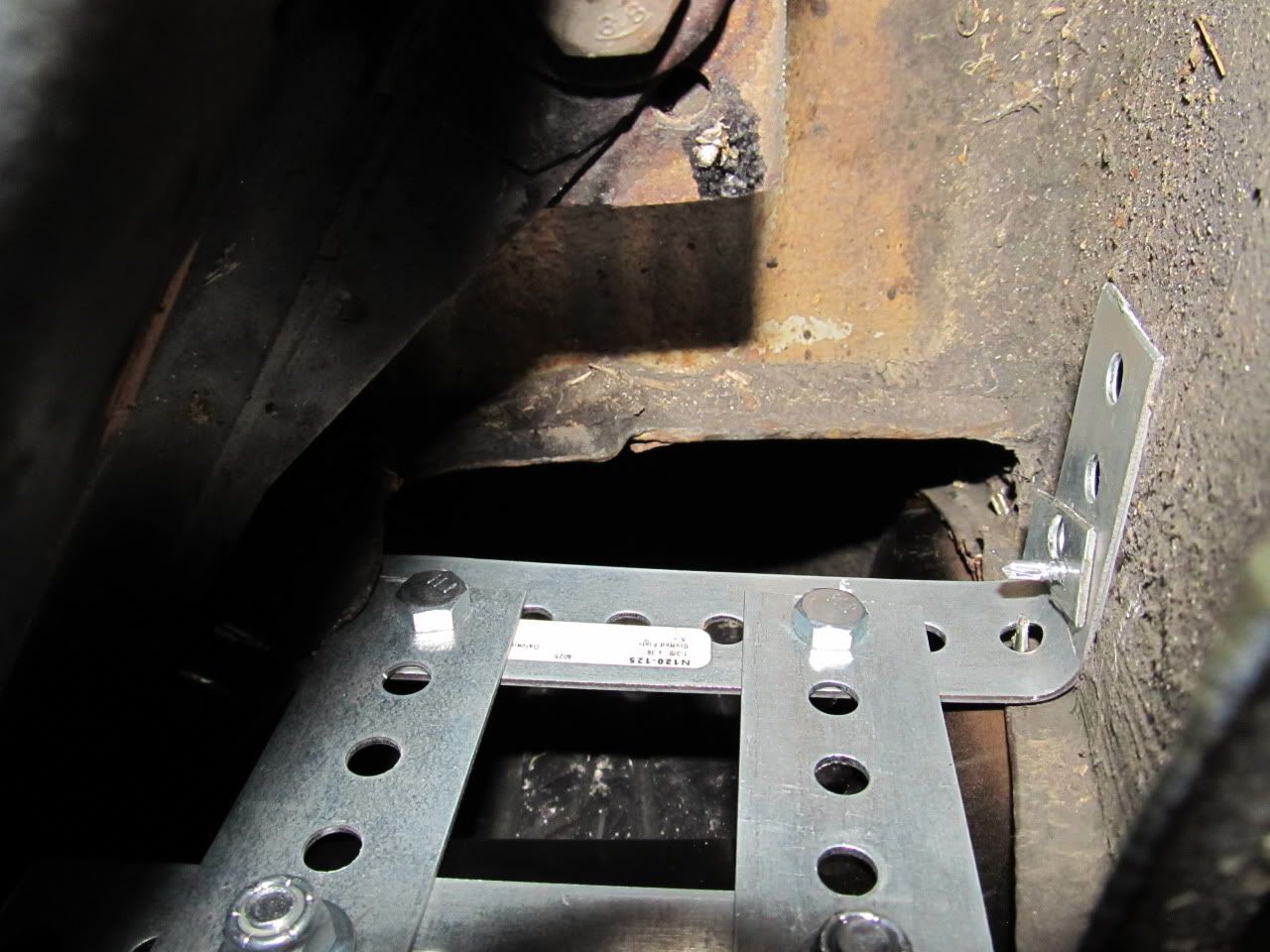

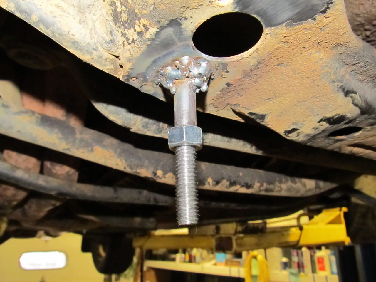

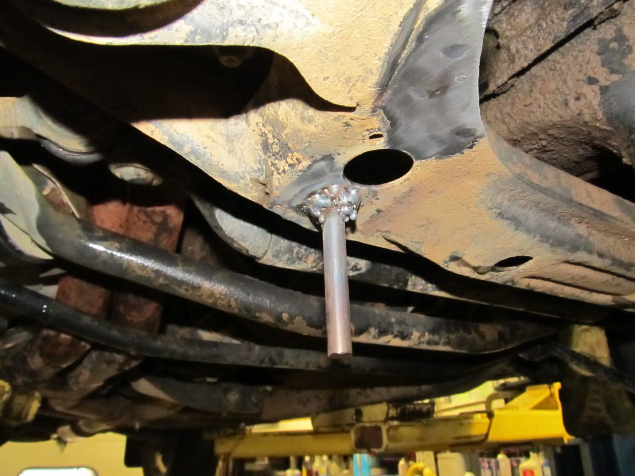

And how about some extra skid plate bracing? It's a work in progress, so check back later for finished pics!

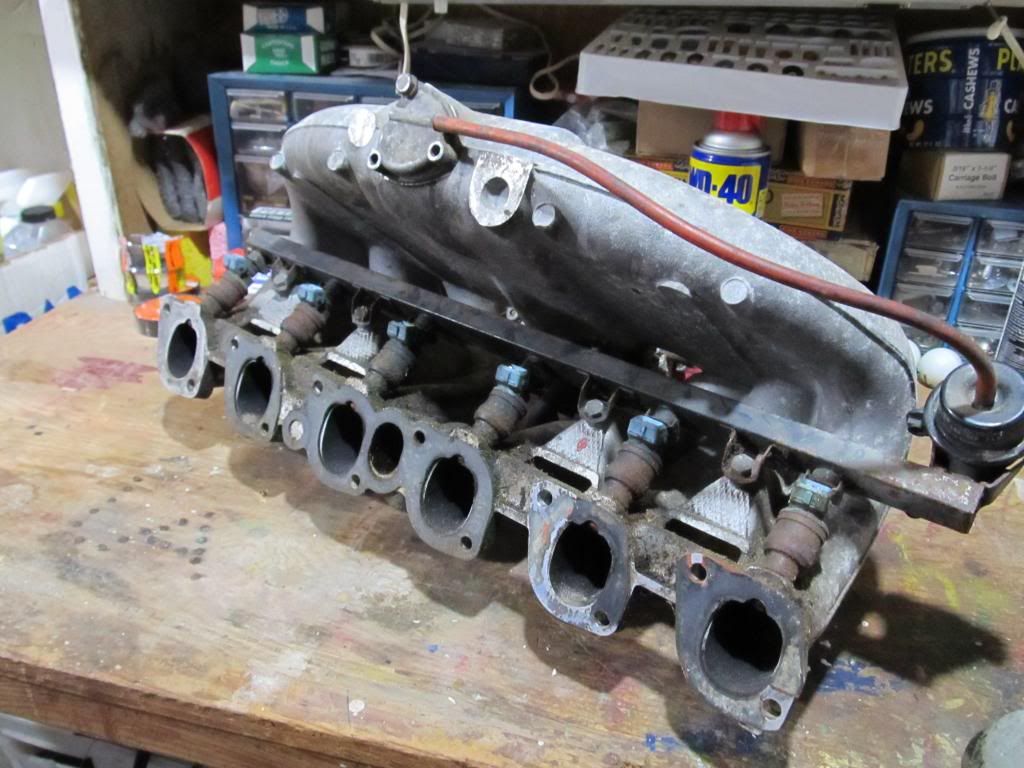

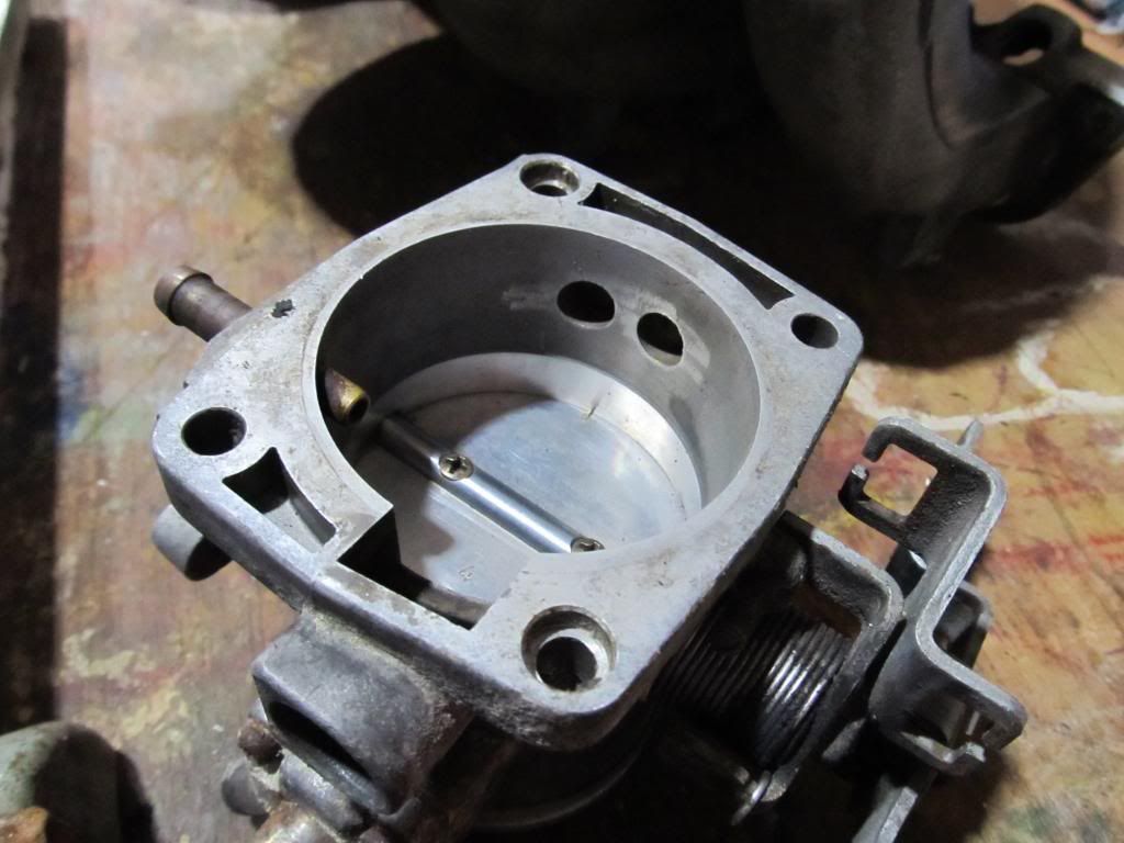

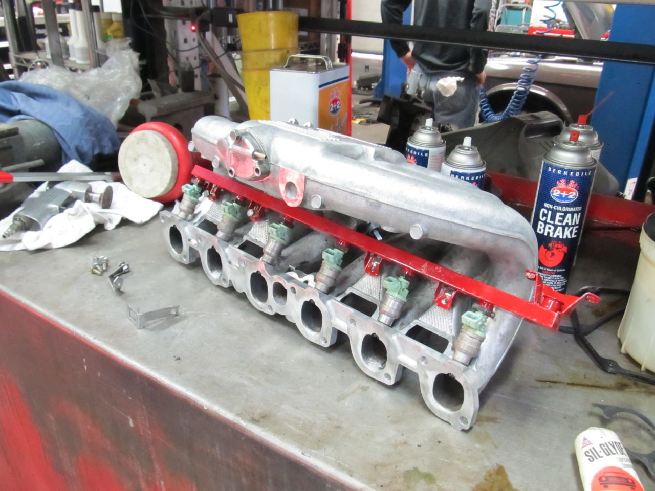

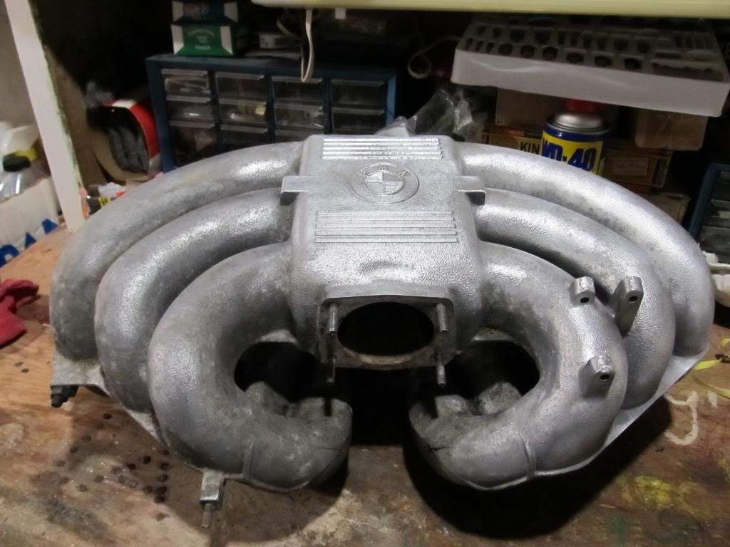

We disassembled stuff on the 2.5 intake manifold and went to town with some brake cleaner and my new wire wheel attachments for my drill/impact. We're not done yet though!
Might as well do a pic dump....
It's kind of dirty...
After!
Clean on the right, dirty on the left

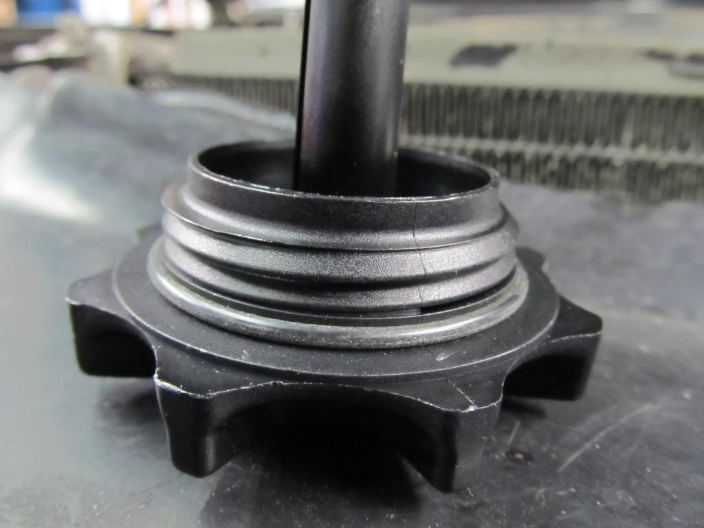

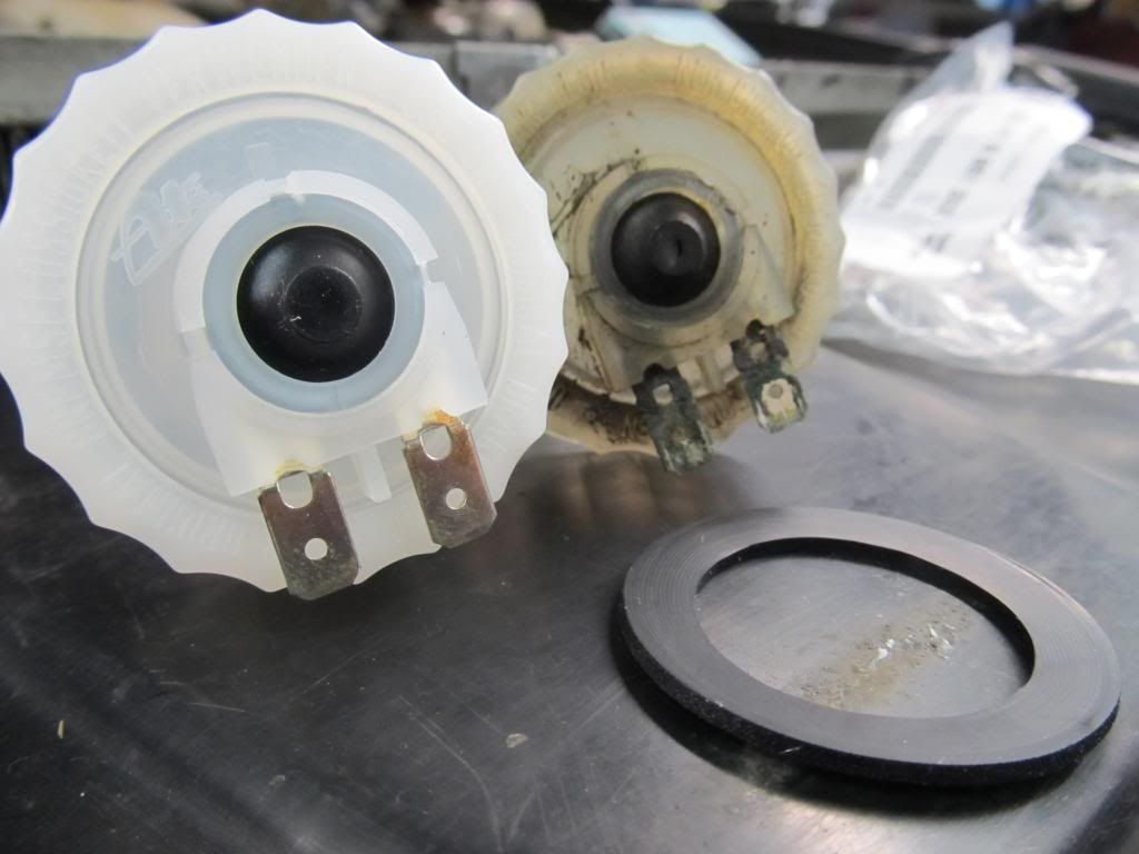

First up was comparing the new PS and brake fluid reservoir caps to the old ones to find out why the old ones were leaking. Closer inspection revealed a torn rubber cap on the brake fluid cap and a worn out/crushed rubber o-ring on the PS cap. The will hopefully take care of two fluid leaks in the engine bay.
Old PS cap
New PS cap
New and old brake fluid caps

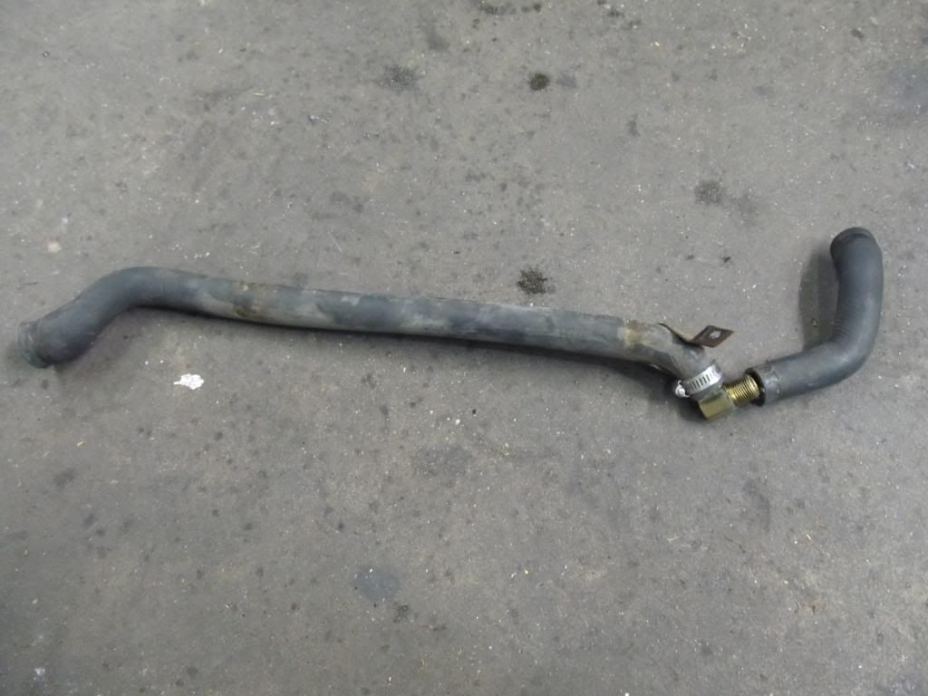

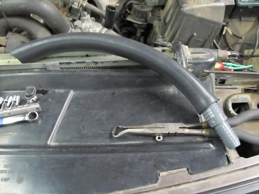

Then it was on the replace the leaking coolant hose under the IM. This was the thing that was leaking at the final event last year, and not the HG. The hoses had started deteriorating and expanding, and the connector used wasn't exactly meant for the job.
Location:
The culprit
The solution
After filling and burping the system, we found another leak. Hooray! This one was coming out of the fluid level sensor for the coolant overflow tank. I'm thinking we should replace the sensor and the tank at the same time and just be done with it.

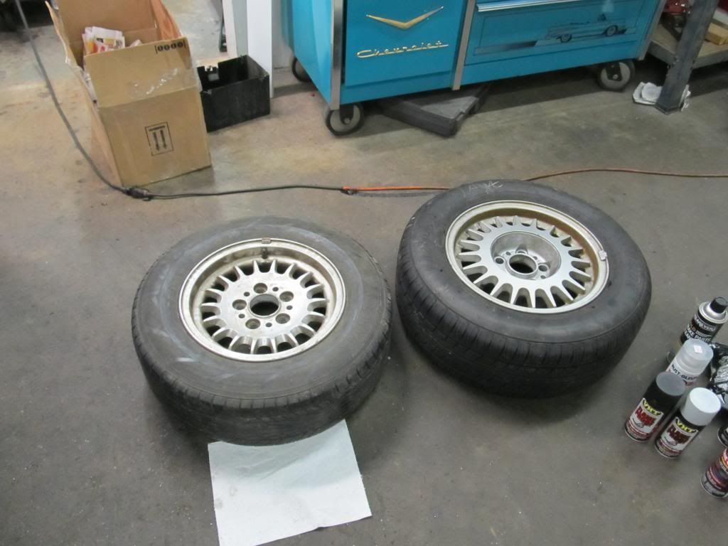

We then mounted that one 15" tire we had to buy at the test and tune last year when I popped a dry rotted tire on a wheel I got off the forums. It's a bit bigger than the stock 14"!

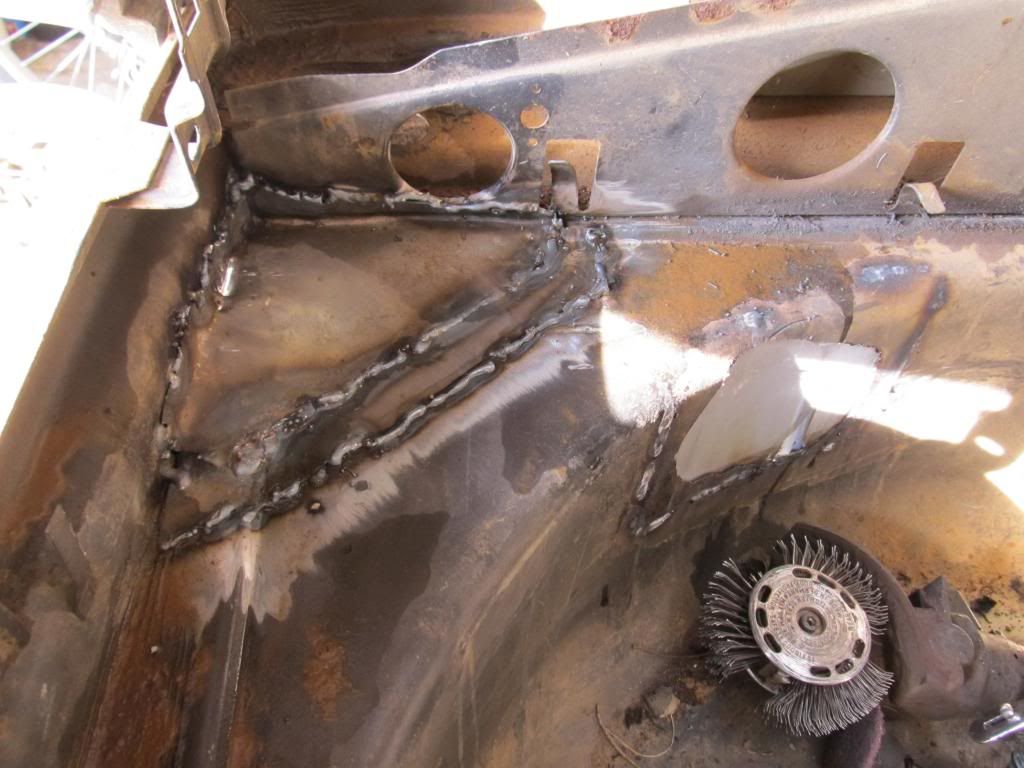

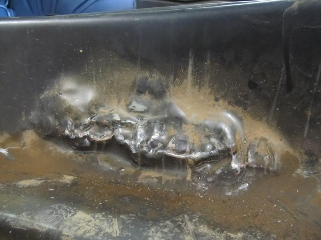

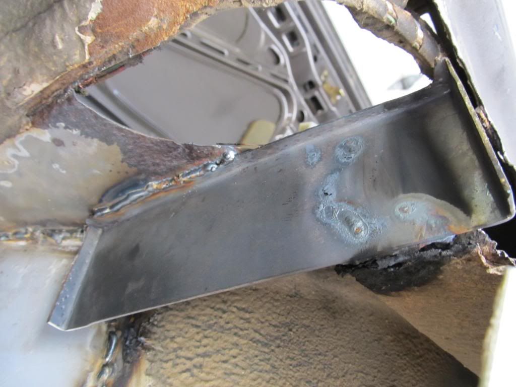

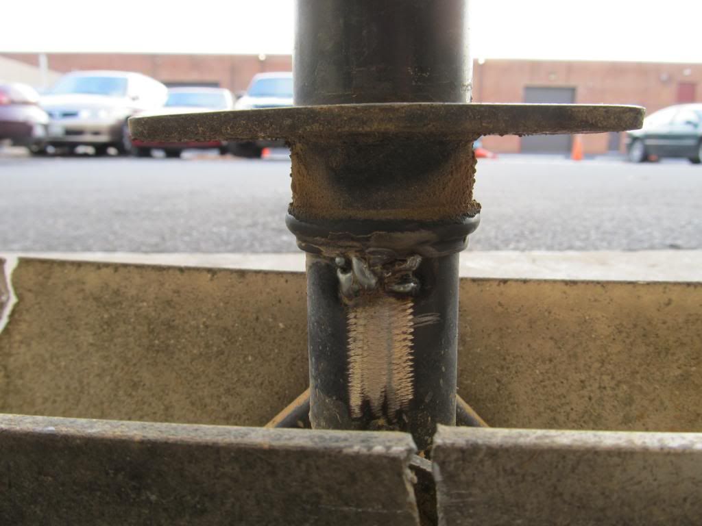

Then Eric finished welding the bracing for the skid plate (it was just tack welded before in some areas) and painted it up.

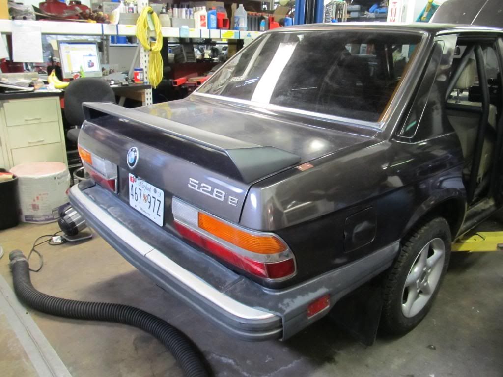

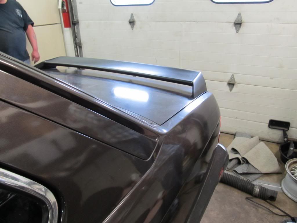

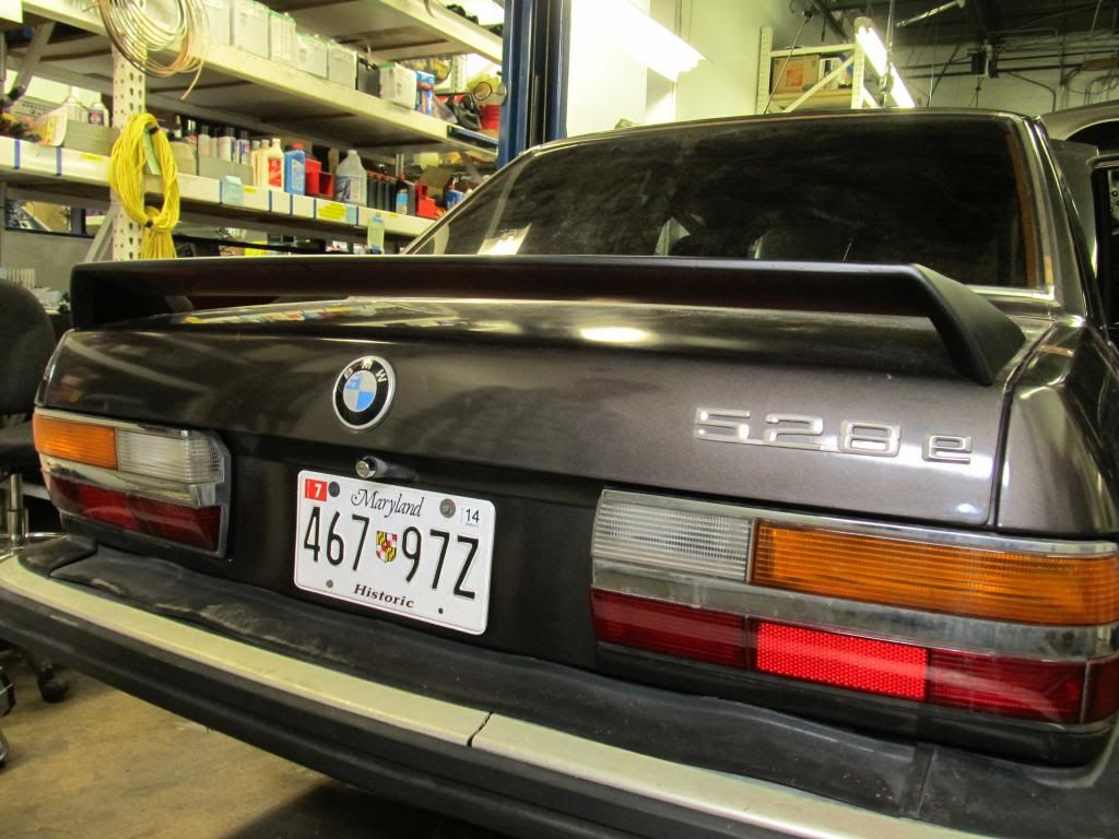

Then I painted the spoiler we found on Ebay and test fitted it on the car

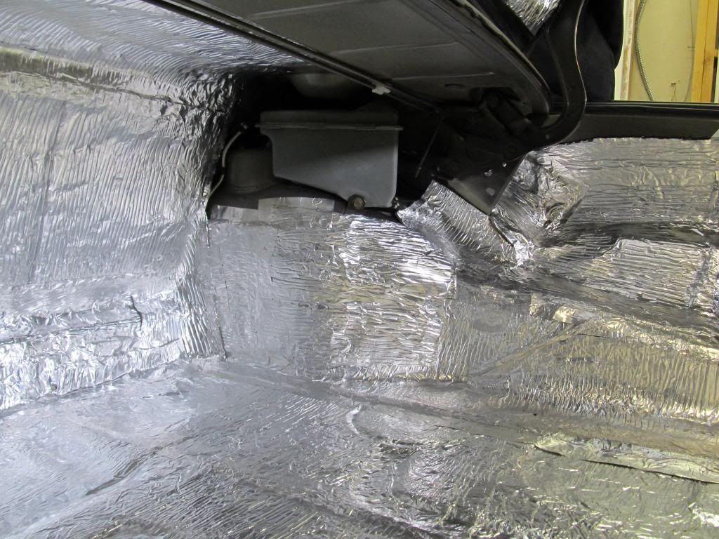

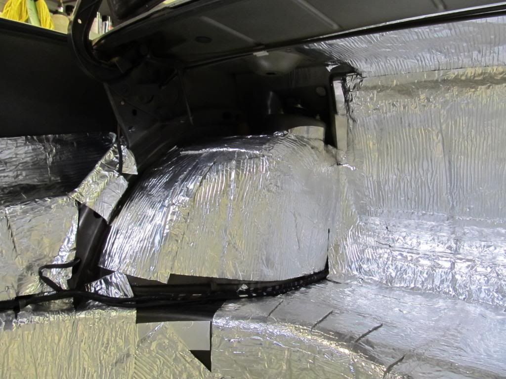

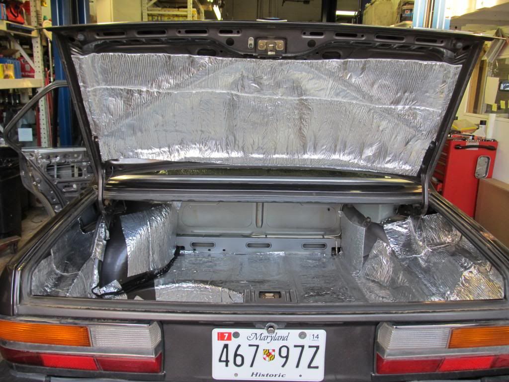

And did some more sound deadening in the trunk

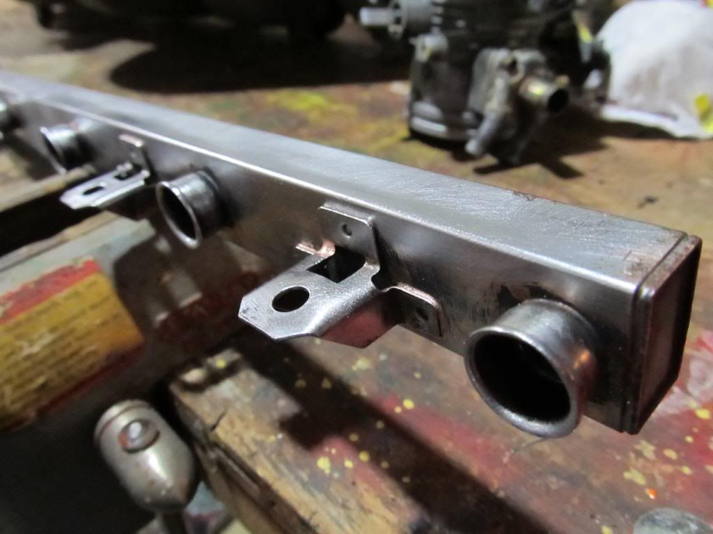

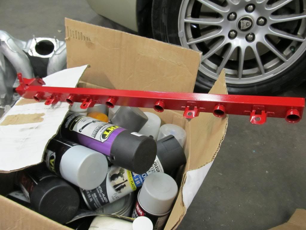

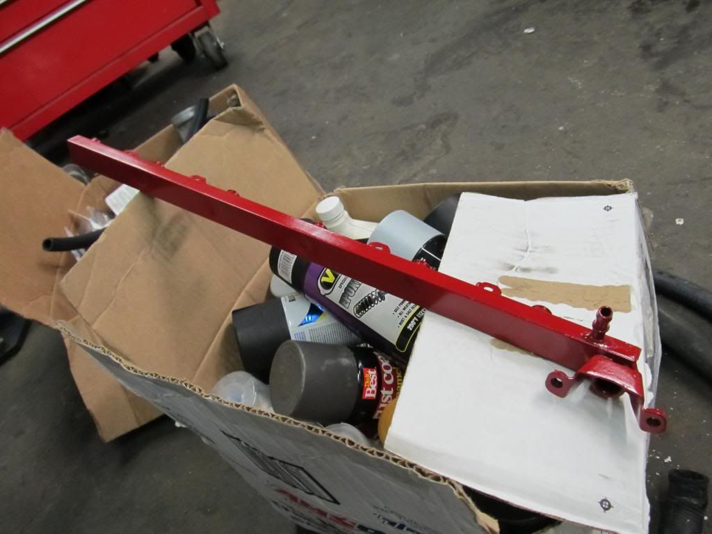

And painted our fuel rail....
Fun times! Now we just have to relocate the battery, customize the PS seat belt to fit with the roll cage and tie up some loose ends, then it's ready for the head swap!

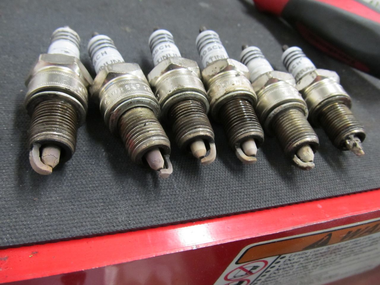

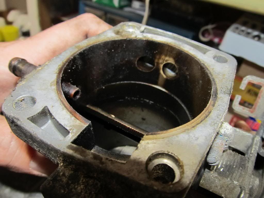

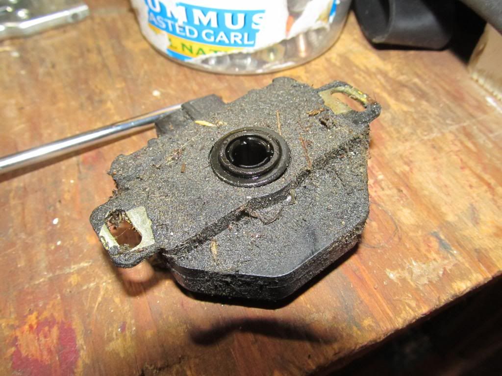

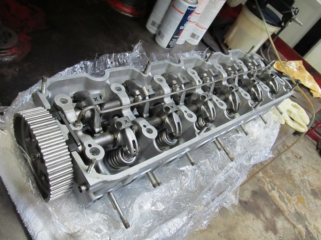

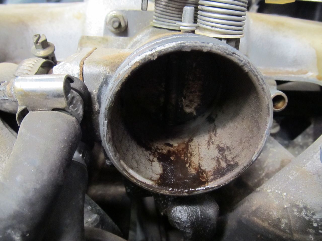

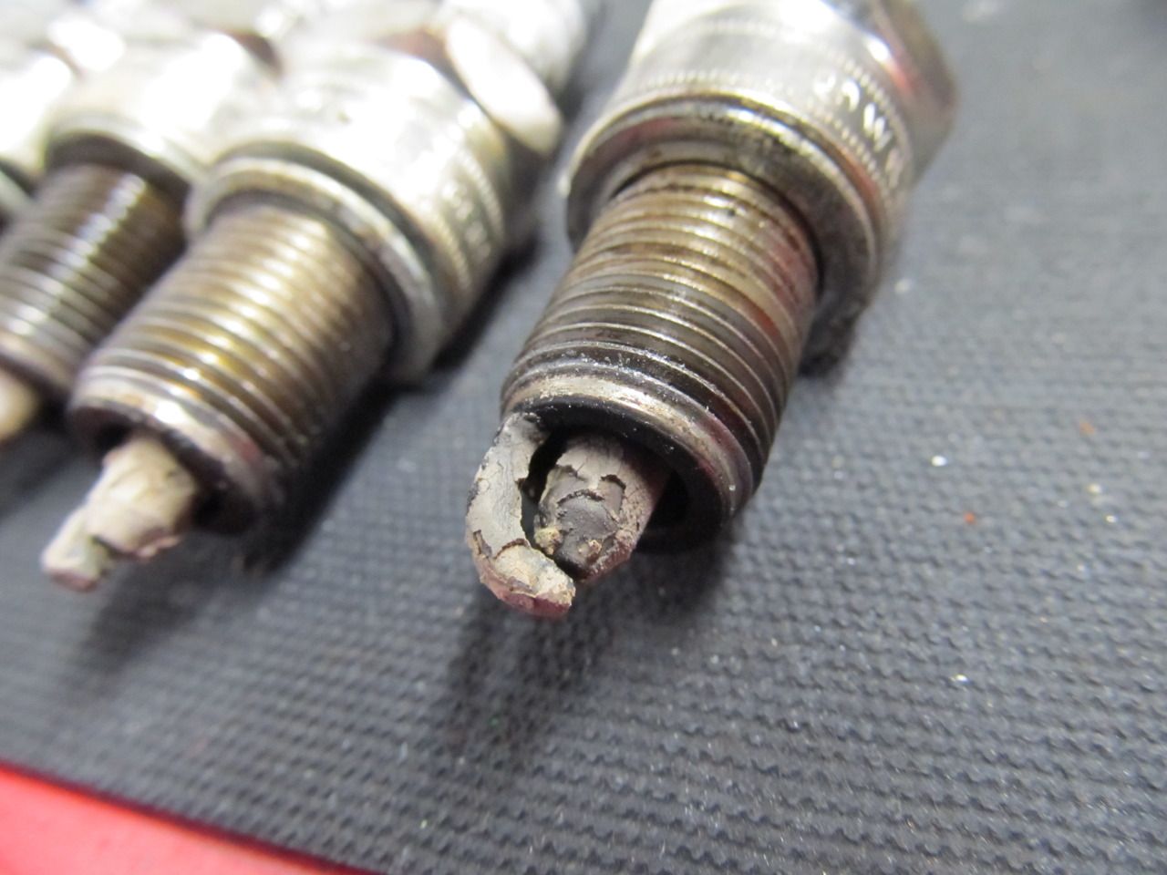

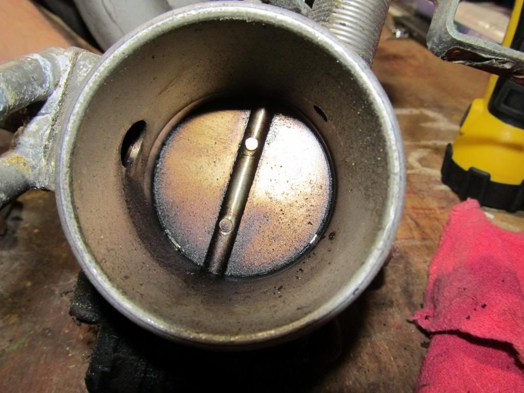

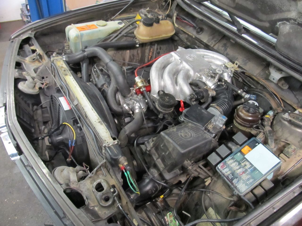

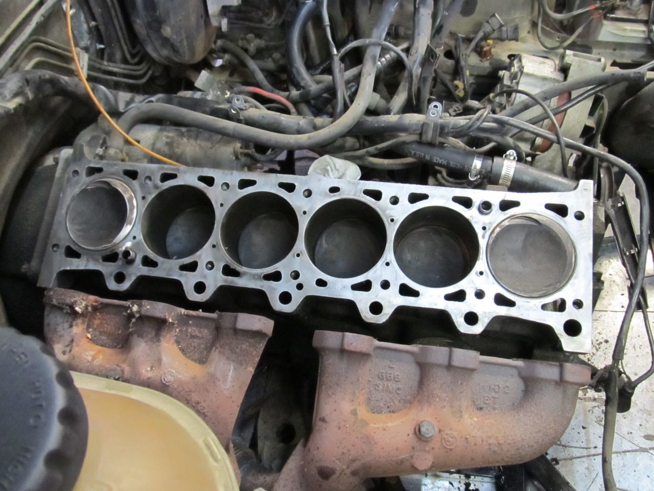

With two weeks left until the first race, it was time to install all the "i" parts and get this motor to make some power! Upon disassembling the motor, we discovered some problems:

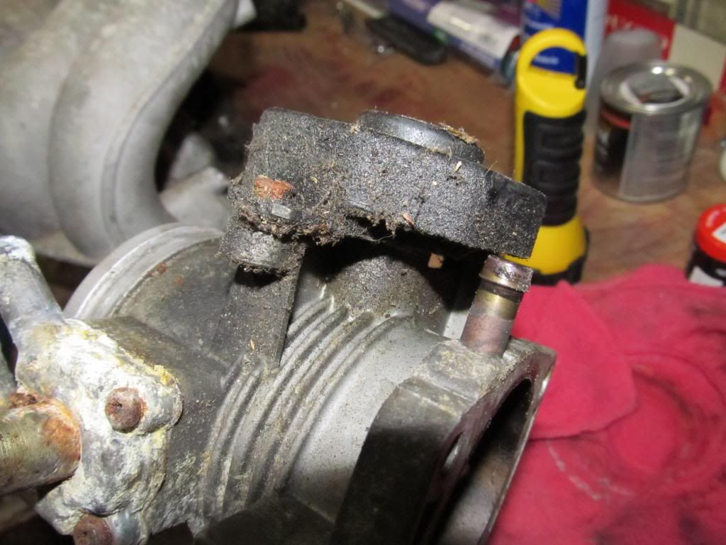

1. One of the spark plug boots wasn't properly seated. Most likely have been running on 5 cylinders
2. Our FPR was pretty much dead
3. The TB wasn't installed properly and wasn't seated
4. The spark plugs were disgusting
The old TB
Old plugs
New/rebuilt head

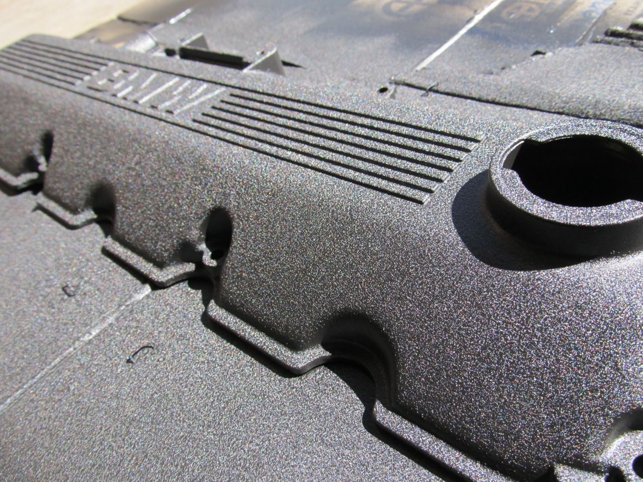

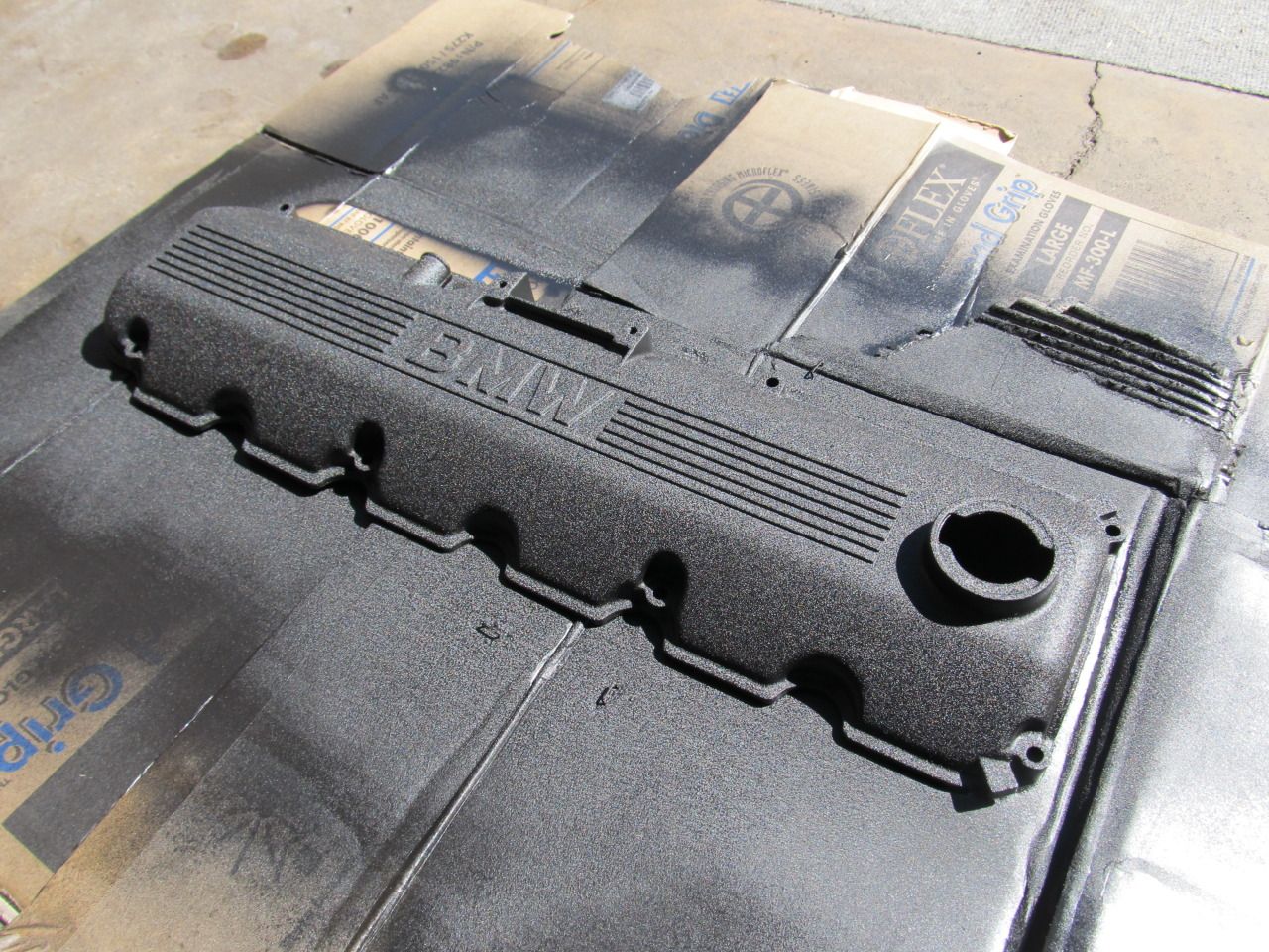

Valve cover before:
and after

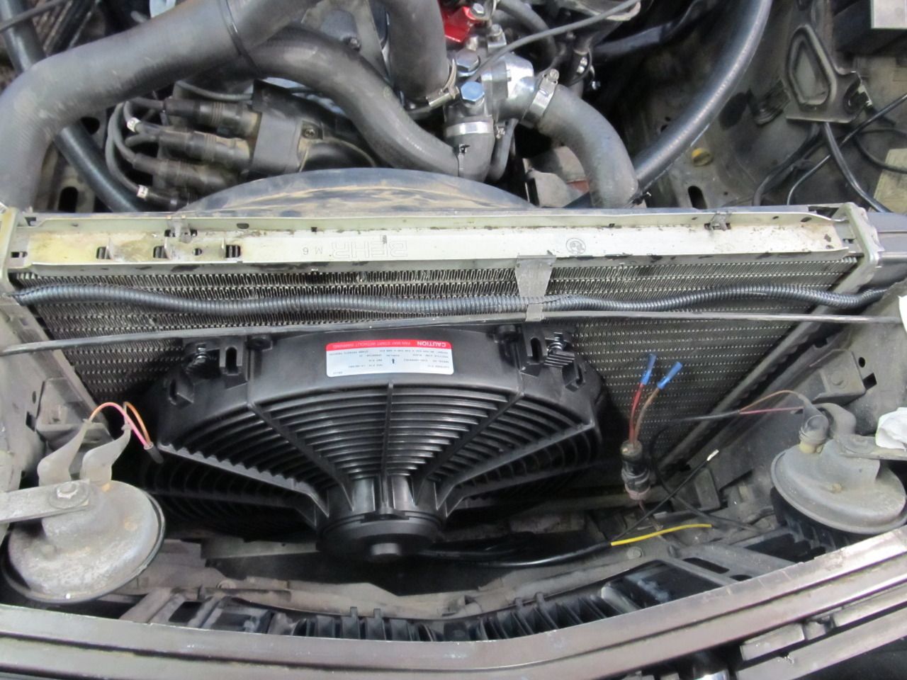

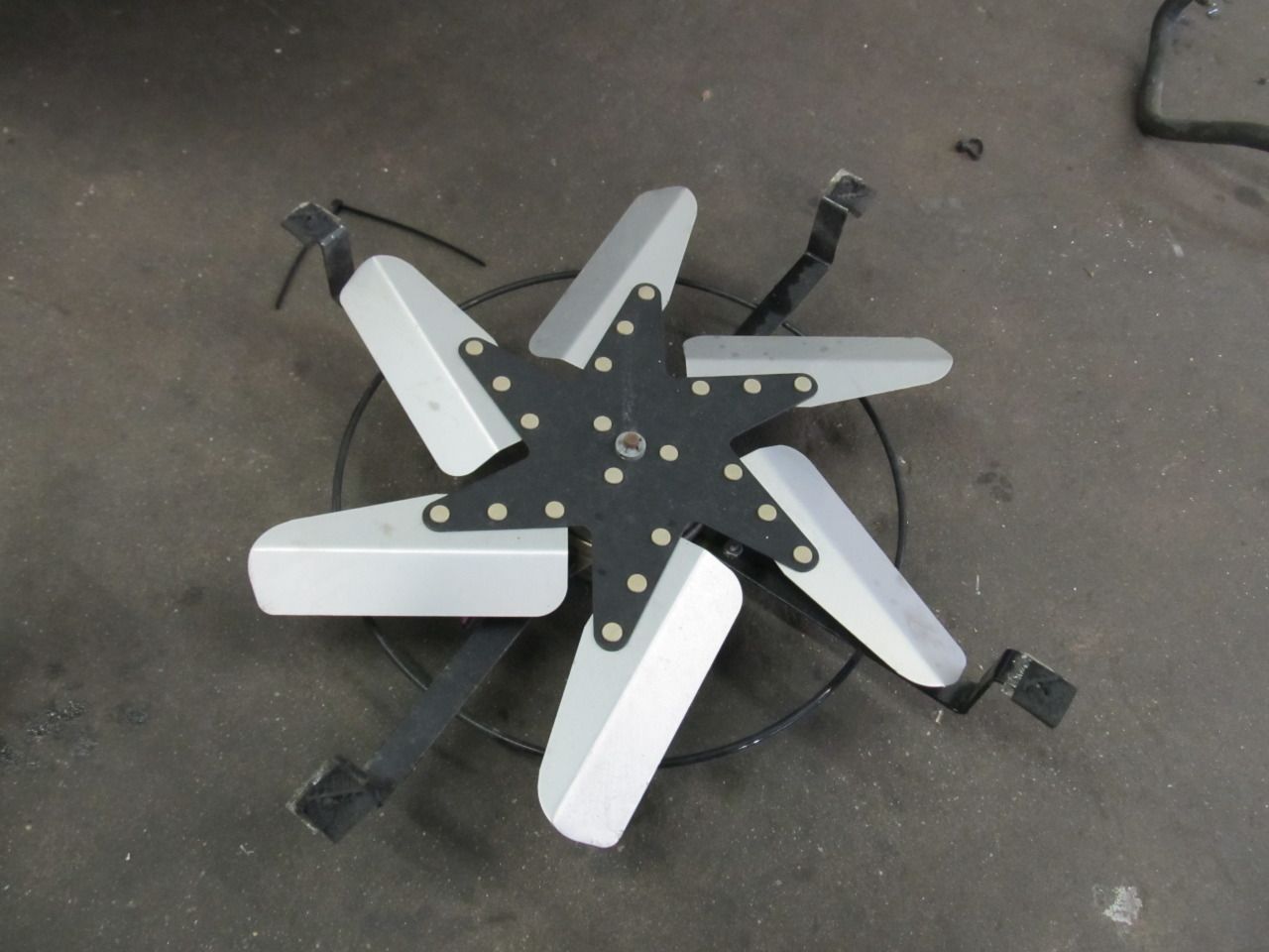

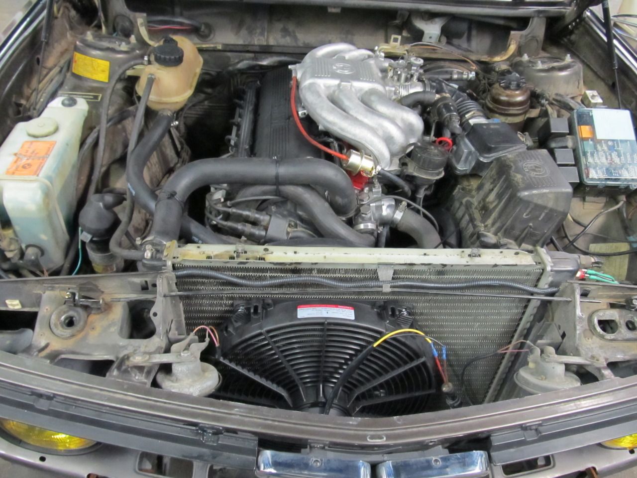

We also switched out our old dinky fan with bad bearings (blades wobbled) with this 16" unit from Advance Auto Parts. This thing really moves some air!
Old

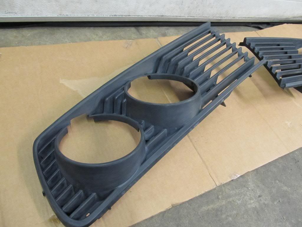

Painted these guys with some flat black paint we had lying around....

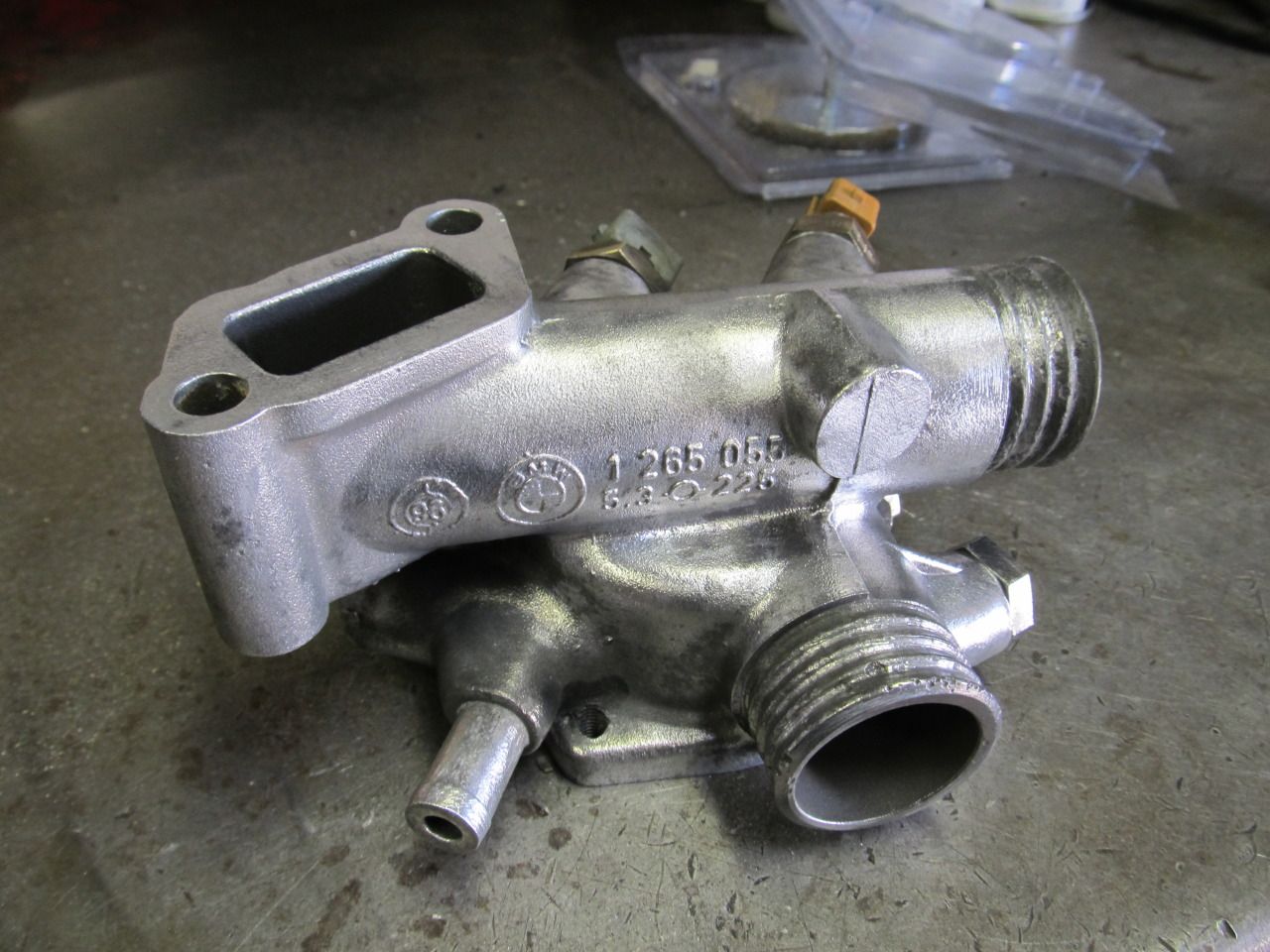

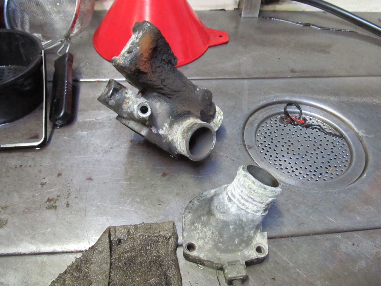

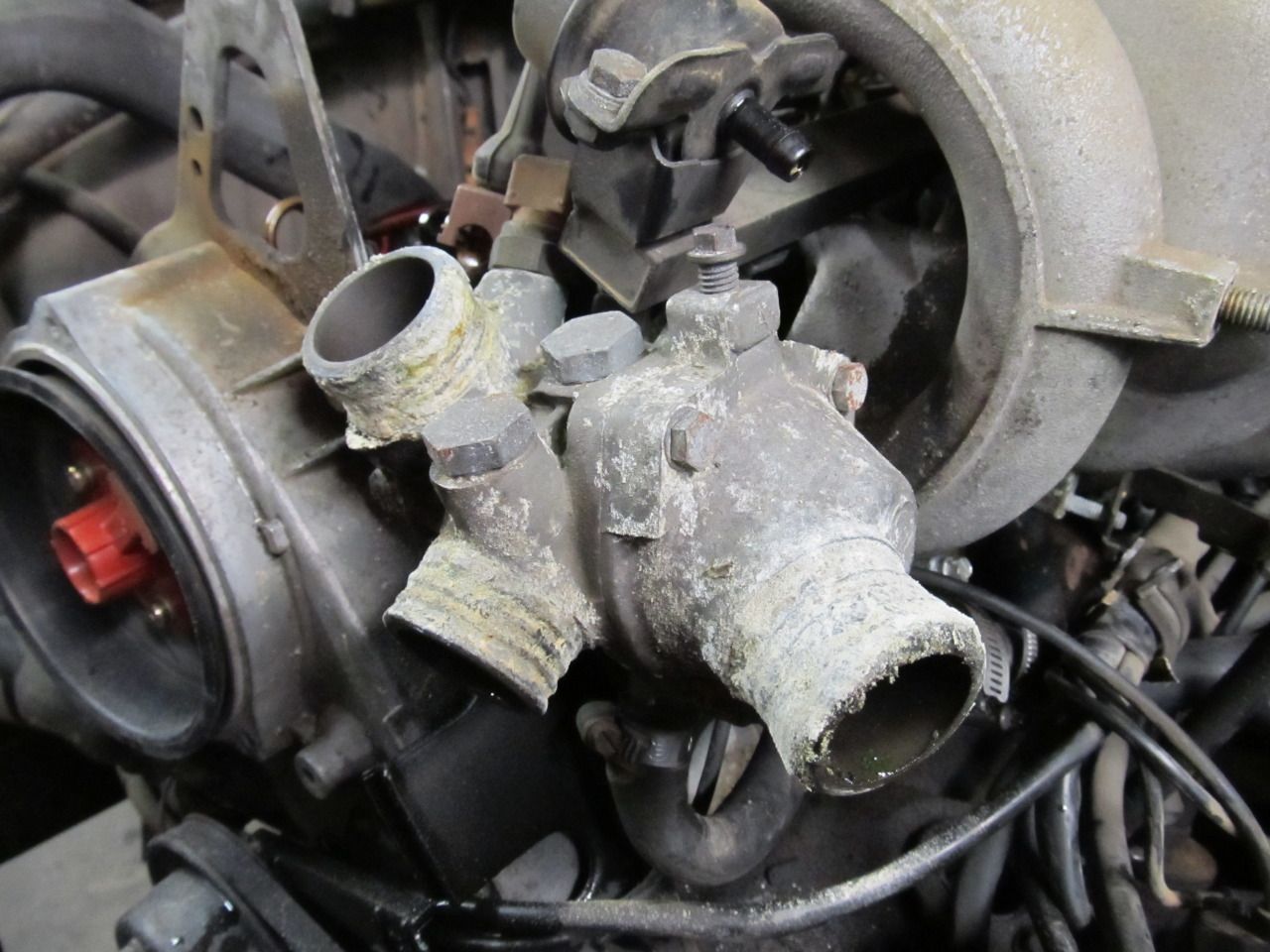

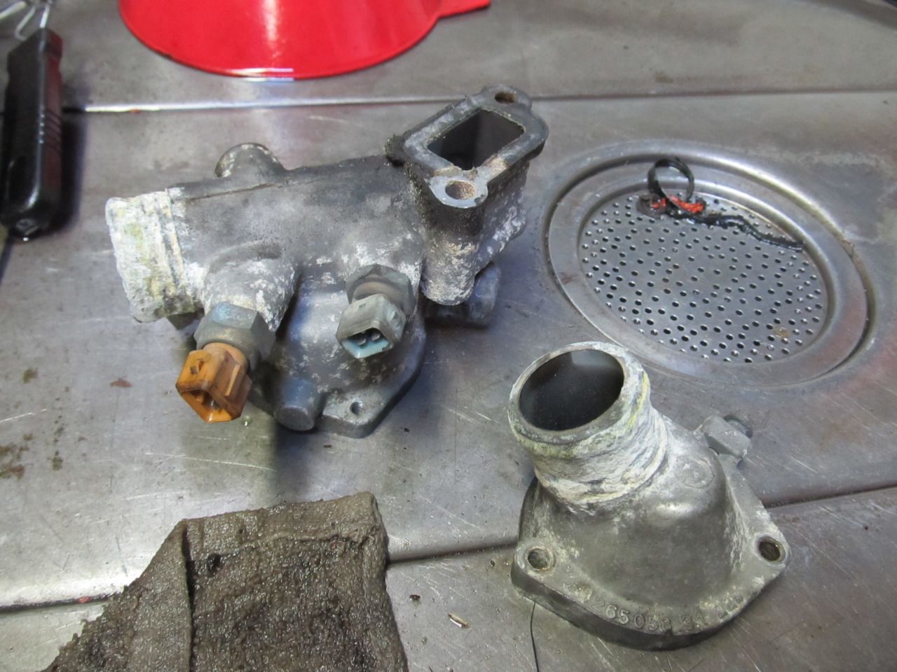

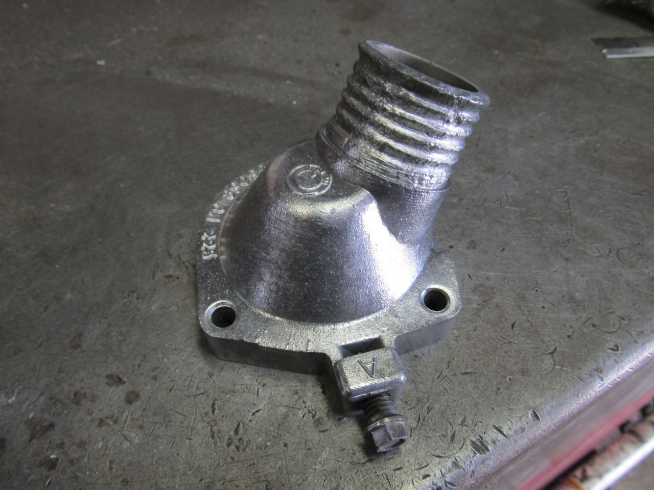

The thermostat housings were disgusting
95maxrider
Posts: 435
And after some time with the wire wheel

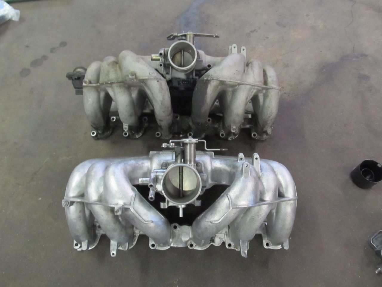

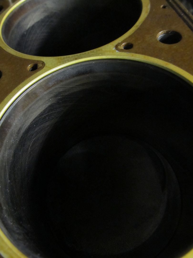

Also cleaned up the new IM. Here's a size comparison with the old eta
And the block...

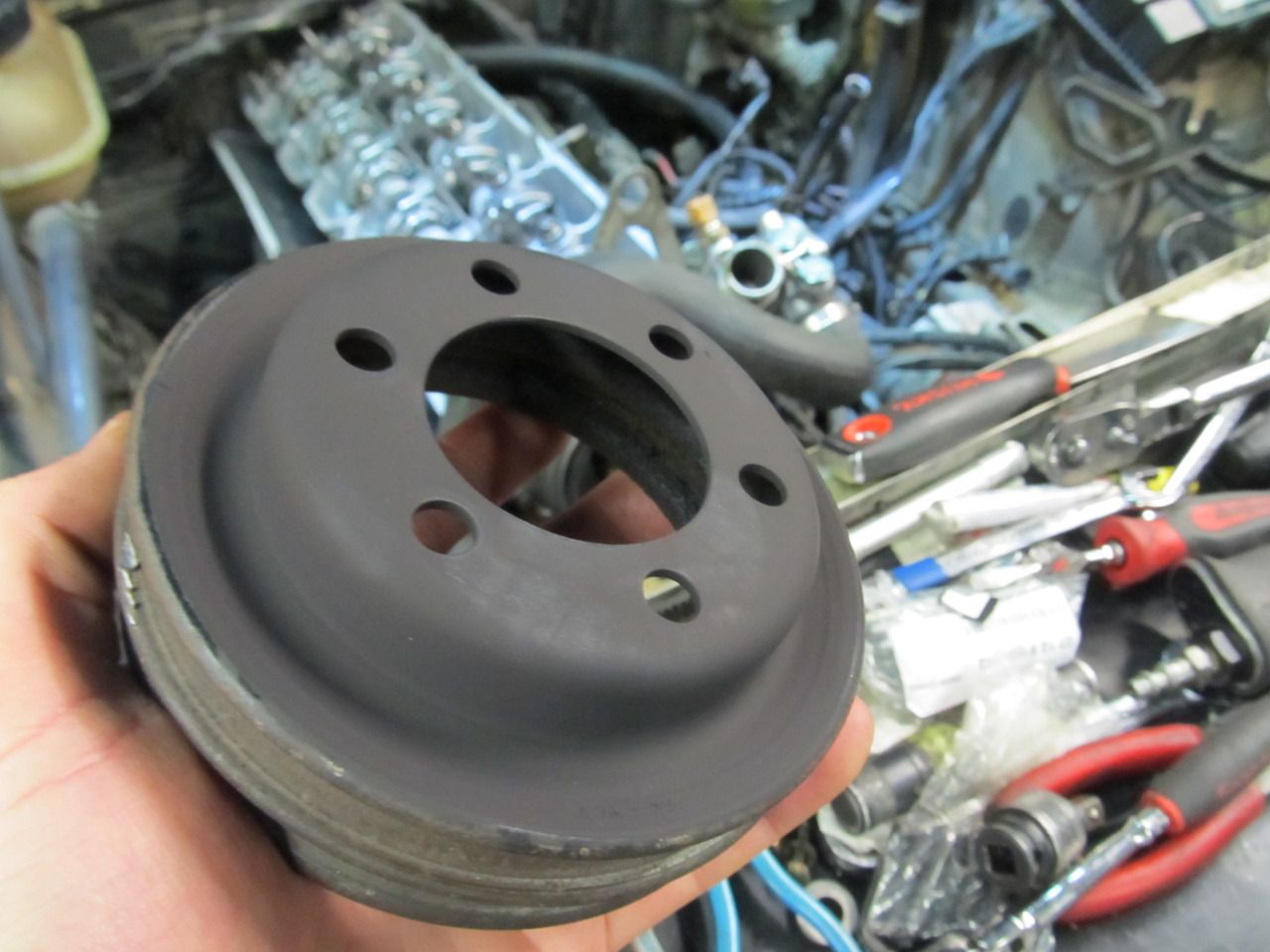

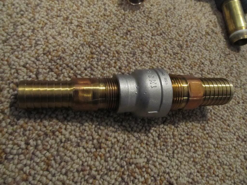

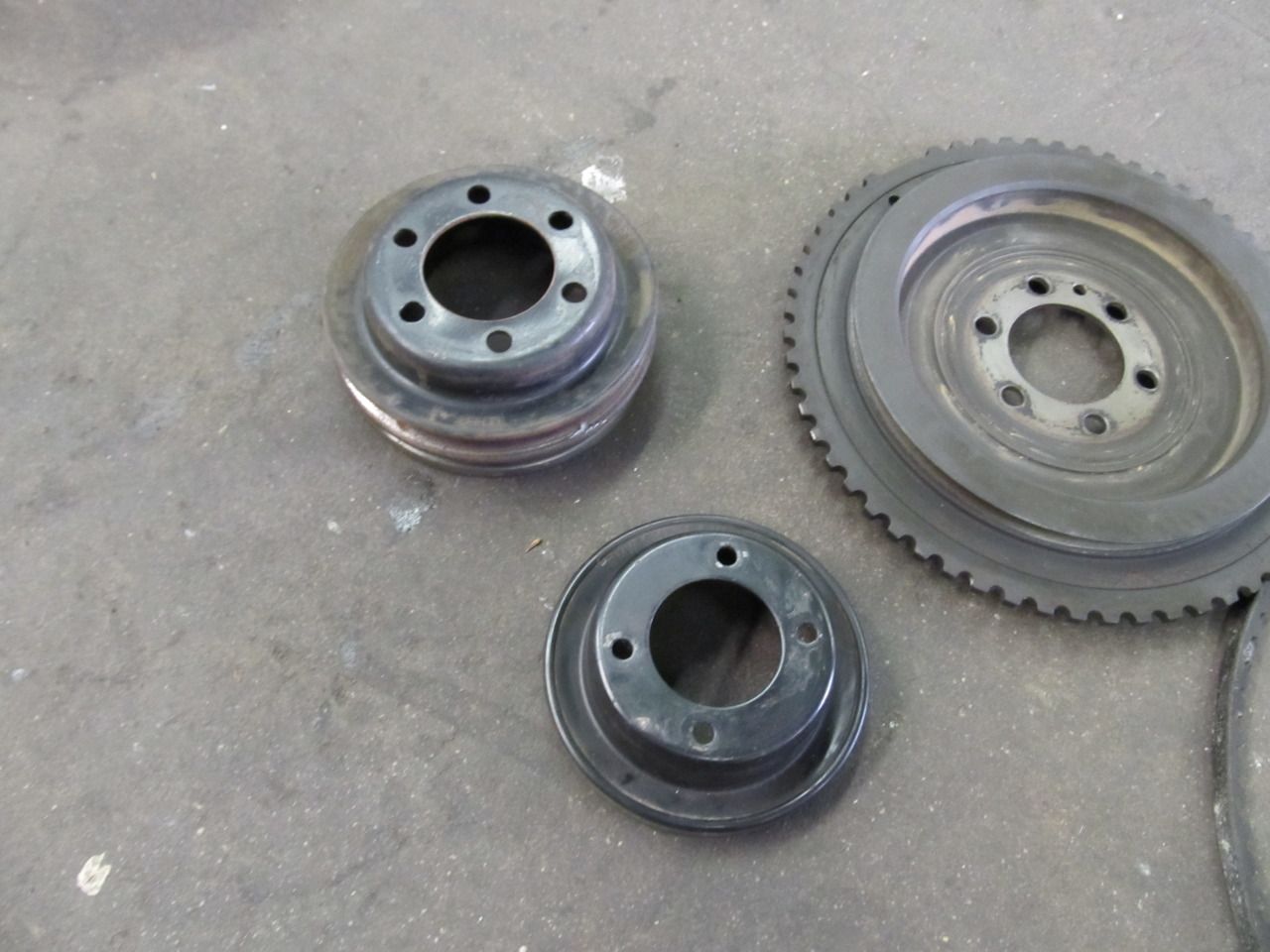

This is what we had to make to get the "i" water pump to work with our ETA radiator/overflow tank. I'll post more details later.
Installed (right, like it was just that easy...)

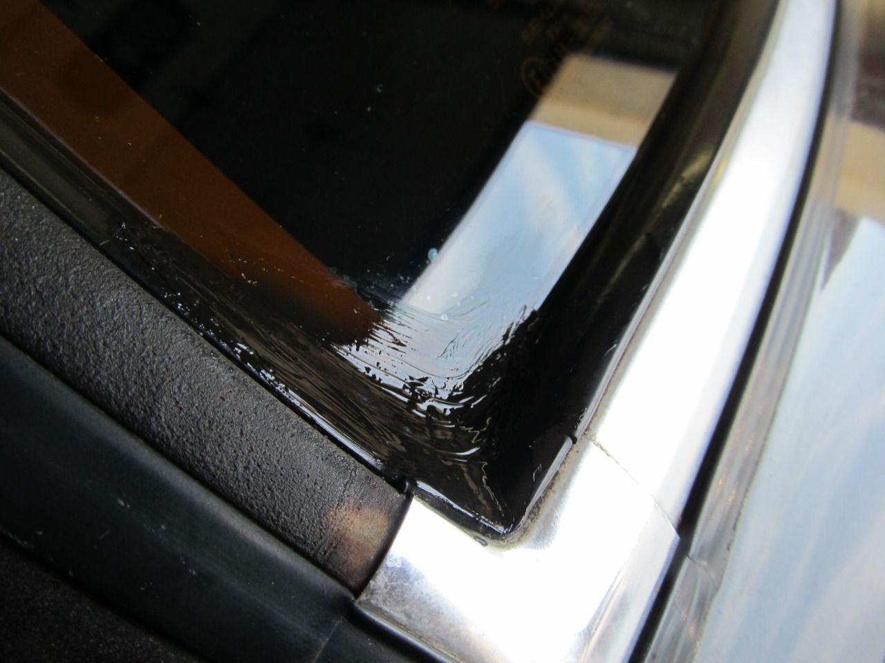

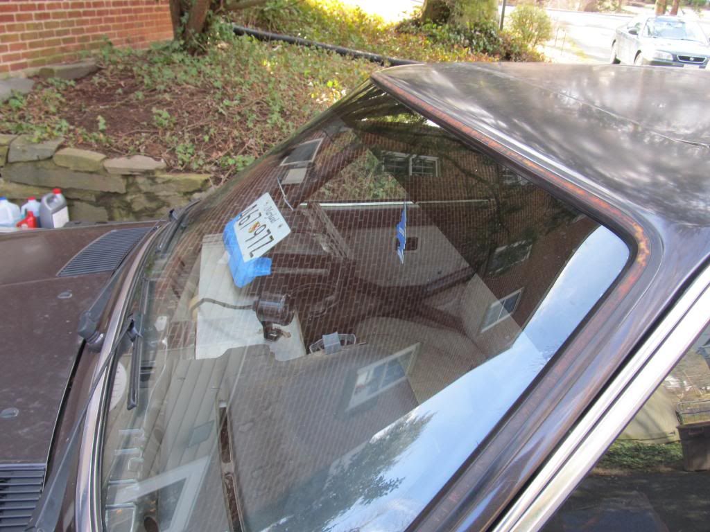

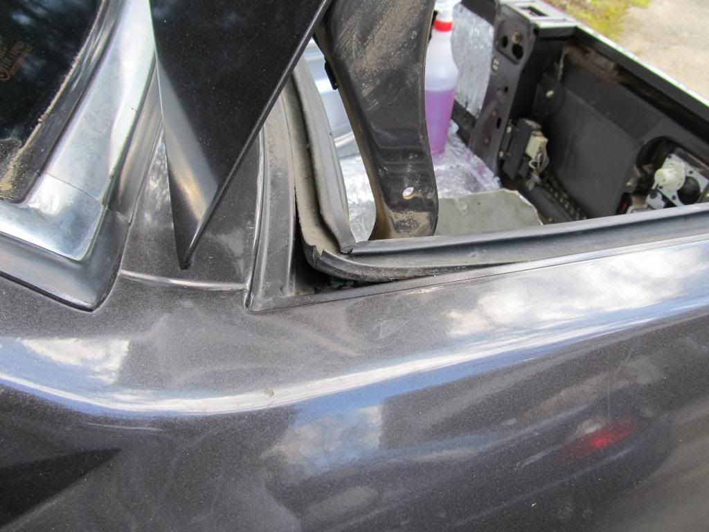

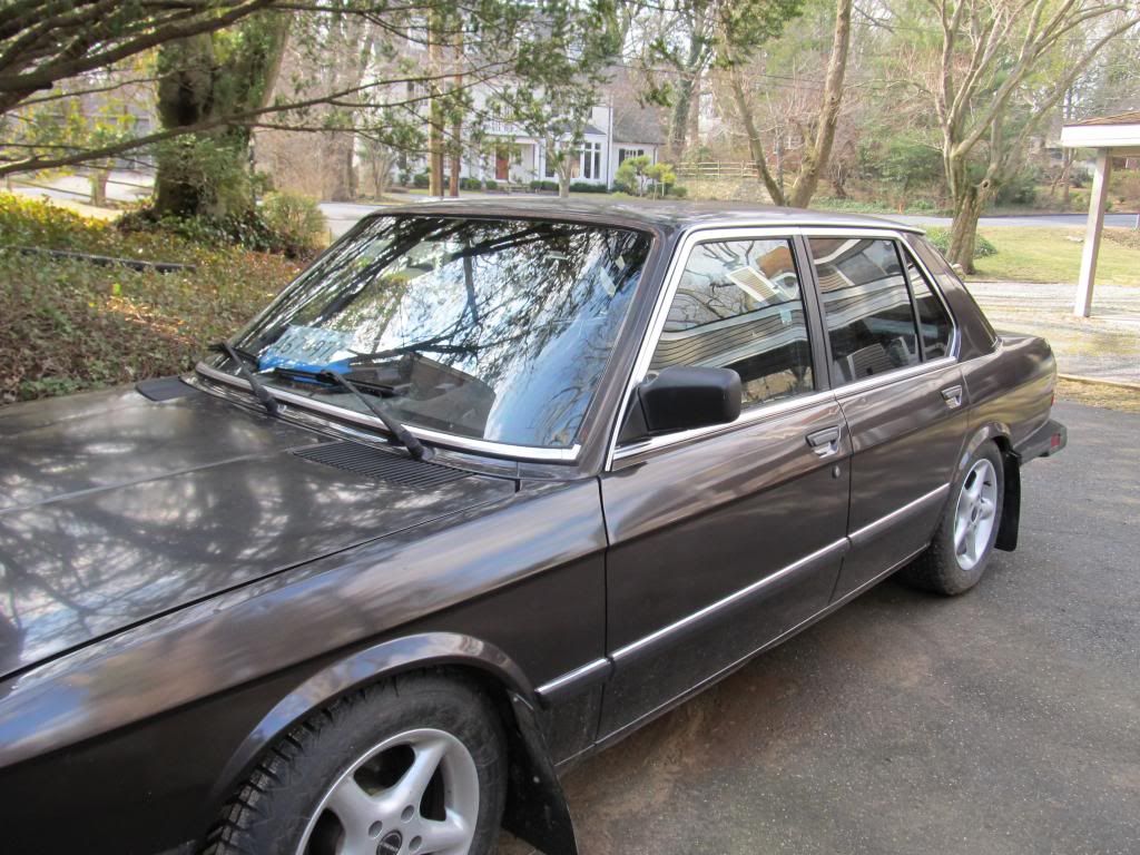

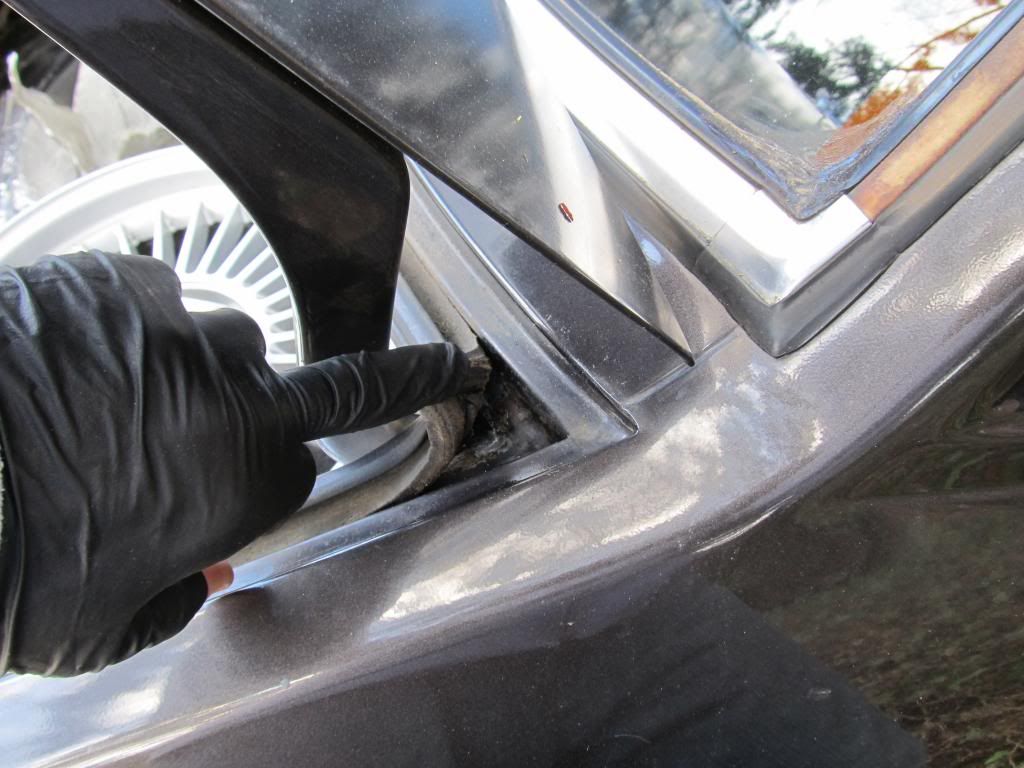

The car has had problems with rain leaking in at the corners of the windshield, so I decided to put some silicone down and see if it helps. The corners of the windshield have a pretty good curve to them, and water tends to pool there, so I wanted to build the area up a bit so the water drains better.
Front:
Rear:
Unfortunately, after yesterday's rain there was still a good amount of water in the car, so something is clearly still leaking. I'm considering doing the entire base of the windshield and seeing if that does anything, but if it doesn't I'm going to have to consider replacing the seal/windshield :( Thank god we don't have carpets, because if we did, we would have no idea the leaks existed.

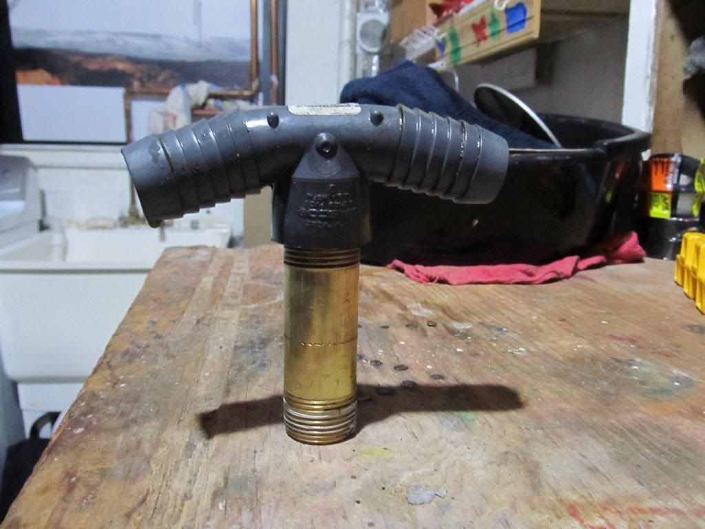

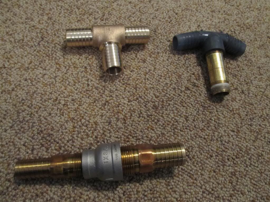

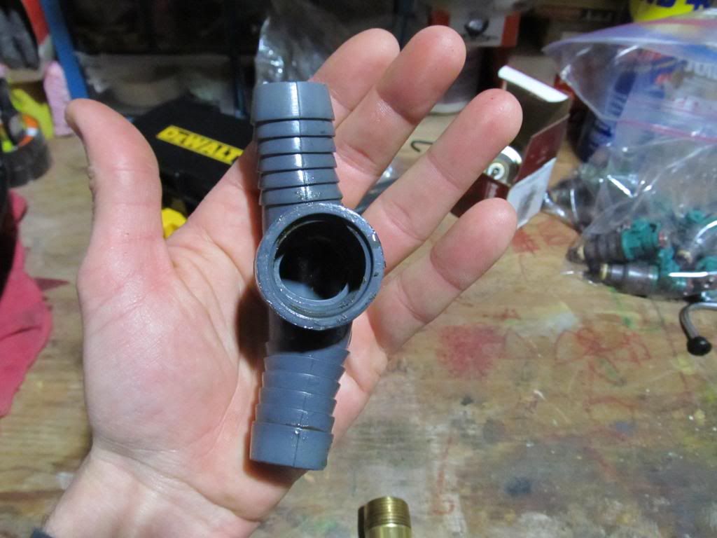

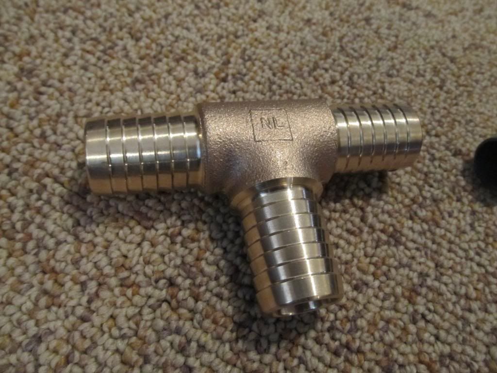

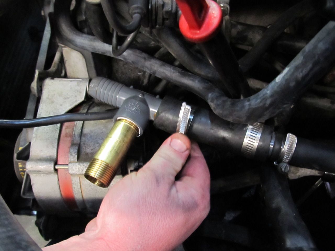

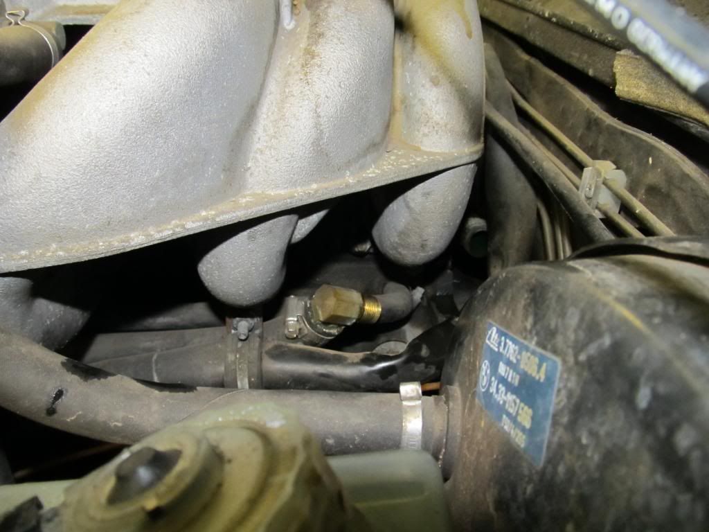

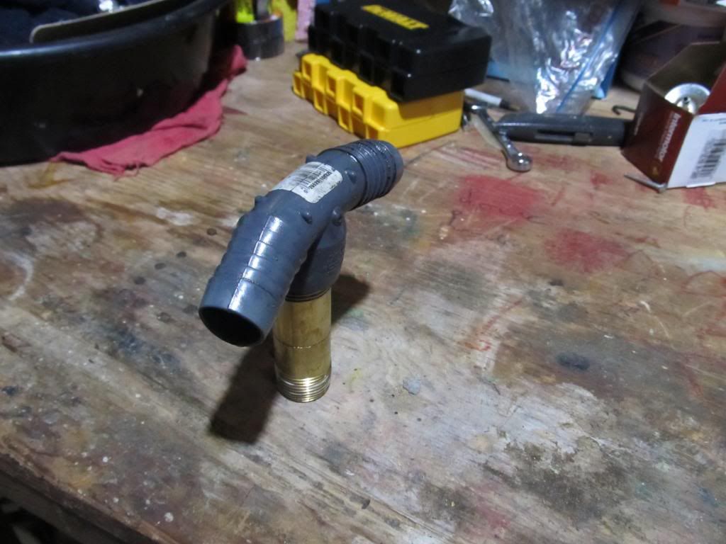

Well in working on everything yesterday we discovered what was at first a minor coolant leak at the tee we made to get the "i" water pump to work with our SETA radiator and overflow tank. Due to lack of parts available at Home Depot, we had to combine a 1" OD plastic barbed hose fitting with a threaded female section on the bottom with a 1" threaded metal pipe to go to the overflow tank. We checked the hose clamps and they were a little loose, so we tightened them up. It also looked like the metal section wasn't completely threaded into the plastic section, so I tightened it up with a vise grip. Unfortunately, this seemed to make matter much worse, and our intermittent drip became a steady trickle. Time to get a new tee!
This is what it looked like when we installed it:
And this is what our tee ended up looking like after about an hour of run time:
Not so good, this thing is supposed to be straight! Looks like the tension of the hoses bent it when it got hot, which would explain why tightening the metal part just made it worse since the threads weren't true anymore.
So we ran to the hardware store just down the street and picked up another plastic tee fitting, but this time we found one that was already a tee and didn't need a metal pipe. It's the same material was what we pulled out, and is really only in the car until we can find a metal one at a Home Depot or Lowes. Regardless, we got the new tee installed and there are no leaks. We drove the car around and it seemed happier than it did with the SETA injectors on the 173/351 ECU. I do miss the old low-end grunt of the SETA, but it sure is nice having power above 4000 rpm. I'm a little disappointed that we won't get to run with the 17lb injectors and chip this weekend, but we will live. More updates to come!

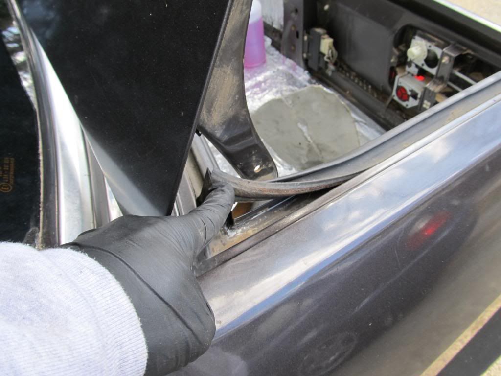

We also have water coming into the trunk and the corners of the rubber have come up and are slightly torn, so I cleaned up the area and applied a bunch of the black silicone in the corners and tried to rebuild the torn areas. I'm just now realizing I didn't take after pictures, but I can put them up later. Not much to see here...

The new plastic tee we put in a few days earlier had already started to collapse after 30 minutes of drive time. The new ones won't be doing that :)
Old vs. new
1" barbed brass tee
1" to 3/4" reducer

For your wet floorboards, check the sunroof drains; I bet you have a break somewhere inside the A-pillar or fender.
I'm about to put the head from an M20B25 on an M20B27, and have been thinking about the cooling system; the e34 donor car has the overflow tank attached to the radiator; any reason that same idea can't be used in the e28? I know there's little chance that the e34 radiator will fit the e28 out of the box, but when I get to that point I'm definitely checking fitment. Might work with some modifications.
Well our sunroof (or the edges of it) were filled in with silicone and the sunroof is no longer operational, so I don't think there would be any way for water to get inside from the sunroof.
I know very little about how the E34s do their cooling system, so I can't be of much help there. All I know is that we wouldn't have had that problem with the tee fitting if we had just bought the proper water pump to begin with. I was under the impression that all e/i water pumps were the same and it wasn't until the engine was mostly back together that we found they were different and didn't have time to to disassemble everything and put in an "e" pump.
Posts: 13960
Hmmm... I was under the same impression. I guess they are the same where they attach to the block anyway; hadn't noticed that extra hose barb. The Graf catalog bears that out though:
M20B27 pump (PA369) - - - - - - - - - - - - - - - - - - - - - - - M20B25 pump (PA243)
Image Image
I have a fresh eta pump on hand and was planning to use it, but may have to change that plan. Your solution to add the T would work, but at this point I'll probably just get the right pump & be done with it.

davintosh wrote:Hmmm... I was under the same impression. I guess they are the same where they attach to the block anyway; hadn't noticed that extra hose barb. The Graf catalog bears that out though:
If you already have a fresh ETA pump, why would you change your plans? My solution is a pain in the ass and cost more than it should have. Keep it simple!

Ok, I just did the stomp test and I'm not sure of how to read the results. As far as I can tell, the CEL blinked once short then once long, over and over again. I'm not sure how to read that/convert it into a code.
http://www.unofficialbmw.com/repair_faqs/motronic.html
This page has code info, but I don't know what to do with my info....ugh. Any help?
