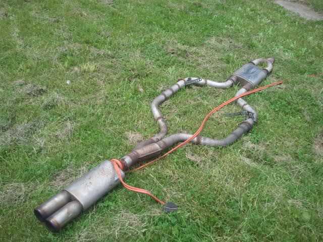

ahab wrote:Image
Manufacturer and Part # on that rear muffler? I want to replace my Magnaflow 12646 with something a little less tuner.
Btw I have stock B34 downpipes to a single 2.5" bullet cat to a Flowmaster 50 series to a Magnaflow 12646. It's similar to my old B&B in Db but doesn't have that vintage Euro sportscar sound I miss so much in the lower rev's.

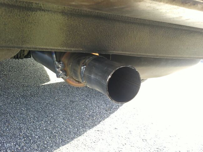

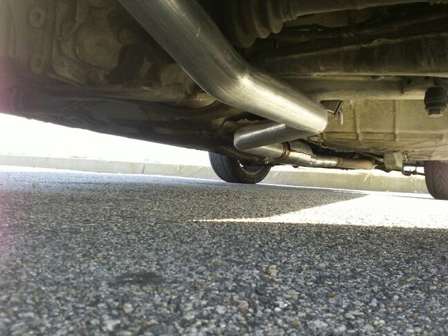

Shawn D. wrote:Dual 2-1/4" pipes are generally considered to be an ideal street setup for a hot-rodded Small-Block Chevy 350 – do you REALLY think your stock E28 engine is so hot that it needs larger (relative) pipes than that? :)
Joined: Jun 15, 2009
RAW!
Nice aluminum piping

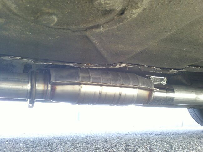

New cat and clamps make the system very serviceable and easy to remove for driveshaft work.

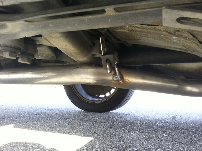

Leaving the body uncut... but with new custom hangers and rubber. This system is so solid, if you shake the exhaust by the muffler, you shake the entire car.
Magnaflow muffler and cat, no resonator. Stock headers. I keep promising a video but my phone sucked. I will try with my new camera sometime soon.
Info:
1988 528e
Cut just as the two pipes enter the cat. Junk the entire exhaust after that. Take the two header pipes and join them together into a single pipe 2.25" into a single 2.25" universal hi flow cat. Continue to run 2.25" pipe all the way back to a 2.25" Magnaflow round body muffler.
Cat info here: http://www.amazon.com/Magnaflow-94006-U ... 267&sr=1-3
Magnalow muffler info here: http://www.magnaflow.com/02product/disp ... mber=10415

Does the C clamp ever leak?
So the stock downpipe is hung at the trans?

I paid $131 for parts and $325 for the install. The shop supplied the piping and hangers. All I gave them were the muffler and cat.
The c clamp does not leak. Otherwise I would have been raising hell and they would be fixing it!
