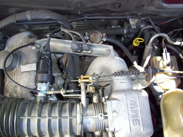

If there is no selector knob on the shifter trim, it's a non-EH, as all US '85 e28 models with an auto trans were. Also, under the hood, on the throttle linkage, there will be three cables instead of two. The third one is the downshift cable for the non-EH transmission.

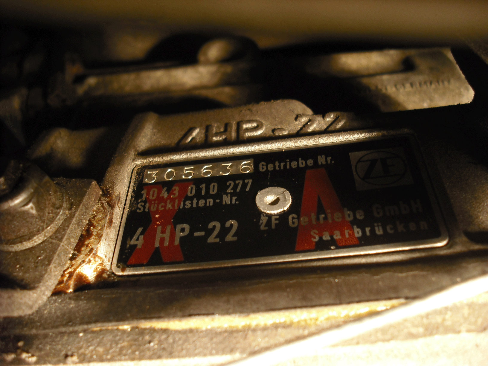

also you can check the label on the drivers side of the tranny for more confirmation.

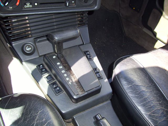

Thanks for the replies, I really appreciate it. The car has been in the family since 1986 and don't think the trans was swapped. It's just been a dependable daily driver. Other than the power window buttons and auto shift selector there are no other knobs/buttons on the console. There's no sport, normal, or eco knob/button. Real OEM shows that's it's a 4HP-22/H. I will look for the cables and try to find the label on the driver side.

No knob = non-EH
No need to dig any deeper than that.
n00dle
Posts: 68
Joined: May 18, 2010
Post by n00dle »
Tried to locate the label from the top without success. I suspect I need to look from underneath the car for it.
Got a couple of snap shots of the selector and cables.
As I said, no knob and 3 cables = non-EH.
