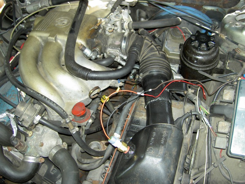

The MS is connected to a 35-pin Bosch connector, early version of the harness seen here:
Only the wiring for the VR sensor and IAT was run separately.

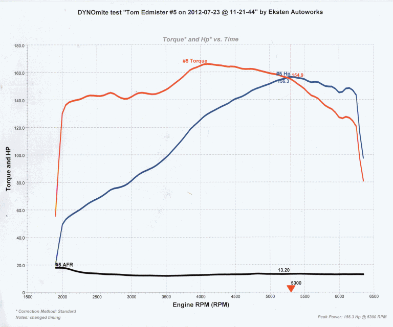

Dyno:
There was a modest power gain. But the VE table needs more work, as it was too rich at 3500 for instance. I have picked up a few mpg with MS, managed to hit 30mpg highway. Tables used for the dyno run:
