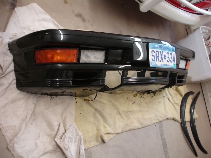

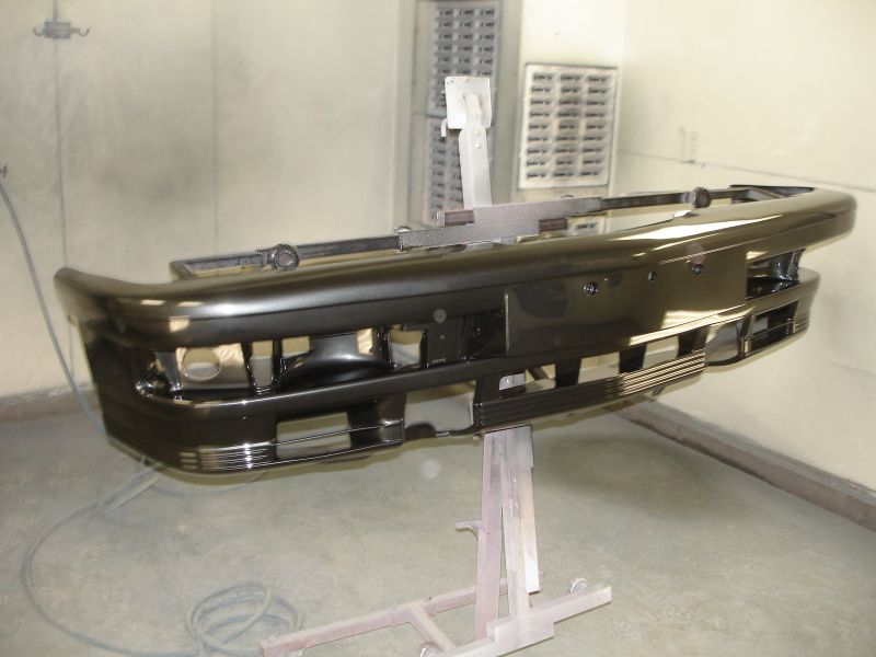

Slowly it's coming together...here's the front bumper cover, just about ready to go. It's mostly buffed out but they will work on it a little more after it's bolted onto the car. There's a couple of the fender flares on the right side of the photo as well.
I have new turn signal and foglight lenses on order from The Parts Department, so don't worry about that cracked one in the pic.

stuartinmn wrote: Image
I'm worried about their professionalism if they just masked off that license plate!

Kyle in NO wrote:I'm worried about their professionalism if they just masked off that license plate!
No worries. :)

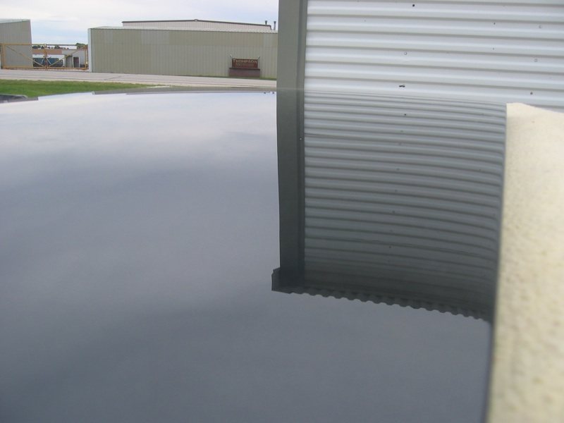

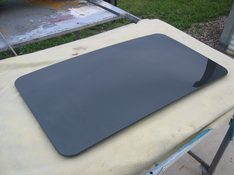

Just a couple more photos. :) The car itself isn't in the paint booth yet; they have one more round of block sanding and then it should go in this coming week.
These are pictures of the sunroof, which has been painted, wet sanded and buffed. The second photo shows the nice straight reflections of the building in the background.
Jeez that is going to be a NICE paint job.

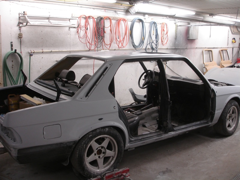

Well, no paint yet but this week for sure. :)
They've removed the doors, hood and trunk in preparation for the color. They'll first paint the door jambs and back sides of the removed pieces, then reassemble the car and paint the exterior, then remove everything once more to apply the clear coat. Then, it will be time to color sand and buff everything before final assembly.
This will be the last photo of the car in primer.

Why didn't they remove the rear seats, or why didn't you? What was the reason for removing the fronts but not the rears?
Posts: 9522
The front seats were removed so the carpet could be pulled out, so they could patch the rust in the floor pan. There wasn't any reason to remove the back seats, other than to keep them clean (in retrospective that probably would have been a good idea, but they're just dusty so it's not a big deal.)

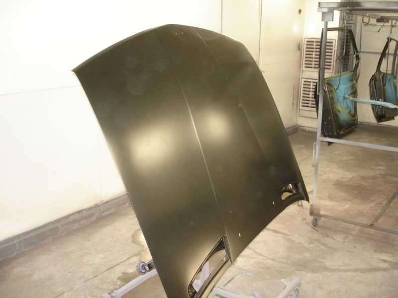

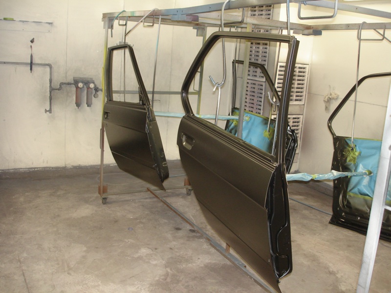

The car went into the paint booth today. I haven't received photos of the painted body yet, but I do have a couple of the doors and hood.
They first put one coat of color on the doors, hood and trunk, then one coat on the body, then the doors, hood and trunk get put back on the body and everything gets a couple more coats of color. After that, they blow it apart one more time and clear everything separately. The color should have been completed today, with the clear coat going on tomorrow morning.
The doors and hood look dull in these photos, but that's because it's just the base coat on there - once the clear coat is applied they'll be nice and shiny.

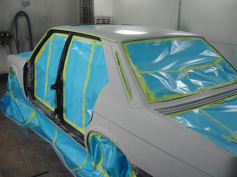

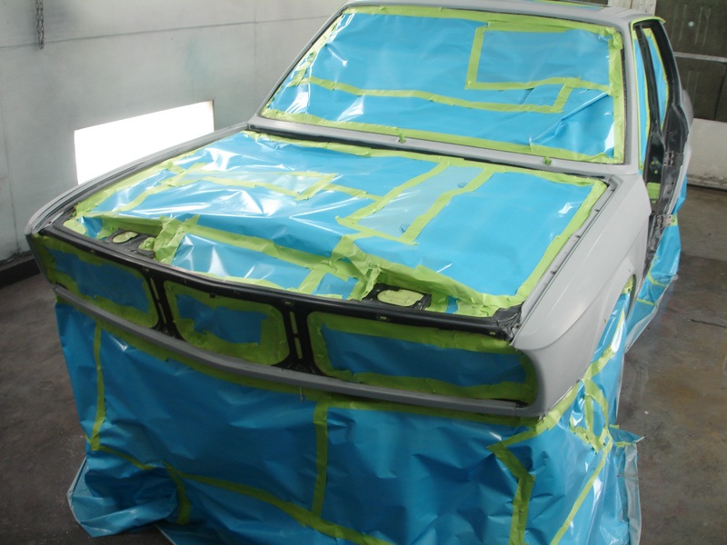

Here's the body, all masked and ready to go. The door jambs didn't get stripped back to bare metal like the rest of the car was - since they had no rust and no damage, they were simply scuffed and wet sanded in preparation for the new paint.

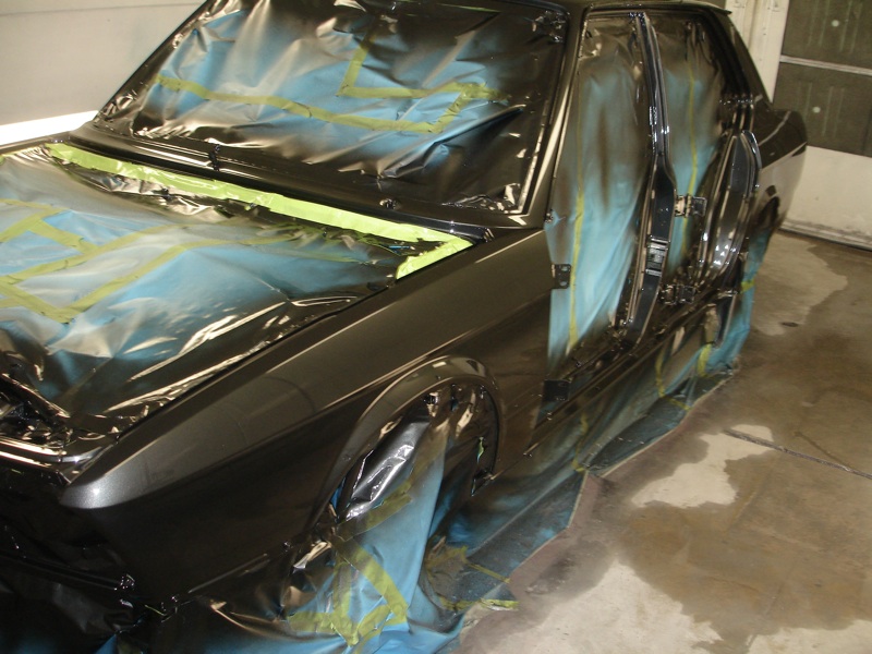

Posts: 9522

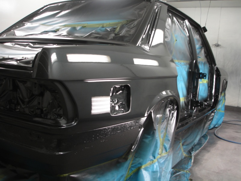

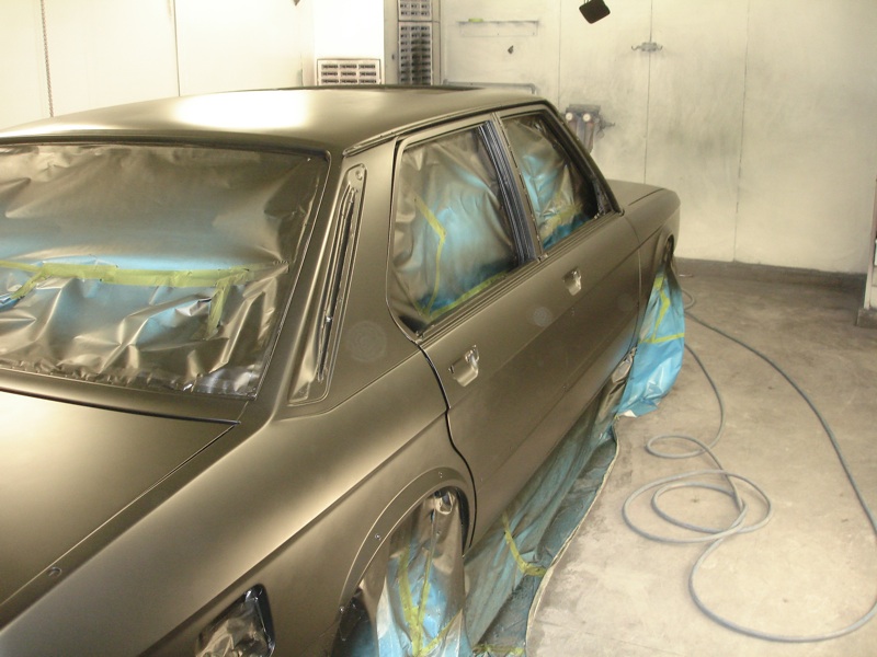

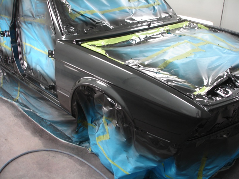

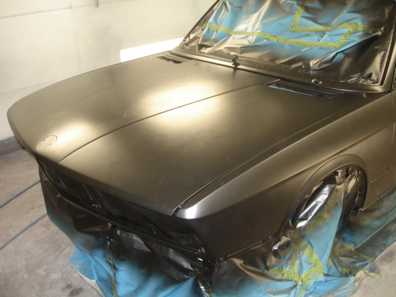

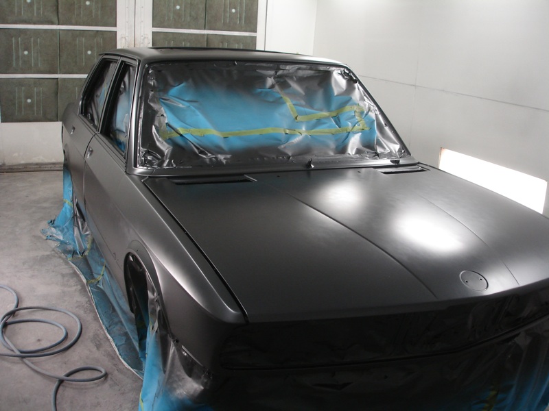

Here are the pics. :banana:
Base coat applied:

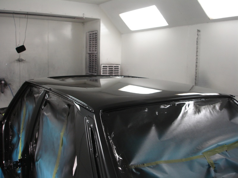

Clear coat:
They first put on one coat of base with the doors, hood and trunk removed. Then they were reinstalled and two more coats of base were applied. Then, it was blown apart again to clear coat everything separately.
After the paint cures, it's time for color sanding and final buffing, and then final assembly.
