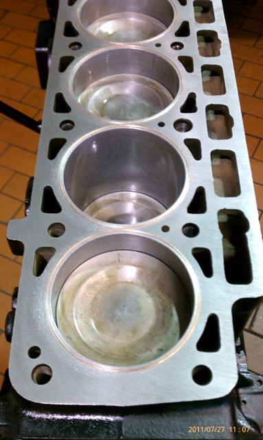

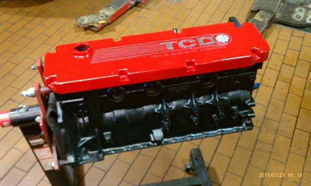

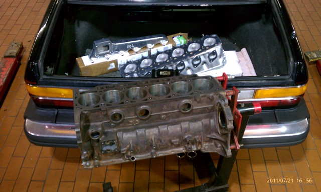

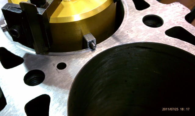

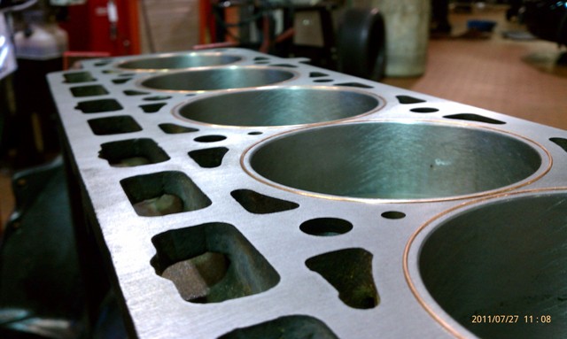

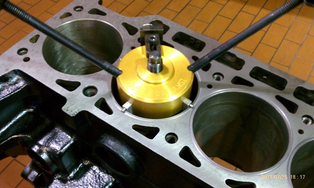

I just got all my parts back from the machine shop.
Ali's engine has been torn down, hot tanked, decked and honed. I had the TCD mani ceramic coated this time around. With the help of Paul B. I had b35 valves cut into the b34 head and also had the head planed. The new Paul B. cam is waiting in the box ready for installation.

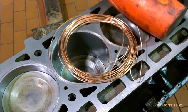

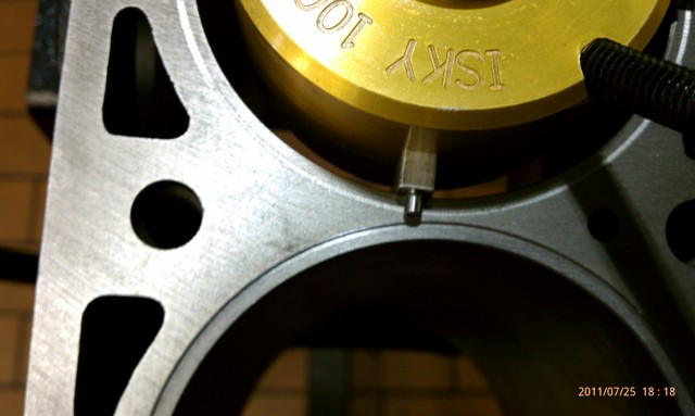

Glad to see it's being put to good use. Can't imagine why anyone would build a forced induction motor without first taking this precautionary step. Some people must enjoy replacing head gaskets.M. Holtmeier wrote:Oh yeah, forgot to mention that. Got the Isky Groove 0 Matic through the Moosehead Engineering tool rental program.Lurker27 wrote:Boss. O-ringing the block while it's out?
The MLS is very reliable in the hands of a competent builder. I just saw an e24 I built 6 years ago at Tedfest, Left the shop with a 1 bar spring and has not been touched since.Murfinator wrote:Glad to see it's being put to good use. Can't imagine why anyone would build a forced induction motor without first taking this precautionary step. Some people must enjoy replacing head gaskets.M. Holtmeier wrote:Oh yeah, forgot to mention that. Got the Isky Groove 0 Matic through the Moosehead Engineering tool rental program.Lurker27 wrote:Boss. O-ringing the block while it's out?
I have personally only had one go in 7 years and it was due to a cracked b35 block.
