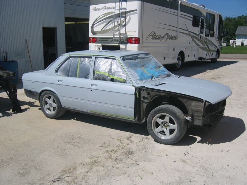

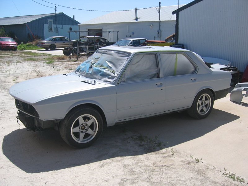

I stopped down to the body shop today, the body work is done and the car is in primer. :banana: They're going to let it sit out in the sun for another week or two, to make sure the primer is fully cured, then it will go through a couple rounds of block sanding before the color starts going back on.

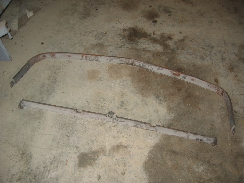

This is interesting...when this car was Federalized back in 1986, here's how they reinforced the bumpers:
These are two great big pieces of strap iron, bent and welded to roughly follow the shape of the bumpers. They weigh a ton, and look like something off a piece of farm equipment.
They were installed in place of the normal rubber trim on euro bumpers, with the Mtech bumper covers over the top. They're not going back on the car. :)

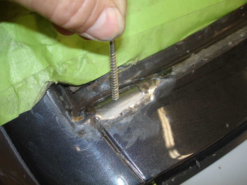

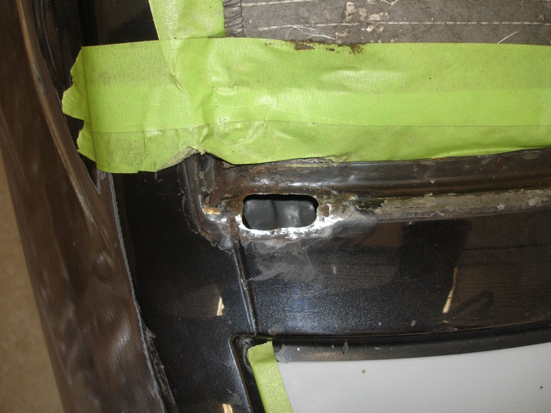

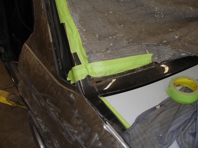

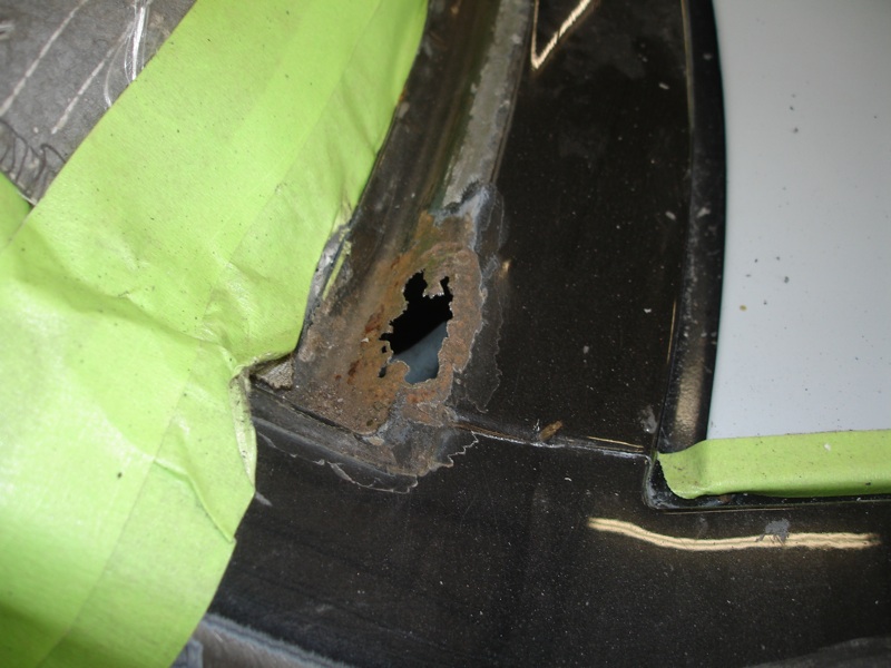

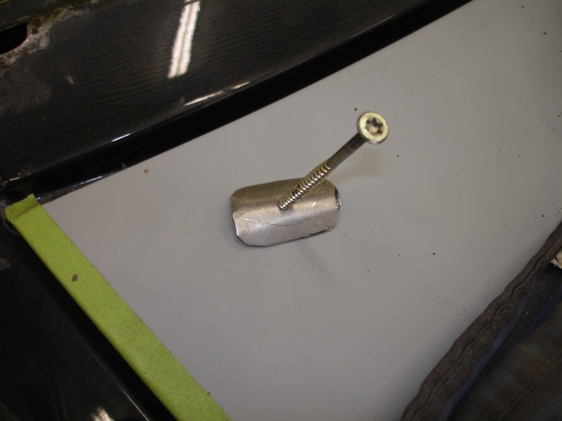

Here's a series of photos showing the rust in the lower left corner of the rear window channel, and how it was repaired. The interesting thing here is that before the paint was stripped off, all that was visible was one small bubble that was maybe 3/16" in diameter. It turned out to be a little bigger than that...
There were similar rust spots by the left taillight, as well as in the trunk lip. Both those spots were repaired in a similar manner.

That is similar to my 533's back window, but my car is so shot, it just got a gob of silicone :rofl: Neat to see how it's actually repaired though!

You are wise to rid your car of those hideous pieces of iron installed inside the bumper covers during federalization. Its amazing how different the various shops performed that "strengthening" process.
I discovered mine on the inside of the rear bumper cover recently when I had it off for paint - it also weighed a ton.

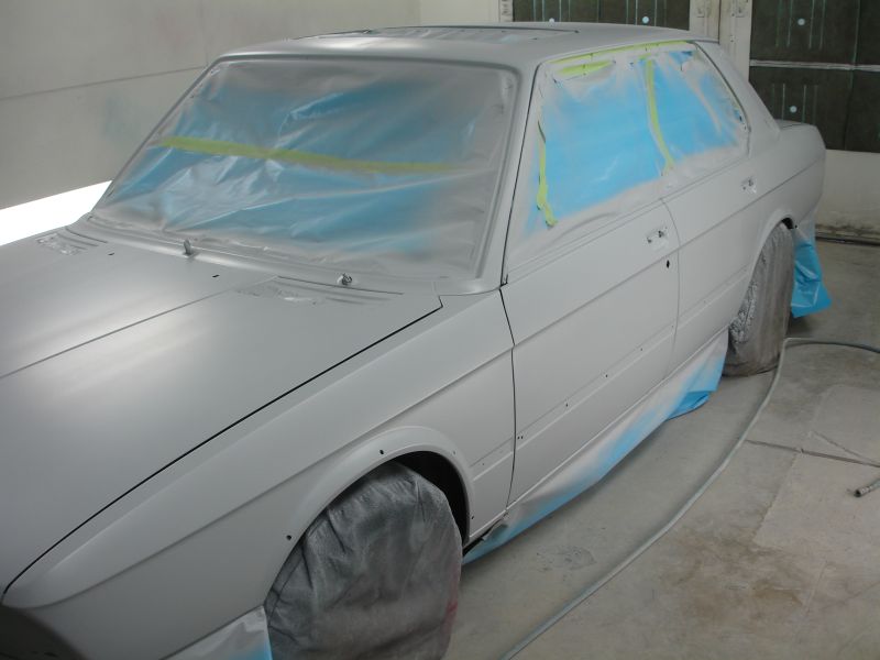

Posts: 9522

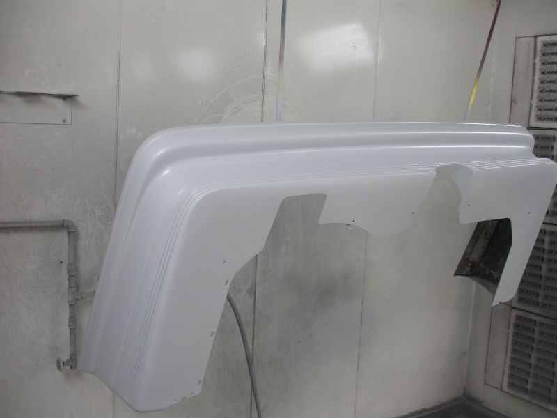

Getting closer...the block sanding is done, and the final primer coat went on today. Another week for the primer to cure, and then it's time to start squirting on some color. :banana:

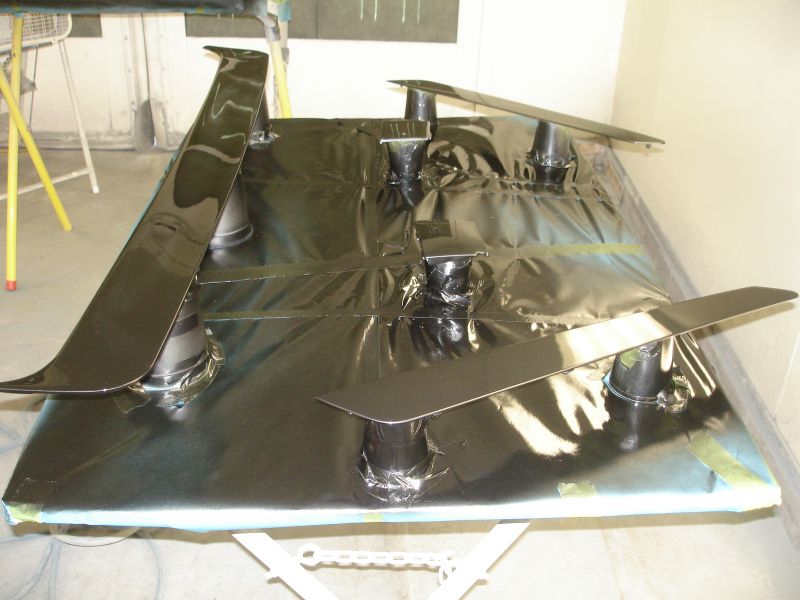

Posts: 9522

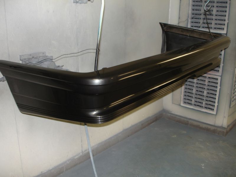

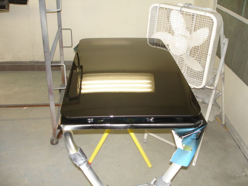

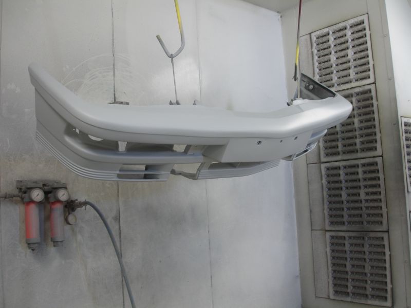

They're starting to paint things! :banana: They haven't rolled the car itself into the booth yet (although that may happen today) but there's finally some color going on the various bits and pieces.
