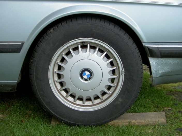

maybe you are referring to these?
205/60/15 will fit fine (tire in my pic is 215/60/15). Four wheels and four tires for $250? If the tires look like they have enough tread depth to be useful in the snow then I would think it`s a fair price.

12valves wrote:maybe you are referring to these?
They aren't those. They are definitely Style 6s... from the 1992-1994ish (not exactly sure when they stopped selling them) E36 wheels commonly found on the 4-doors. Like this:
