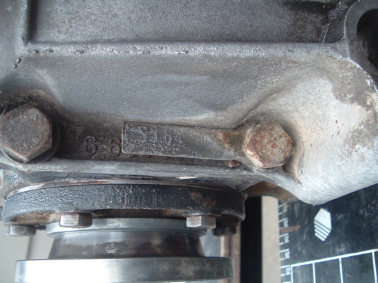

Yeah, read the tag affixed to the diff cover.
Posts: 13965
What Kyle said. They look like this...
This one is a medium-case diff from an e32*, but the tags on the small diffs are similar.

Wow thats unbelievable! Can't wait to look. Last time I was changing gear ratios was a Ford 9" rear end, back in highschool. Even if there was a tag, you'd never assume it was right.

davin, do you know what the stock ratio is for the e32 5 speeds? I've got a lsd, but no idea on ratio. tag is no good.
86GT635 wrote:davin, do you know what the stock ratio is for the e32 5 speeds? I've got a lsd, but no idea on ratio. tag is no good.
3.64

I finally looked under the two cars, and had a nice surprise. The driver has 3.25, and the junker has 3.46. Does the "S" mean anything?
Thanks again
Shawn D.
Posts: 22379
Location: Alpharetta, GA
Post by Shawn D. »
malgyver wrote:Does the "S" mean anything?
It means it's limited-slip.
