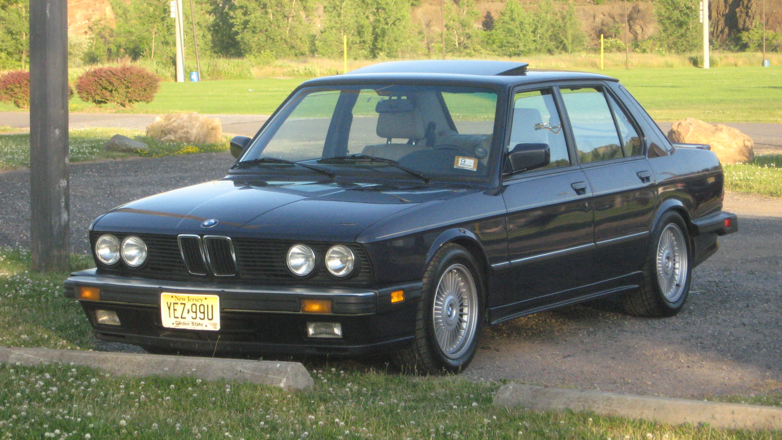

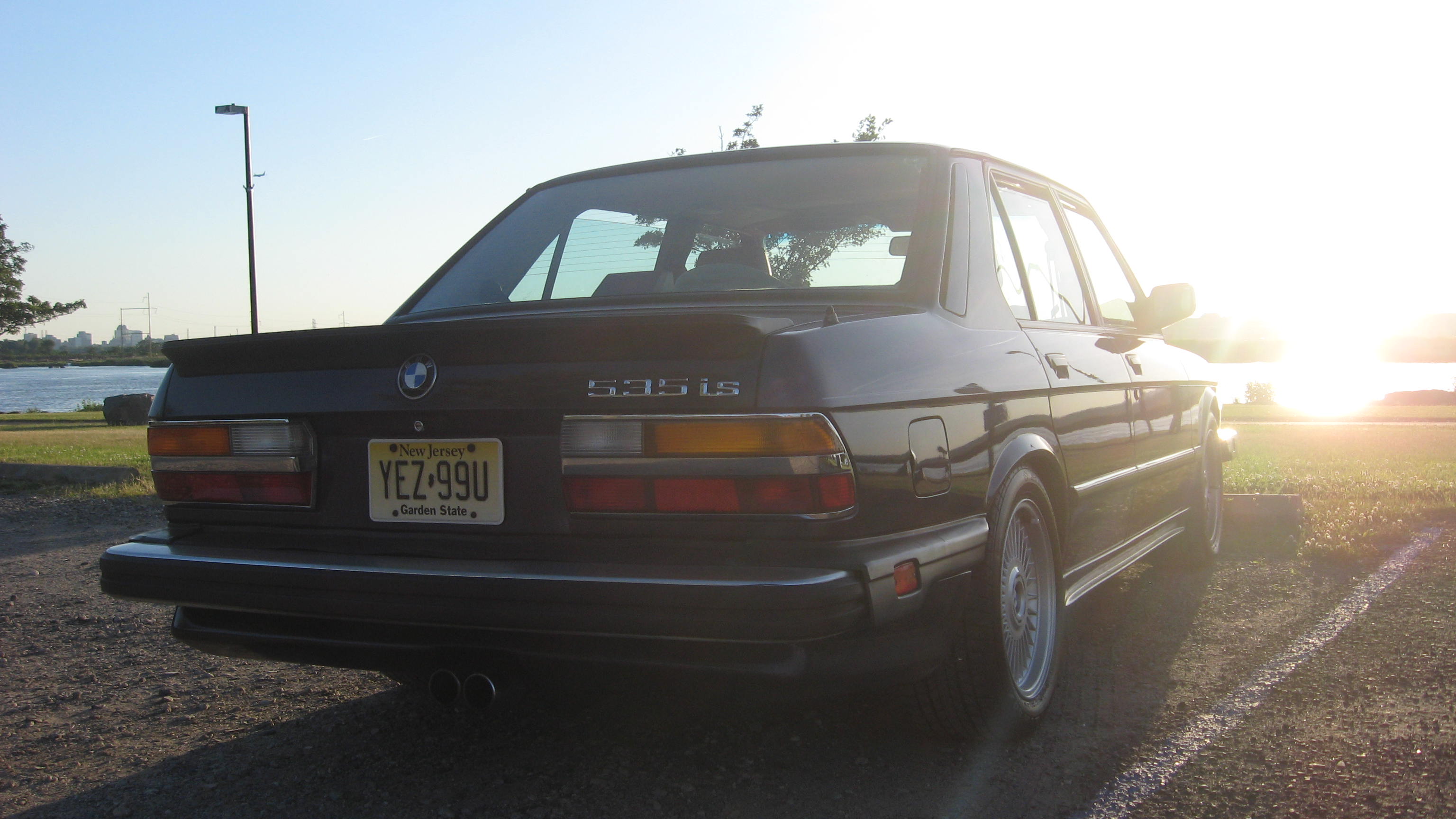

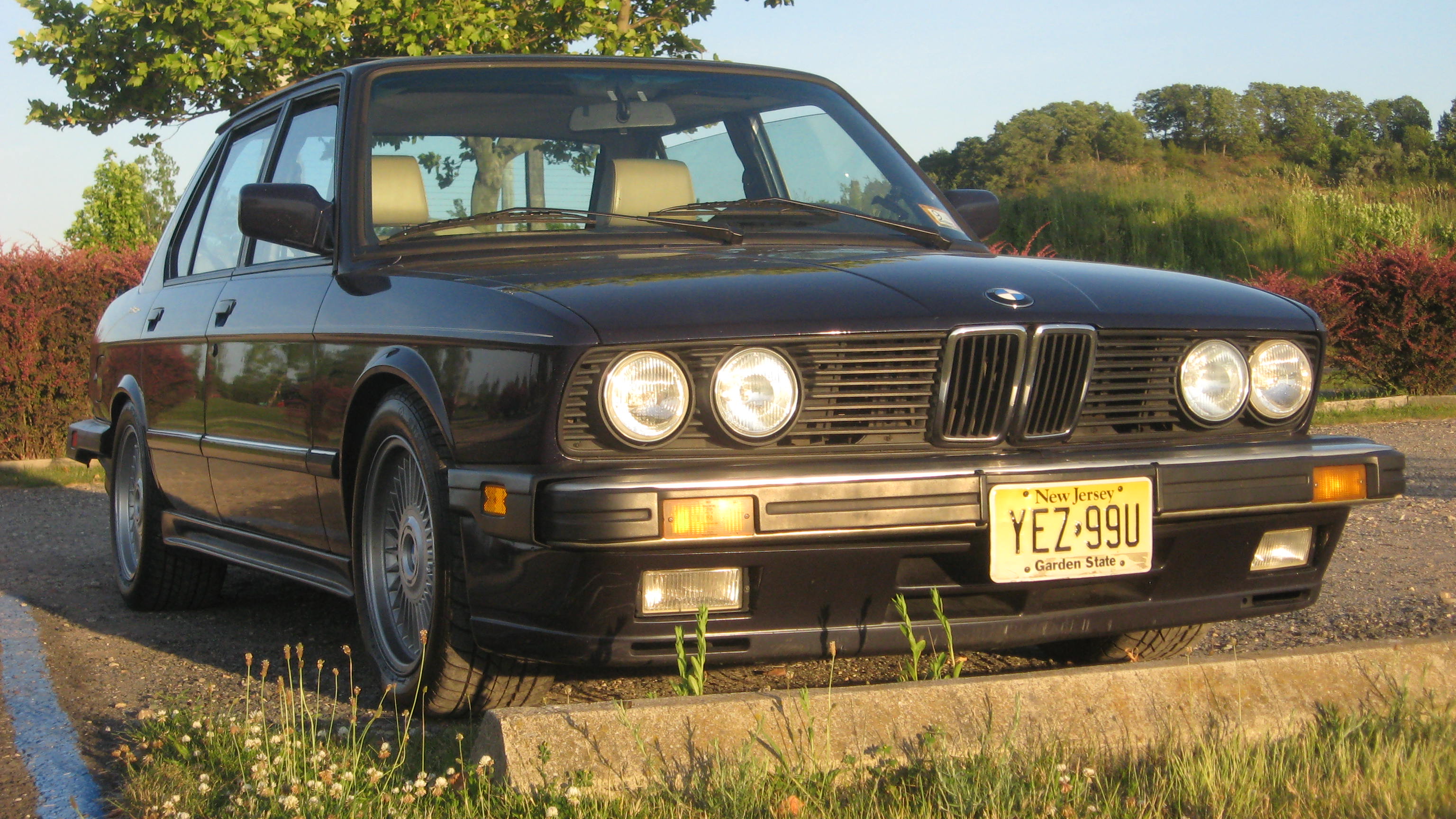

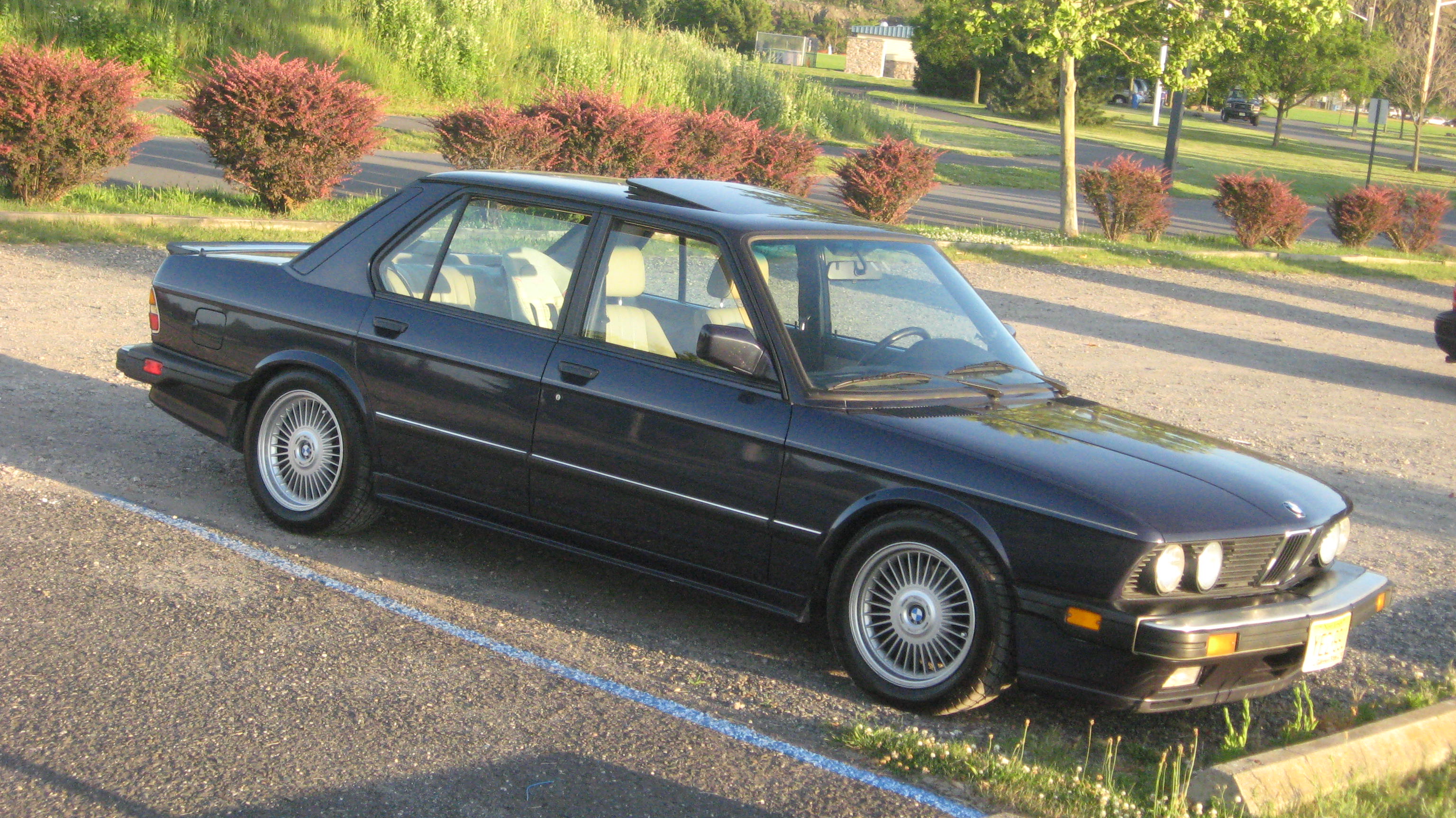

Here's two shots of mine also stock height:
Again, many comments about appropriate tire sizes to run on these. Remember these wheels are 16x8 et23, so they're a lot bigger than what was designed to go on the car. I chose Kumho Ecsta ASX 225/50R16 both front and back and had real problems with clearance on the fronts. They ultimately needed 12mm spacers to clear the strut towers (although 10mm might have done it) and as you can see, it really pushes the tires out of the wells, more than I care for. Could be the Kumho's have a wider cross section than others
, but the rears are fine. My next set will be either 215/55's all around or keep the rears at 225/50 and step down the fronts to 205/60's.
Another thing to keep in mind is the larger wheel and tire are adding a whole lot more un-sprung weight to the front of the car. If you haven't done so already, plan on upgrading your struts and shocks (I switched out to Bilstein HD's). The combination of these, the wider tires, and new front suspension makes this car a dream to drive; far different from what it was like before. It's great in turns and rides on rails on the freeways.
[As a point comparison, the previous wheels and tires were 15x7 Style 2's with Michelin Pilot Exalto 205/60R15H with (old) stock struts and shocks. And a few sets before that were the 165TR390 TRX's with one set each Michelin 200/60's and 220/55's. ]
