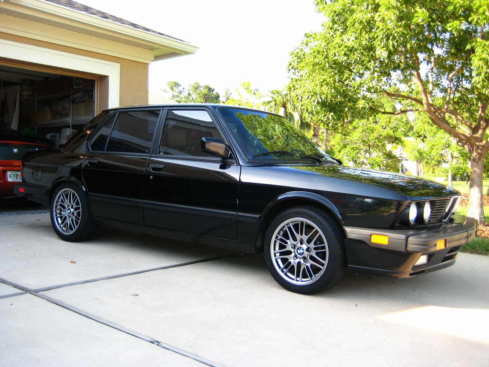

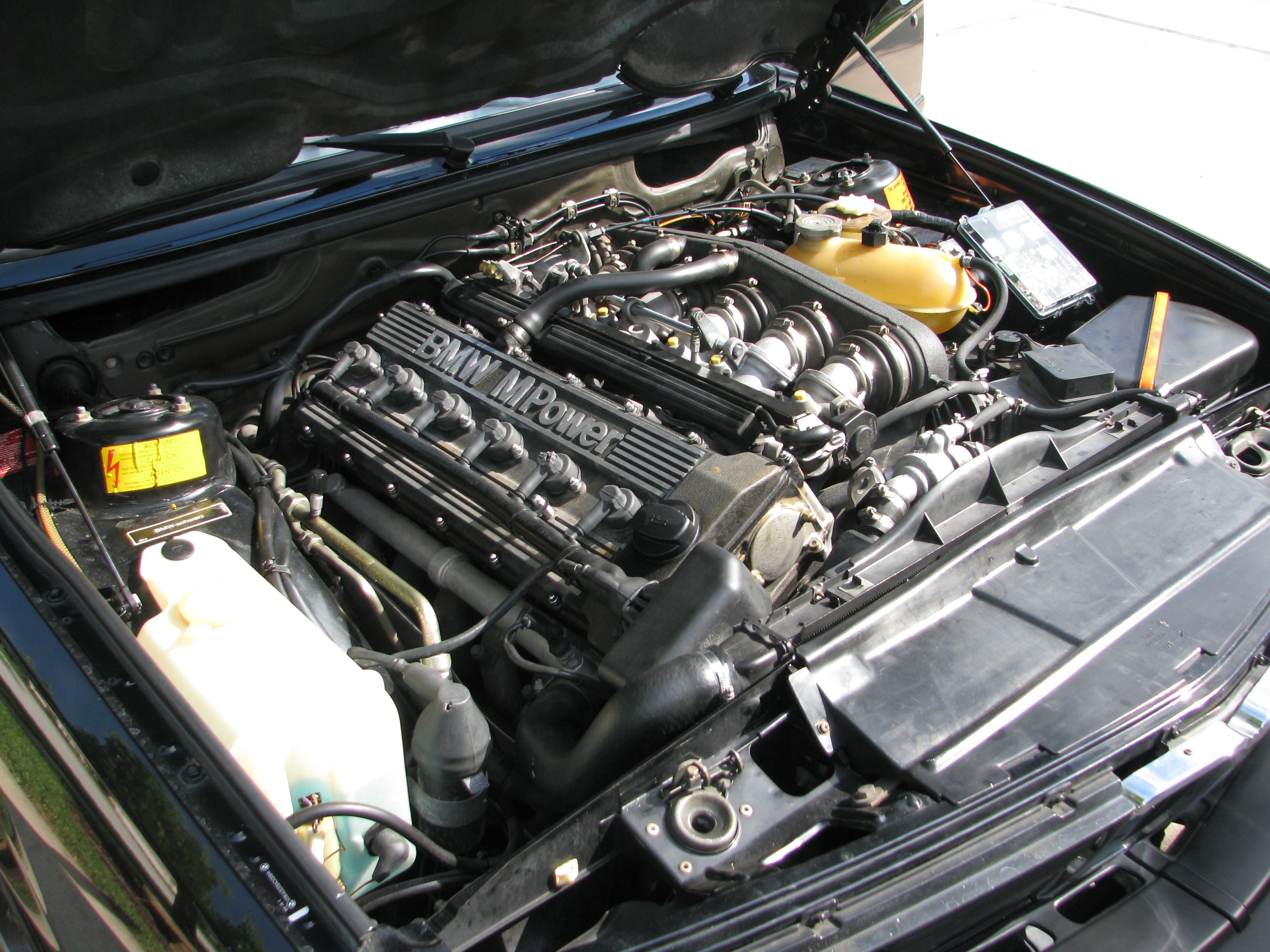

Here's the tale on the PPI:
1. Compression 14.5 to 15.5 Bar across all cylinders with matching arches.
2. "NO RUST, not even a speck on any of the body or chassis" mechanic exact words.
3. Original paint in excellent condition, no fading.
4. Driver seat has slight wear, no rips, passenger side head rest inop.
5. inside/outside is very very clean.
6. dent in fuel flap.
7. paint on front spoiler is missing in a few spots.
8. tires 90%
9. rear shocks converted with Billy's and springs.
10. AC has a very slight leak but blows ice cold.
11. power steering pump has a drop leak.
12. Trannie shift shaft seal has small leak.
13. needs muffler gasket, and rear of muffler rust is forming.
14. slight valve cover leak.
15. ignition wires will need replacing as it looks like squirrel or mouse has had lunch on #2 wire.
16. Mechanic said you could drive this car anywhere.
If you guys don't mind I'd like to install a set of Black Euro bumpers, euro lights, Eibach springs, and short shift.
M5.jpg Image Tag: Image
Link Tag: M5.jpg 733.90 KB
M53.jpg Image Tag: Image
Link Tag: M53.jpg :alright:
