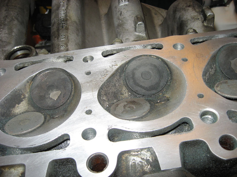

I changed the head gasket and found a slightly cracked head, I believe due to overheating. It's running fine NA but it will not hold up to FI. I'm hitting the yards and craigslist for an i top end. But the car is being used as a daily driver as of late, so I have to find another project car. We're on indefinite hold on this, but rest assured I will do this eBay turbo build and I will post the results. Thanks for the interest.
turbodan
Posts: 9694
Joined: Jan 09, 2007
Post by turbodan »
When they crack they dont do it slightly.
Where was the alleged crack located?

You sure thats a crack? They always crack under the cam.

turbodan wrote:You sure thats a crack? They always crack under the cam.
I can hardly see anything in the picture.
That does look like a crack from here, but that is a bad picture.

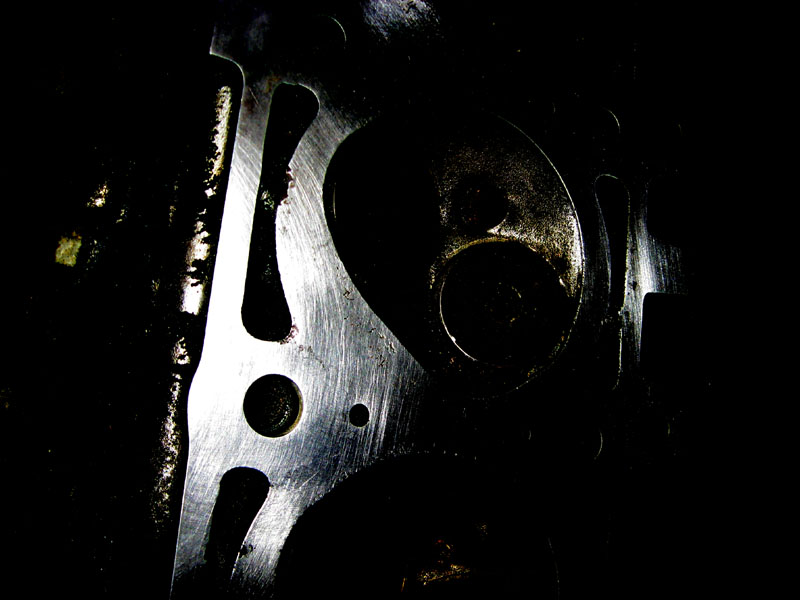

I mucked with the contrast and brightness to show in the picture what you can really only see in person. There is a crack at each water jacket on either side of that head bolt hole, and you can see what I would call a "slight crack" or the beginnings of a more serious crack connecting the two water jacket cracks - following the radius of the bolt hole about a centimeter out. This suggests soemthing tried hard to separate the block from the head and stressed the head along the bolt holes.
You may also note how pitted the flat portion of the combustion chamber is. All six chambers show this type of damage, some of the worse than this one. The previous (orignal) owner's records don't show what calamity transpired, but those pistons munched on some metal at some point.
The motor will get a full rebuild, or at least the car will get a fully rebuilt motor whichever block I wind up using. Tell me, Dan, can I use aluminum foil for bearings and zip ties instead of rod bolts? ;)
PS Head with cam is ~$30 at pick-your-part during 50% off sale. You just have to keep going back until you find one that hasn't been destryoed by a timing belt or "Cash for Clunker"ed.
