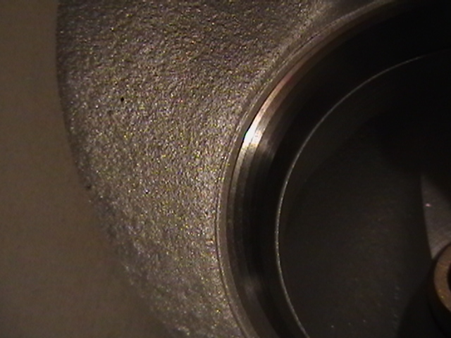

Entropy_Engineering wrote:Make sure if the valve seats need work the machine shop does it with a cutter, not a stone. The BMW valve seats are so hard the majority of the time a stone will start to chatter a little and make the seat rough. A good machine shop should be cutting with a machine like a Serdi.
Like this?
Paul

I can't tell on that pic. And I'm not 100% sure it's always a problem. The ones I saw that chattered had like a wavy finish with probably 3mm between waves. That looks smooth to me. Like Dan wrote, I've basicly always been able to lap them in. I don't see too much what slightly worn guides would hurt either. Once they wear a little they just start lubricating themselves better. Excessively worn intake guides I guess could lead to loss of octane from oil injestion, but I don't see that happening. If you do ever replace guides, have bronze manganeze type installed they hold up better.

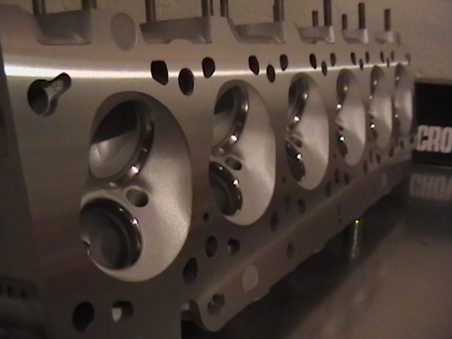

The head was cut on a Serdi 60 using a five angle cutter. Seat is 1mm wide and it has Bronze Manganese guides installed..
NO RA COMMENTS PLEASE!! Don't want to start that stuff again.
Paul
Entropy_Engineering
Posts: 84
Joined: Dec 19, 2008
Post by Entropy_Engineering »
Uh, holy crap sir. That is beautiful. Now ship one to me immediately.

paul burke wrote:ImageLike this?
Paul
Naaaaaaaaaaaaaa.......TurboHack says just lap them. What you do is stupid.
Paul, you know nothing....TuboHack knows much better....
