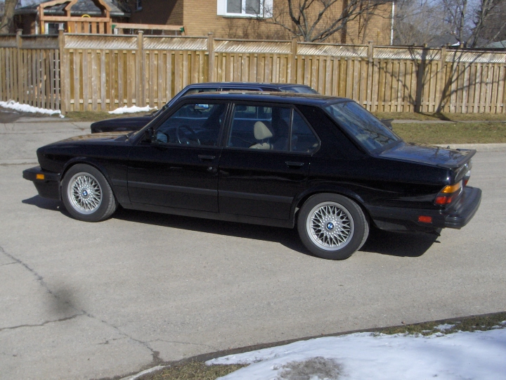

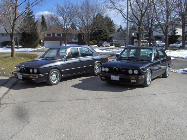

You will still have one of the slower E28 M5's in Southern Ontario Bruce.A little eye candy that Mark picked this spring with a 3.9 stroked Metric Mechanic motor. ;) The IS to the left is Marks old car after the paint job and it is now my daily driver.
8)
Sorry Bruce but I didn't mean to hijack the thread. Ted ;)
