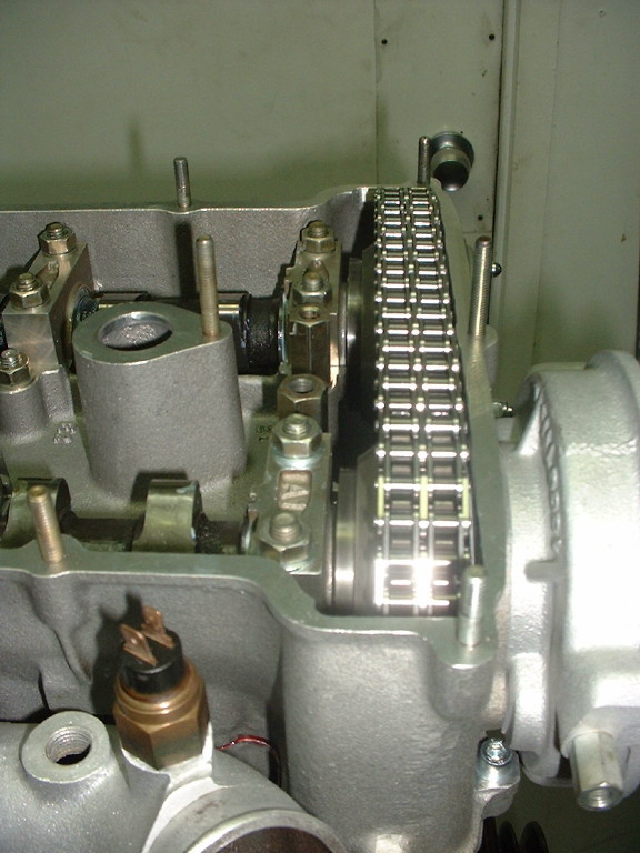

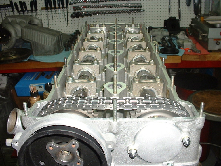

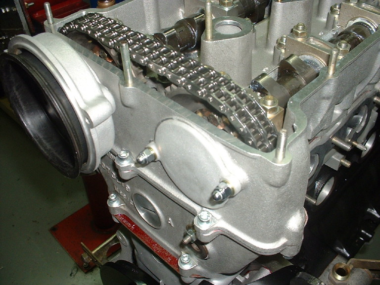

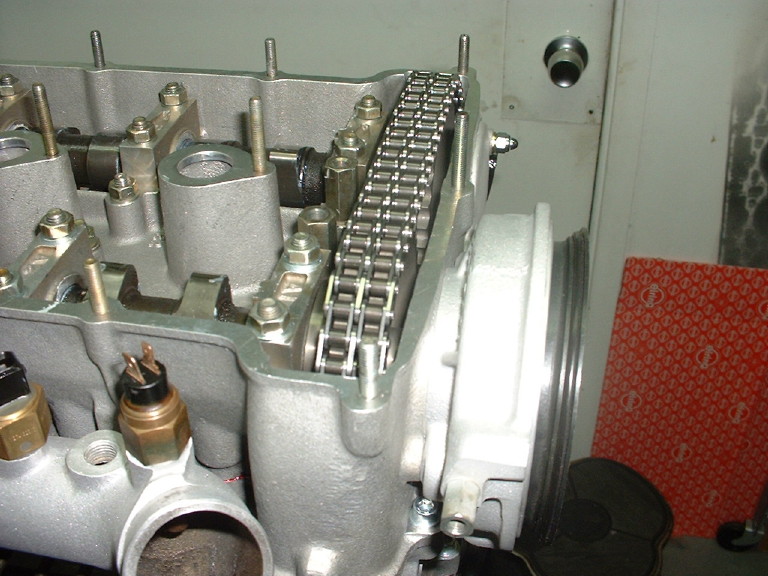

Post by Rich Euro M5 »
installed in my Euro M88/3 engine. As you can see, there isn't much room between the chain the front edge of the cambox. The later S38 engines have a wider opening in this area and the oil fill cap located directly over the chain.
Rich

Rich,
1. Any machining required to fit the duplex chain to the m88/3?
2. What are the parts and part numbers of the parts (geez) you used?
3. Any more details you can give about the conversion?
Thanks.
Rich Euro M5
Posts: 6098
Location: Klein, Texas
de Witt wrote:Rich,
Thanks.
de Witt,
1) It's my understanding it does require machining. I didn't do the work so I don't know if it can be done without machining. The actual costs for the machine work was about $400. Steve H. may be able to add his comments.
2) I ordered everything in the timing chain assembly for a S38B35 engine.
3) Nope, othere than it's a very tight fit as you can see from the pics.
Sorry I couldn't offer any more info.
Rich
