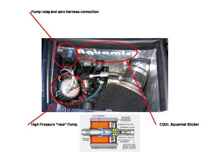

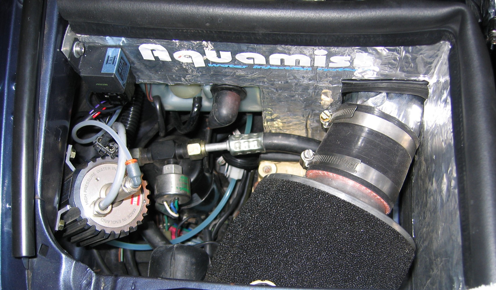

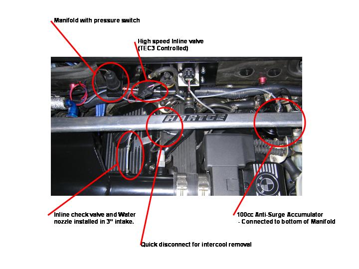

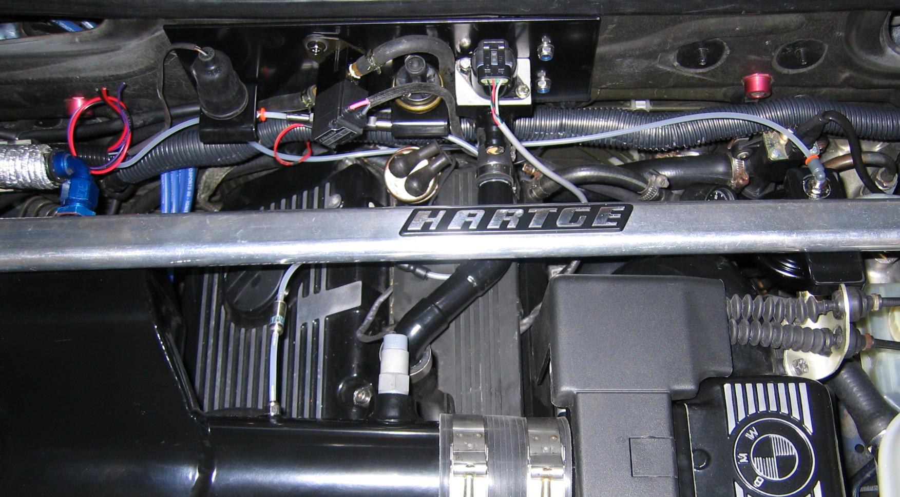

Aquamist water injection Installed....cool pictures.
Sorry about the picture sizes, I got a little greedy.
All that is left is some wiring into the power and TEC3.
It's will be very cool, excuse the pun.
