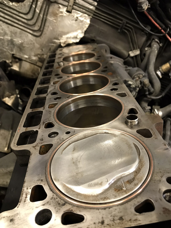

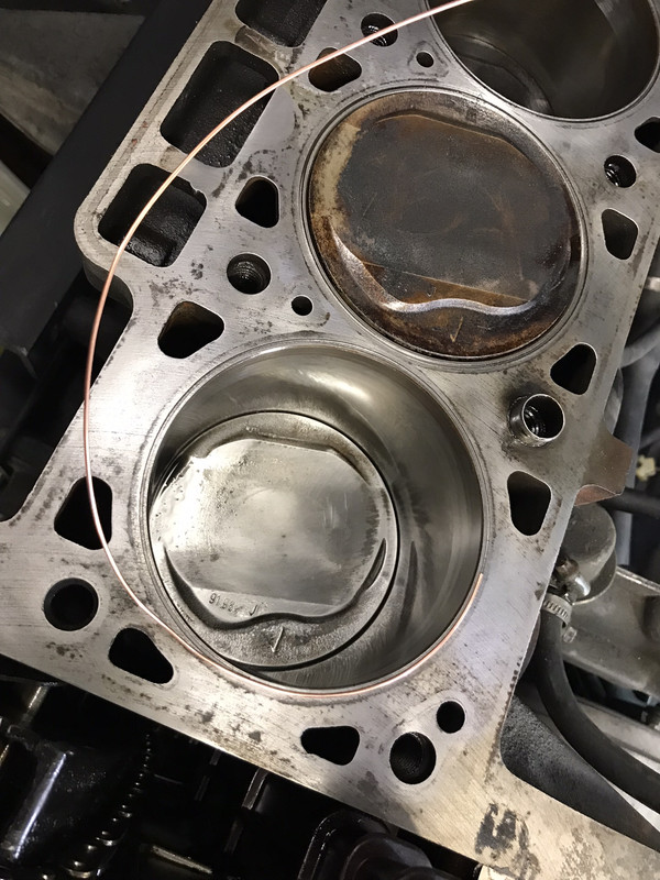

For the record, I am running ARP head studs, O-ringed block, and stock HG on 11 psi boost and so far no issues, but granted, I haven't driven it thousands of miles yet...
From my reading, it seemed to me that this is the way to go with the M30, which is why I did it.

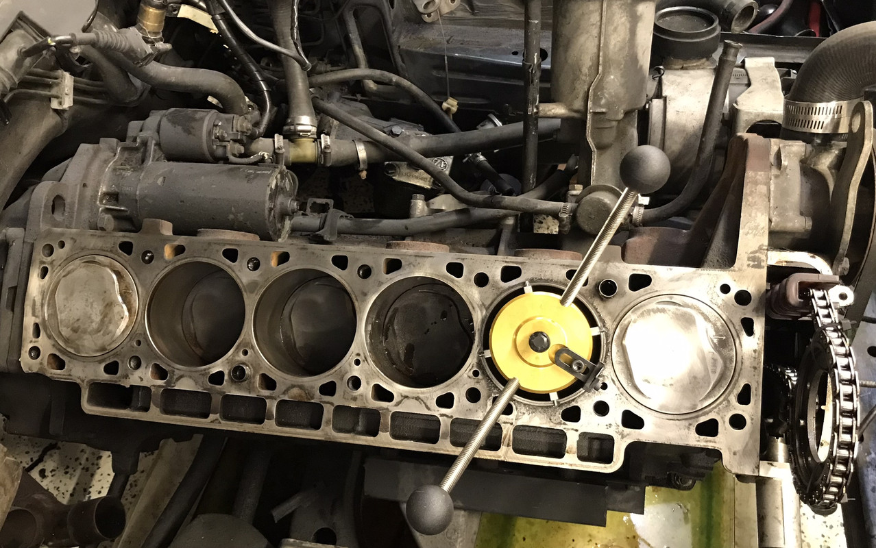

May I ask where to get the tools? There are instructions on the internet where everything is described in detail.

lummpy69 wrote: Dec 15, 2023 6:02 PM May I ask where to get the tools? There are instructions on the internet where everything is described in detail.
It looks like he is using the Isky Groove O Matic.

turbodan wrote: Dec 23, 2023 9:24 AM
This is correct. I bought it from Amazon or Ebay or something. Didn't want to bother w renting one, as I intend to use it again, I have a spare M30 that I will rebuild one day.
EDIT: Holy metric crap, did I really pay $341 for it??? :shock: I don't remember it being that expensive!

Cheap compared to what I was once quoted by a machine shop to do the same job.
