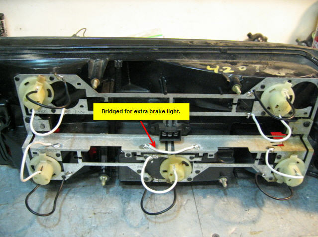

On the brake lights, the ground is thru 2 pieces of galvanized metal where it's folded over, my guess is that's where your problem is. Not a great design. There's a variety of ways to fix it if that is the problem, there's a guy here selling an "octopus" which is a mini harness designed to eliminate the problem, or you can run a screw in thru both plates or even solder them together. On soldering, you need a lot of heat, a gun, not an iron, and patience.
Windows may be as little as the circuit breaker down by your knee on the kick panel. Dash lights I dunno, maybe check the brightness adjustment wheel on the switch.
Here's a pic of a couple of way to ground the brake lights.

Thanks for the help Mike! I figured it out just by sanding the connections. Turns out all the connections are severely corroded. I came up with another problem on the blinkers and reverse light. I did not have a front bumper yet therefore does not have front blinkers. However, on the rear I only get about 6V for the blinkers and everytime I turned it on it makes this weird buzzing sound. The reverse light does not have any volts at all when I put the car in reverse. Do you or anyone by any chance know how to fix this?

Post by demetk »
The corrosion will come back. This is one way to fix the problem,
