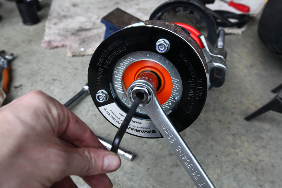

What do you call a socket like this one (19mm inner, 22mm outer)? And where can I find one? Looks like a spark plug socket.
Or, is there some other way to keep the shaft from turning while tightening the lock nut?
When I did my suspension, I wasn't able to find a socket like the one pictured so I bought a Harbor Freight 19mm, 1/2" drive deep well socket and had one end machined for a 19mm square drive. That way I was able to insert the allen wrench through the socket and into the shaft while holding the square end with a 19mm wrench.

LarryM wrote: When I did my suspension, I wasn't able to find a socket like the one pictured so I bought a Harbor Freight 19mm, 1/2" drive deep well socket and had one end machined for a 19mm square drive. That way I was able to insert the allen wrench through the socket and into the shaft while holding the square end with a 19mm wrench.
I considered doing that.
I found this "21 Pc SAE & Metric Go-Thru Socket Set" $19.99 at Harbor Freight, which was open today.
Worked dandy. Total crap-quality tool, but got the job done.

Use a box spanner https://www.ebay.co.uk/itm/Stahlwille-1 ... :rk:8:pf:0 , a ring spanner and a 3/8" drive ratchet with extension and allan bit.
Or just use standard strut nut sockets and an allan key https://www.ebay.co.uk/itm/NEW-LASER-ST ... rk:20:pf:0
