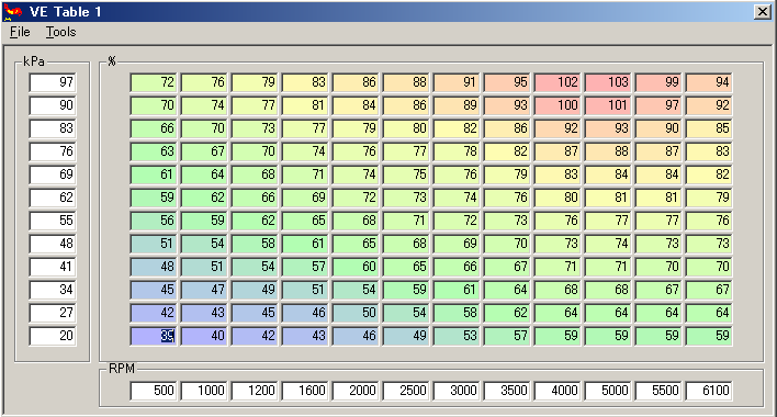

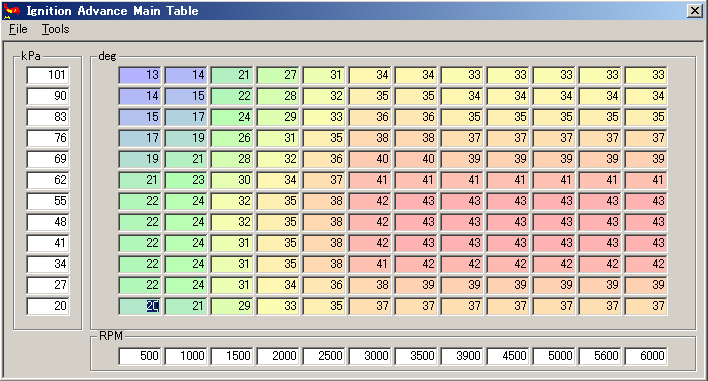

Updated: latest firmware, config, and tune after dyno run. I should also note that I'm running non-stock injectors, I think they are a slightly lower flow rate around 21lbs/hr.
http://www.hyakushiki.net/motronic/m30-3c.7z
