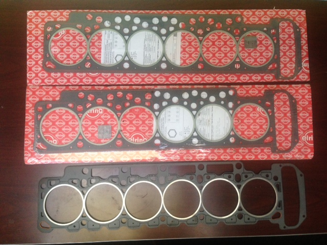

I don't have a VR but I measured a Goetze against two Elrings and got 94mmØ for the Goetze and 93.5mm for the Elrings (and the package is labeled as such, see below). The water cutouts or definitely different however. I think I got one of the Elrings as a single HG from Pelican last year some time. Not sure of the going rate but I'd part with one if the mm matters that much. The Elring packaging is marked B35, and apparently good for an E23 735, your car. The weird part is the Goetze came out of package with a VR label on it. I think the VRs Pelican sells come as part of the full head kit. So that's what I can tell you, not sure how useful it is!
All 3
Elring Package
VR head set package
Goetze Package (marked VR)
