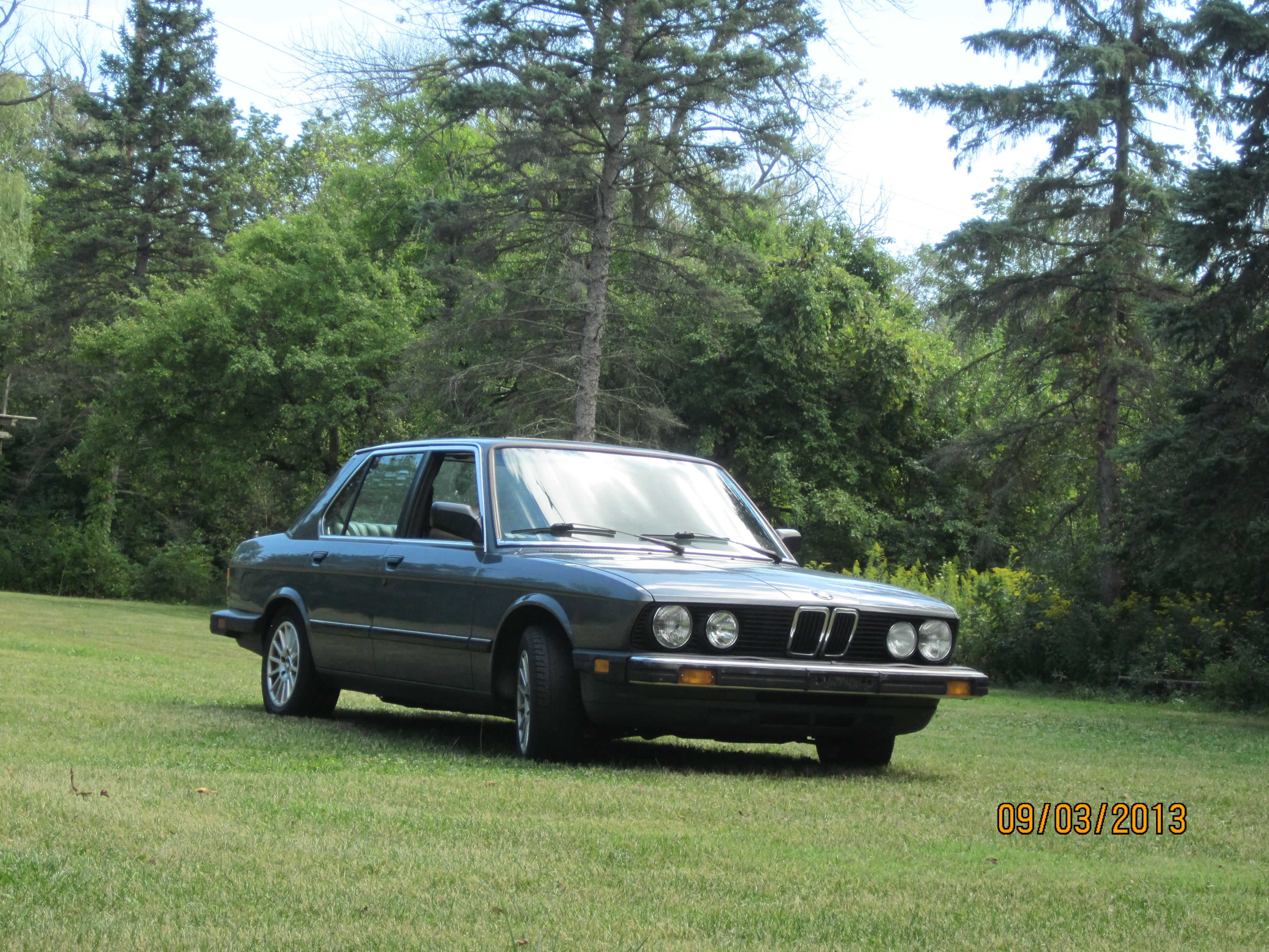

Euro lights!!! I think they look good with the US bumpers:

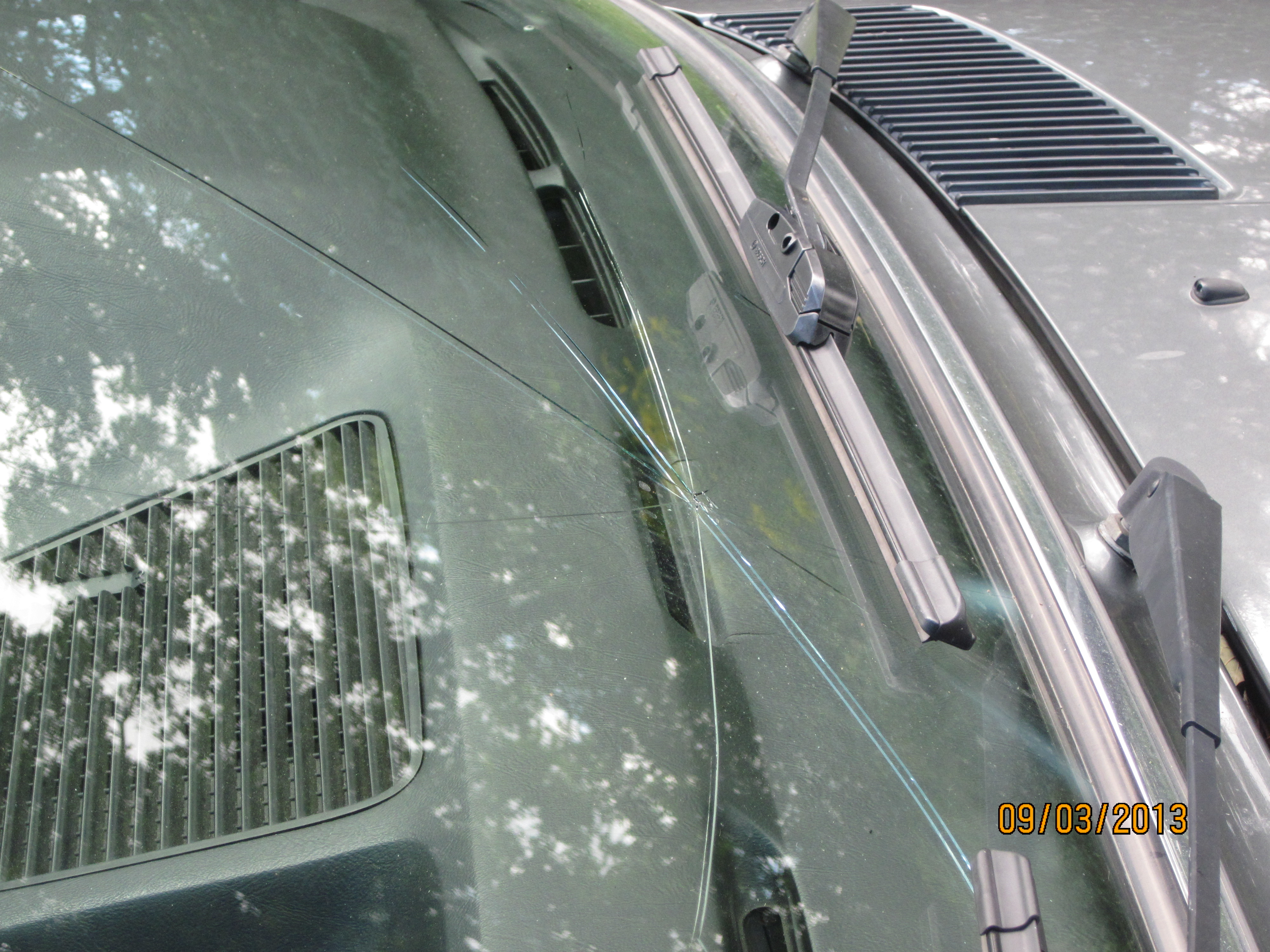

What my Ex girlfriend did:

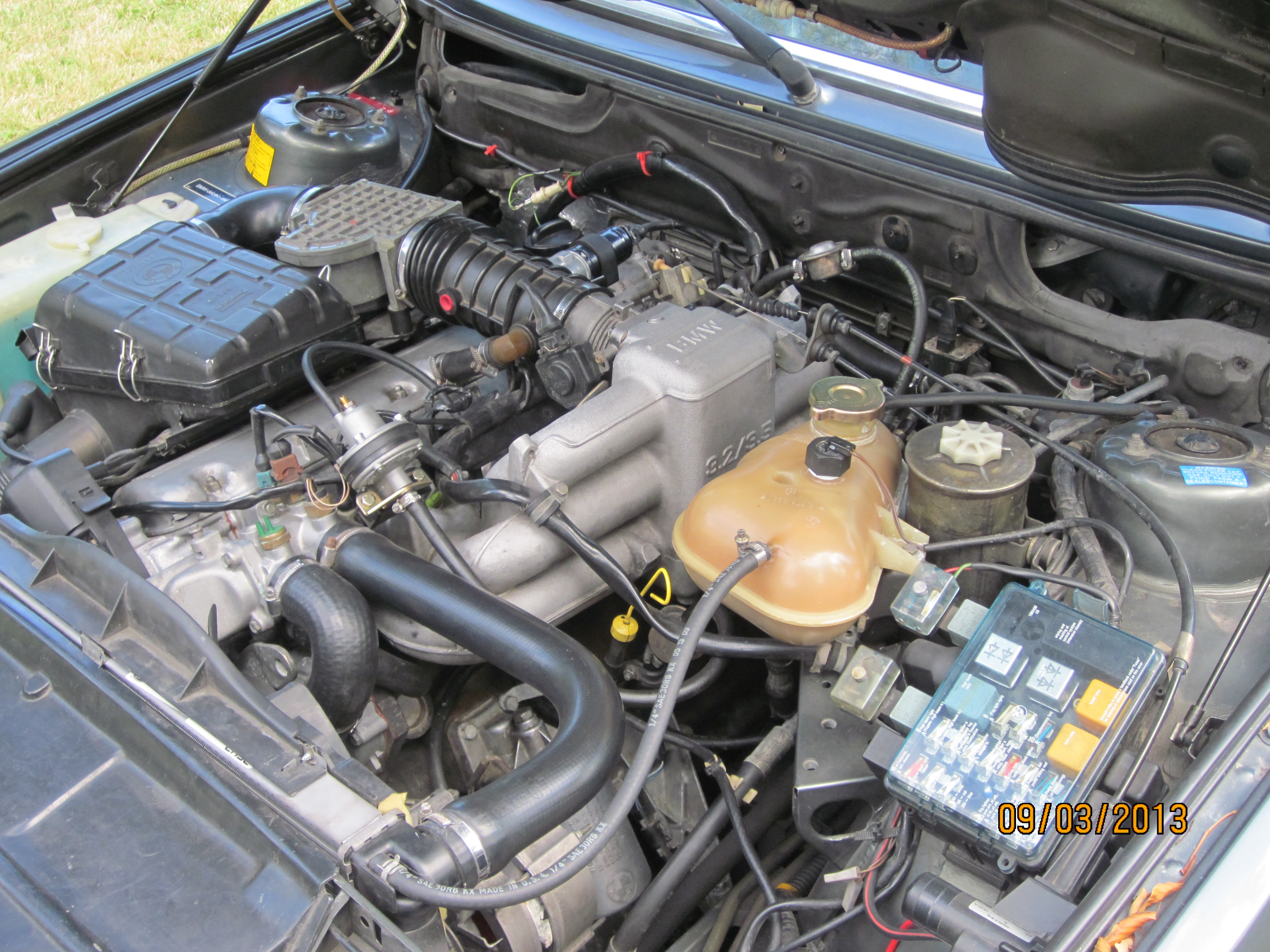

The cleanest part of my car is the engine and bay

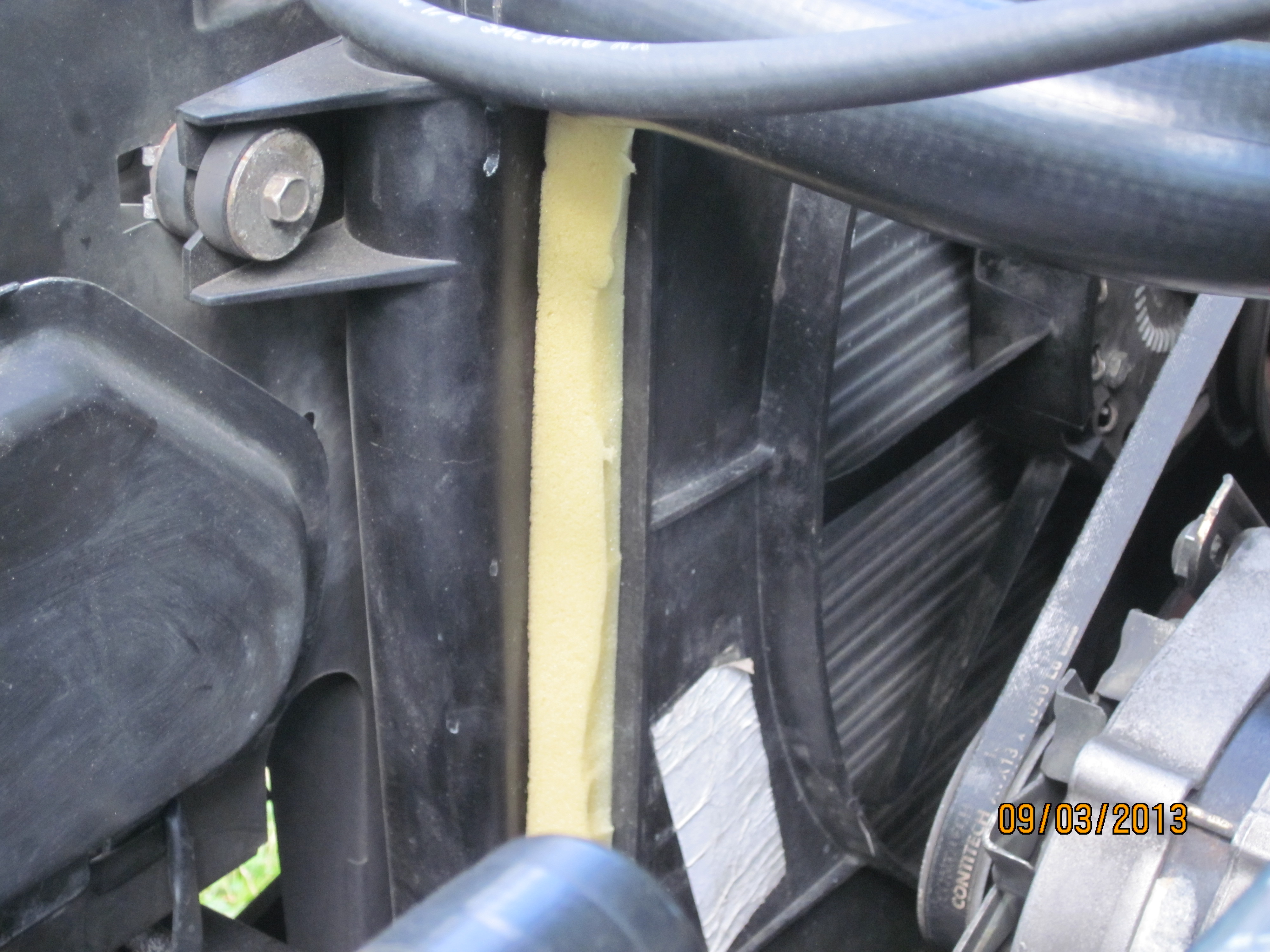

If you have not done this yet, I suggest you find some foam and scissors, The temp gauge barely goes past half while sitting in traffic!:

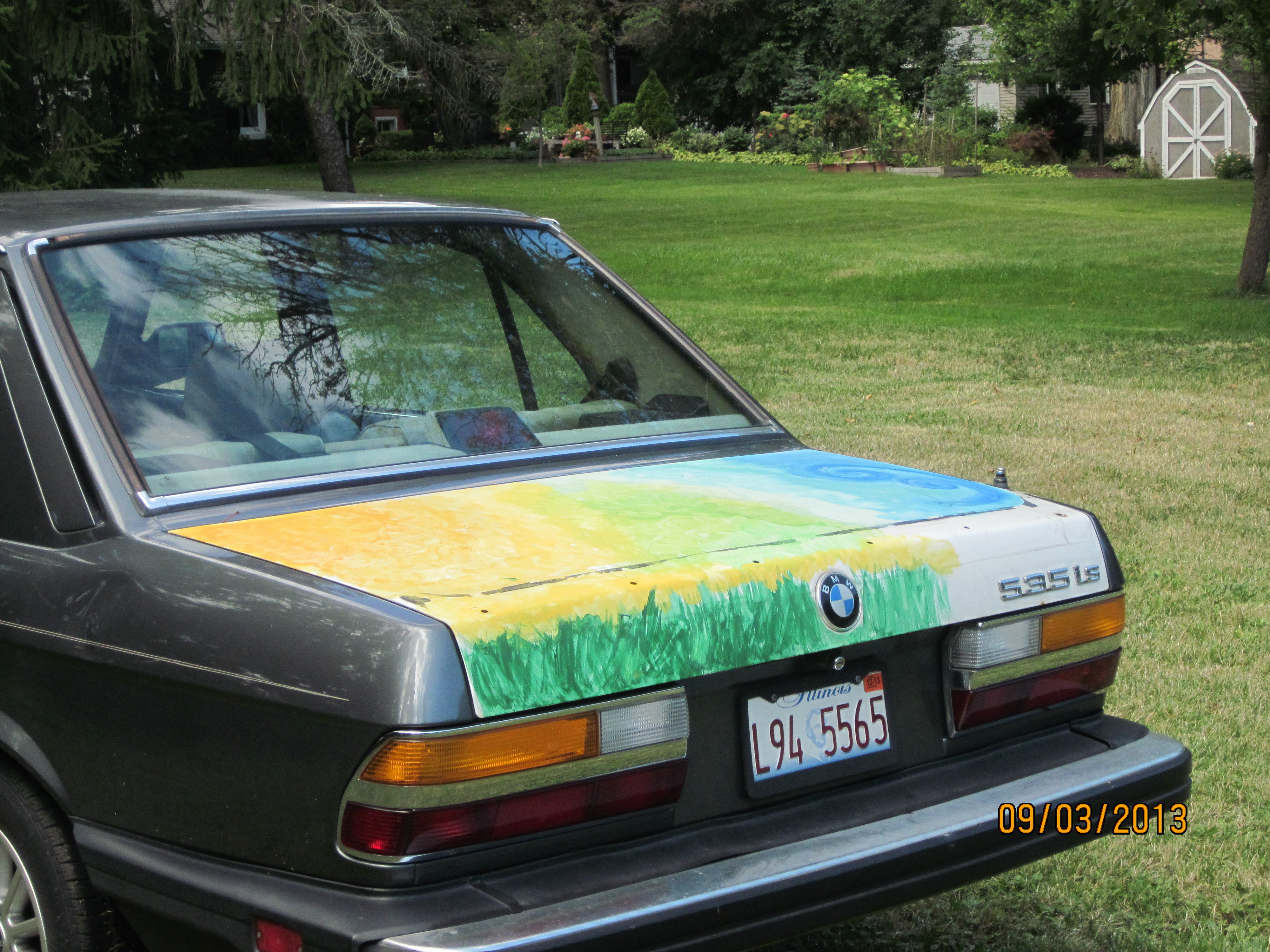

I put on the white trunklid to let my friends paint it before I do and put the 'is' spoiler on, It is not done yet haha:

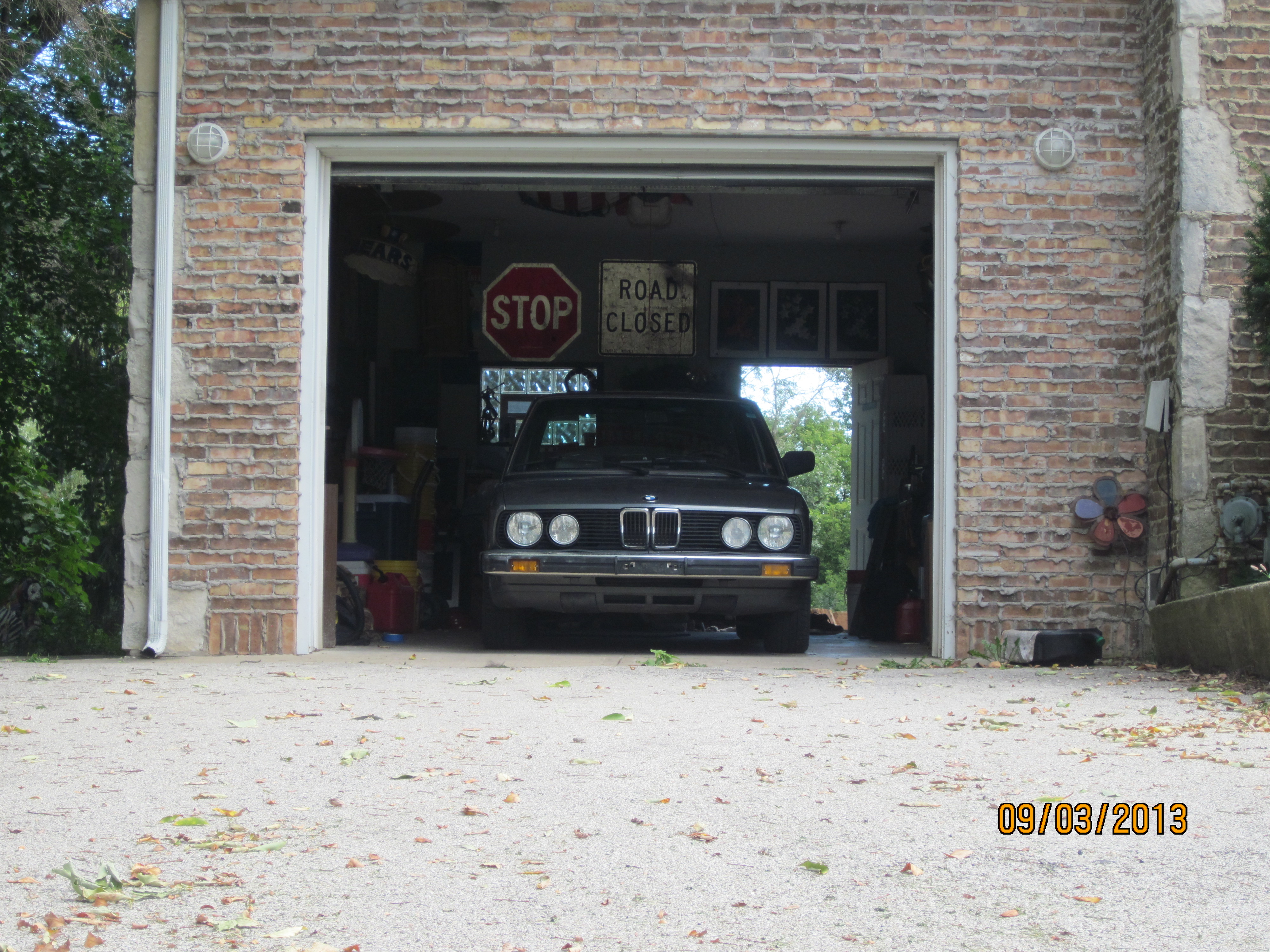

And one more in the garage:
Ignore the signs in the back, those were acquired long before I could even drive

Beware the Ex!

Do you have any more info on the foam?

I cut up the block of foam that is usually stuffed behind the antenna motor (because I had two). Made 'em into 1x2" with scissors, then stuff into openings in between rad and shroud. Makes a big difference in how long the clutch stays engaged and when it engages. It iss also quieter.
