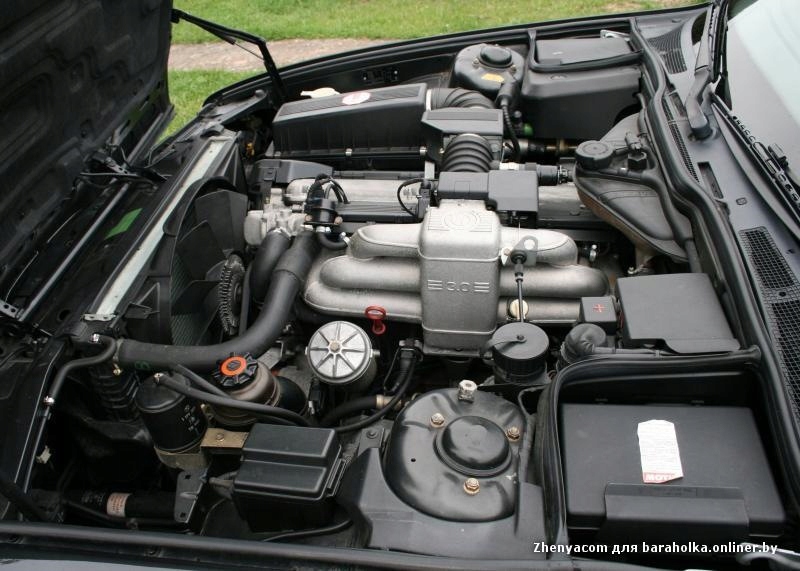

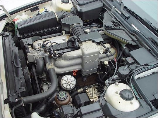

You don't have a M30 engine. The European e34 530i used a 2 valve per cylinder 3 liter M20 engine. It's a bigger version of the e30 325i motor, that is it's the baby six. I am looking at pictures of it now.Nothintoseeere wrote: Apr 23, 2021 6:06 PM Its not quite e28 (i have had three) but its for an e34. In any case the car has a m30b30 which i like. However it could have more poke and i think it can. One problem is the low CR. Even over here in the U.k they are have a CR of 9:1 which will blunt any tuning done.
First step is, as the exhaust is blowing is, to have Frits Bits stainless exhaust manifold and system fitted. Since its RHD car this is the only one that can be bought. Given the exhaust studs broke when removing the old manifold the engine is out now for there removal. Removing the cylinder head could be a can of worms and once its off, its why not time.
Second step is rolling road to see what it produces. I think its in rude health but I think and it is could be different things. When it was new it has 188hp.
Step three fit omex engine management. Wave good bye to the Afm at this point and say hello to a MAP and temp sensor. Motronic won't be ditched. It will still think its doing something so the energy control will still work but it really doing just that.
Step 4 well this is where thoughts are sought. I could have the engine out and dismantled. I could have it bored out for custom pistons and if that done you might as well fit 93.4mm pistons or 94mm pistons, the b35 head ( with some minor work) a dblias cam or similar and enjoy. However thats obvious. I like the engine size. I see know reason to bore it out, its almost boring. Pun intended.
The m30b30 piston have as far as know a 10.4cc raised profile and the combustion chamber is 65cc like on the b35 head which means the raised profile would need to be 17.6cc or thereabouts to give a 10.5:1 CR. My gut tells me that might be too much. Also if new pistons are being fitted why not bore the block.
So the m30b25/b28/b34 head has a 58cc combustion chamber. Fitting this would raise the CR to 10.5:1 especially once a used head is skimmed. This head has valves that are the same size as i the m30b30 head but its the older style ports. However over that head got 218hp out of the m30b34 motor so it can flow some air.
Also for a cylinder volume of 497cc 46mm inlet valves are about right so there may not be any gain with larger valves and ports of the b35 head. The b30 head has smaller valves and inlet ports to increase gas flow speed and help low end torque. I assume thats the reason. With that in mind there maybe little that needs doing to the suggested head apart from port matching. I won't be doing that. Radco sport not far from me will be. They mostly build race engines for smaller classic british cars. Then which cam. Dblias has one with reasonable lift. Is it too much for this engine. It will be as it bow a car for driving on the road. All i want is a bit more poke without changing the engine.
Then what to do with the intake. Dblias do an ITB setup which look the part. No idea if it works well as there are almost few report of this sort of setup working well. Of course i could leave it as is. To be honest i just like the look of it.
Thats the plan as it is. Not sure if anyone has done anything similar with a 3.0l.
The only M30 engined e34 was the six cylinder 535i with the M30B35. America never got the six cylinder e34 530i. The last time the 3 liter M30 was used in Europe was the early e24 630CS and e23 730 of 1976-79, they were carb cars with the Solex 4AI 4 barrel. It was replaced by the 9.3:1 184 bhp L-jet 2.8L in the 528i/628CSi/728i for 1980 in Europe.

I do have a m30 engine. There is no 3.0l m20, of there was everyone would be fitting that into there e30's. I know the m20 engines and trust me on this it not a m20. I do know what i have. I also think bmw know what they put on the car and they say its an m30. This engine was also used in the e32 730i.
In any case a couple of exhaust manifold studs are rounded so its engine out time.
Re: M30b30 tuning
You are absolutely correct. Now the late 3.0 and 3.5 were slightly different than 69-88 model year M30s, kind of a M30.1, but definitely M30s. M20s first saw 3.0 displacement in the E36 M3 as a S50, which was not a M20 but a descendant thereof.Nothintoseeere wrote: May 07, 2021 5:06 PM I do have a m30 engine. There is no 3.0l m20, of there was everyone would be fitting that into there e30's. I know the m20 engines and trust me on this it not a m20. I do know what i have. I also think bmw know what they put on the car and they say its an m30. This engine was also used in the e32 730i.

Please show us the picture of your engine. I disagree on this, the intake manifold is a clear sign it is not the M30.Mike W. wrote: May 07, 2021 6:20 PMYou are absolutely correct. Now the late 3.0 and 3.5 were slightly different than 69-88 model year M30s, kind of a M30.1, but definitely M30s. M20s first saw 3.0 displacement in the E36 M3 as a S50, which was not a M20 but a descendant thereof.Nothintoseeere wrote: May 07, 2021 5:06 PM I do have a m30 engine. There is no 3.0l m20, of there was everyone would be fitting that into there e30's. I know the m20 engines and trust me on this it not a m20. I do know what i have. I also think bmw know what they put on the car and they say its an m30. This engine was also used in the e32 730i.
North America never got the e32 and e34 730i and 530i six cylinder cars. They didn't use the M30, the only remaining M30 cars by this stage were the 535i and 735i, both with the M30B35.
Look at the following two links, the first shows the e34 530i 188 hp engine. The second page shows the e34 525i and 535i engine. You can now see the 530i had a derivation of the M20.
e34 530i six cylinder, look at the intake manifold
M30 on the left, M20 on the right
I was around over there when these cars came out and both the 530i and 730i were very slow sellers. Not many engines to put in e30s, and right after came the 4 valve 192 hp M50, and everyone went with those in Europe. Everyone forgot about those 2 valve 188 hp 530i/730is, but I remember.
Re: M30b30 tuning
I agree the intake looks like an M20, however go to the specs and look at the bore and stroke. 89X80 is a M30 dimension. M20s/M50s were small bore/long stroke engines. Even as they grew to 3.0 in M54 they stayed at 84MM bore. The block just doesn't support an 89MM bore. Or look at Realoem, they show an M30 3.0 and the parts the show supports that. Or Schmiedmann, they show an M30 E34 and they're in the business of selling parts.
Re: M30b30 tuning
The magazines could make a mistake on specs. Yeah, the baby sixes went long stroke, that's what led to the 2.7 earlier. Look at the intake side in both pictures, the M30B35 is on the traditional M30 side, the mystery 3.0 is on the M20 side. Why on earth wouldn't they use the post 1981 M30 intake on that 3.0? And the oil filler is on the other side. By 1975 all M30 oil fillers moved to the firewall side. The pictures in both links were from 1988, you would think BMW would be consistent with their M30s.Mike W. wrote: May 09, 2021 1:52 PM I agree the intake looks like an M20, however go to the specs and look at the bore and stroke. 89X80 is a M30 dimension. M20s/M50s were small bore/long stroke engines. Even as they grew to 3.0 in M54 they stayed at 84MM bore. The block just doesn't support an 89MM bore. Or look at Realoem, they show an M30 3.0 and the parts the show supports that. Or Schmiedmann, they show an M30 E34 and they're in the business of selling parts.
There must be hardly any six cylinder e32 or e34 530i cars still left on the road. Most markets in the world never got them. Don't believe listings online just because they are there, and I have found mistakes on Realoem, stuff that just couldn't be.
Back on e34 launch in Europe you had the 129 hp 520i, 170 hp 525i and 188 hp 530i. All were 2 valve and I say the 530i is a long stroke M20. I want to know if that motor has a cam belt or a chain?
Re: M30b30 tuning
Granted Realoem is not perfect. Pretty good, but not perfect. But look at Schmiedmann too. They show it as a M30 with M30 parts including a timing chain. I suspect the picture is something BMW supplied to the press and is in fact an M20 in a 525i. It was a short run before it was replaced with the 3.0 V8, but everything I see, have heard of and seen says it's a M30. As you know they weren't available here so I haven't seen one in the flesh, but all the parts say M30.
Re: M30b30 tuning
There is a whole wide world outside USA. Author is from UK. M30b30 in e32 and e34 is a real thing.e12euro wrote: May 09, 2021 1:18 PM North America never got the e32 and e34 730i and 530i six cylinder cars. They didn't use the M30, the only remaining M30 cars by this stage were the 535i and 735i, both with the M30B35.
I was around over there when these cars came out and both the 530i and 730i were very slow sellers. Not many engines to put in e30s, and right after came the 4 valve 192 hp M50, and everyone went with those in Europe. Everyone forgot about those 2 valve 188 hp 530i/730is, but I remember.![]()

I have not posted any pics of my engine. So how would you know what the intake manifold looks like. I also have owned m20 powered e28's and an m30 powered e28. I can tell the difference between the engines. Been around these cars for about 18 years now. I know its an m30b30 engine. They were sold in the u.k. it made 188hp and 192 ft.lb of torque when new according to the book.
Now moving on. I have never bought custom.pistons before. The best place to get them from without have to specify everything seems to be vac motorsport or ireland engineering simply because they have the pistons designs already. Never dealt with either company before given i am the wrong side of the pond. So of the pistons that both company sell is there one that a better bet than the other. Price is not the issue, ireland engineering is cheaper. I don't know if one company has a better dome shape than the other. I remind you all the engine in my car has the later 65cc m30 combustion chamber. Vac motorsport seem to offer pistons for the later engine and the 80mm stroke crank which is handy because that what mine has got. Ireland enginerring seem to do both.
Re: M30b30 tuning
I put a page from UK magazine Autocar comparing the 1988 e34 530i with 188 hp and an Alfa Romeo 164. No M30 engine ever had an intake manifold looking like that, and if someone knows different please tell me, all M30 engines after 1974 had the oil filler moved towards the firewall, not near the radiator like on a M20, which is where the oil filler seems to be on the six cylinder e34 530i pictured above.Nothintoseeere wrote: May 11, 2021 4:01 PM I have not posted any pics of my engine. So how would you know what the intake manifold looks like. I also have owned m20 powered e28's and an m30 powered e28. I can tell the difference between the engines. Been around these cars for about 18 years now. I know its an m30b30 engine. They were sold in the u.k. it made 188hp and 192 ft.lb of torque when new according to the book.
Re: M30b30 tuning
The article said all photos by the author Martin Vincent Autocar magazine (UK) November 2 1988. If you look at the above photos, the pics of the 525i and the 530i look a little different in terms of cam cover ribbing. But compare both to the 535i engine pictured, the smaller engines are both further from the radiator, the 535i six looks physically bigger, as you would expect.Mike W. wrote: May 09, 2021 4:17 PM Granted Realoem is not perfect. Pretty good, but not perfect. But look at Schmiedmann too. They show it as a M30 with M30 parts including a timing chain. I suspect the picture is something BMW supplied to the press and is in fact an M20 in a 525i. It was a short run before it was replaced with the 3.0 V8, but everything I see, have heard of and seen says it's a M30. As you know they weren't available here so I haven't seen one in the flesh, but all the parts say M30.
According to the European reports the 192 hp 24 valve 525i was seen as the six cylinder 530i's replacement. When the new M60 V8s came out later they were seen as jointly replacing the M30B35 powered 535i.
I would like to see a picture of the poster's engine compartment if possible. It may or may not match the photo in Autocar's 1988 article.

Re: M30b30 tuning
I am not sure how this argument has gone this far given there are more than a few photos and videos online of the late-style M30B30 that definitively prove its existence. I feel bad for OP, I am sure he is very frustrated with this board right now.

Re: M30b30 tuning
Thanks for finding the photos. UK's Autocar must have used the wrong picture, odd given they are such a respected journal.SlickDizzy wrote: May 12, 2021 7:10 PM I am not sure how this argument has gone this far given there are more than a few photos and videos online of the late-style M30B30 that definitively prove its existence. I feel bad for OP, I am sure he is very frustrated with this board right now.

Apologies to the OP, but he could have just said that wasn't his engine shown in the article, or answer whether it had a cambelt or a chain.

Re: M30b30 tuning
Thank you for clearing that up. I don't know why I didn't think to search for it, but I didn't. I was sure, but so was he.SlickDizzy wrote: May 12, 2021 7:10 PM I am not sure how this argument has gone this far given there are more than a few photos and videos online of the late-style M30B30 that definitively prove its existence. I feel bad for OP, I am sure he is very frustrated with this board right now.
