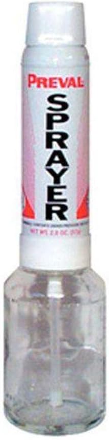

But what about a automotive paint store? It won't be cheap, it will probably be a brighter/whiter white as Alpine 1 I'm told ages yellowish, but it might be your best bet. They should be able to set you up with a single stage paint, albeit with hardener more than likely. No compressor and spray gun? Well, there is always the Preval system. I've done a large hood with it, which is way too large for the format, but a valance should be ok. Get at least 2 propellant units, maybe more. Amazon, local hardware store, where ever. You will probably have to reduce it to get it thin enough to spray.

Or... go to the local hardware store, if you can in this Covid 19 era, and ask them to match it with a metal compatible paint. Then use that and lacquer thinner and or paint thinner and spray it with a preval. No, it won't be as hard and durable as auto paint, but you could probably do it for a fifty.
