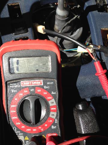

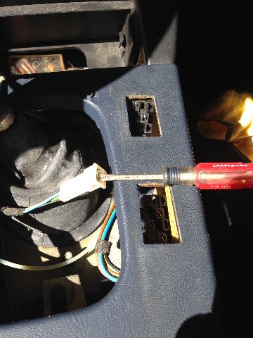

I'm having trouble with the reverse lights after a 5sp conversion. It's been a couple years since the last one but I hooked it up the way I usually do and was getting no love. I assumed it was something with the PRNDL multi-connector that I'd overlooked but it appears that the wiring is connected properly. When I cross this plug the reverse lights light, so I've obviously got the correct circuit.
When in neutral I get an open circuit off the reverse light switch

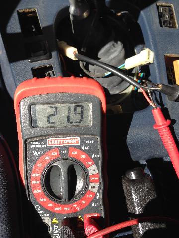

When in reverse I get 22 ohms of resistance from the switch. In any other scale it reports a dead short, so I assumed it should be lighting the lights. Is 22 ohms enough resistance to not pass the voltage? Apparently?? :? Of course I did this test PRIOR to installing the gearbox in a higher scale.

Nothing wrong with a new switch but you can try some experimenting first if you like. Brand new moderate current switches measure .01 to .025 ohms (after subtracting test lead resistance) but ancient but barely acceptable ones might measure .1 to .25 ohms. 22 ohms suggests some cleaning in place with two different methods could be tried:

Wally, that sir, is a hell of a write up. And kind of my style actually. Unfortunately before I read it I wandered over to Zygmunt's at lunch and grabbed a new switch. This fixed my problem. You were correct and I learned something about electronics. 22 ohms is too much, and always test in the proper scale. Luckily the car was still on jackstands from the 5sp conversion and the switch was a breeze to swap out.

Ohms Law says V=I x R (V voltage = I current x R resistance).
Voltage drop across the switch (V) is current (3.5A per Wally's write-up) x switch resistance (22 ohms).
That would be 77 Volts dropped across the switch. Since you only have 12 to start with, no voltage to the bulbs. It's all lost in the switch. Hell, even 1 amp would drop all of the voltage across the switch with that amount of resistance.
