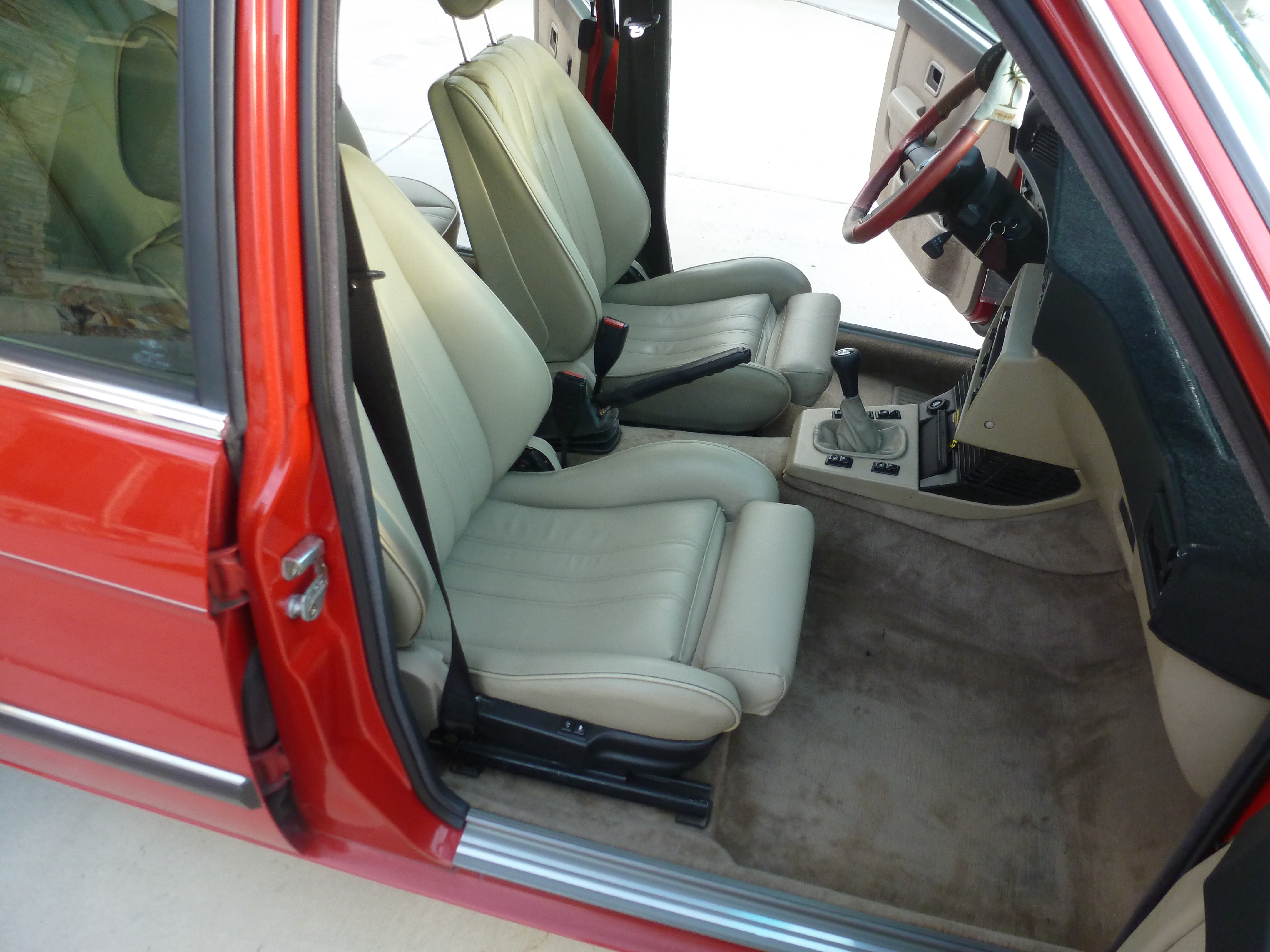

Well...a few months after purchasing the very nice PB sports and Stebro Exhaust from Kohler, I was able to transition my manual interior to power. The pics don't show the console that I've since put in that holds the switches. I also was able to install the Euro Headlights and tint the fogs. So much put into the car over the last 12 months so I think I'm going to take a break for a bit. ;)

Thanks for the compliments. I'm still trying to track down how to get the leg bolster (or the powered portion of the powered thigh area) of the seat to work. Been researching on here and haven't found anything yet. Anyone have any ideas? Everything works great on the seats except for that.

I pulled both front seats, and checked motor function. One motor had its wires cut, so check the wiring to the motor (just glance at it, should be fine). Then, I pulled the motor - 2 8mm bolts holding it on I think. It spun the square-drive cable, but inserted, would "bind up". I tried the coathanger piece trick, and it worked on the headrests perfectly. I ended up zip-tying the cable that drives the leg bolster to the seat, after playing with it under tension showed that it fixed the bolster and it moves now. I think probably a more elegant fix would be in order. My other bolster worked, and I was going to replace that seat anyway (though it is quite clean and now it all works and has for many months). I think the cable is binding up slightly. I can detail more for you since I have been there, like I am sure dozens of other guys on here. I learned from them, happy to show you what I know.
