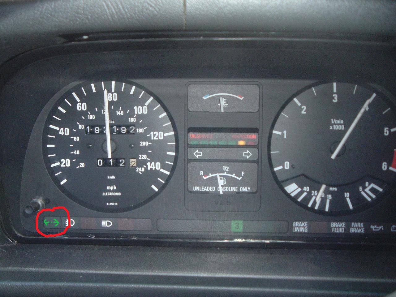

I could not find this in the Bentley or the Haynes, maybe I'm just looking in the wrong spot, so hopefully someone can tell me! I have circled the area where it is and poorly draw what it looks like it has two arrows pointing in the opposite direction with a dot in the middle, it lights up green. Thanks.

I had that on my Euro 525 e28....never figured out what it was for.

Certain Euro models do not have the same separate turn signal indicators we have between the fuel and coolant temp gauges. They use that common bulb to indicate either direction is operating. I'd guess that you have a lamp in somewhere where it shouldn't be because our clusters don't normally have one in there. IIRC, we only have a lamp for ABS and CEL (non-functioning), all the others are twist-lock bulbs in the PCB. Why it's lit however is a different story. When you turn the key on does your ABS light illuminate until you start the car? If not perhaps that's where this lamp belongs and you have an ABS fault. Otherwise I'm not sure why your CEL would light on an 87 535.

My ABS light does come on and turn off when car is started and so does this light. Weird. Ok, thanks for the input!

All E28 must have it, mine does though the left one does not stay on... :roll:

The manual states it is a Trailer turn indicator repeater lamp.

Zach my car has it but it not lit. I found it because I accidentally put my CEL light in that spot instead of where it goes. :oops:

All E28 clusters I have seen have the spot, just not a lamp in it. I wonder what the ETM says about the wiring, I've never checked. This is likely part of the mystery behind some of those unused connectors behind the cluster.

I use that indicator for my alarm on light. It flashes when the alarm is active. I of course put it there, so meh.

That light is for turning signals on trailer.
I have on my bmw instaled originaly tow bar and when you connect with trailer it signals on board

If this is what I see when I turn the ignition to accessory in my US '88 528e, can I assume that the bulb from the anti-lock socket is in the wrong place?

Don’t want to know about the P being lit up, but yes, probably a relocated abs lamp. Easy to stuff that one in a few different locations.

I checked to see if my ABS light was missing, but like the OP, there is already another light there too, it just doesn't turn on with the ignition. Maybe it's burnt out. Is it possible that the mystery light should be in the Check Engine position? My car is a Super Eta and if I remember correctly, they're actually supposed to have a functioning CEL, unlike most e28s.
