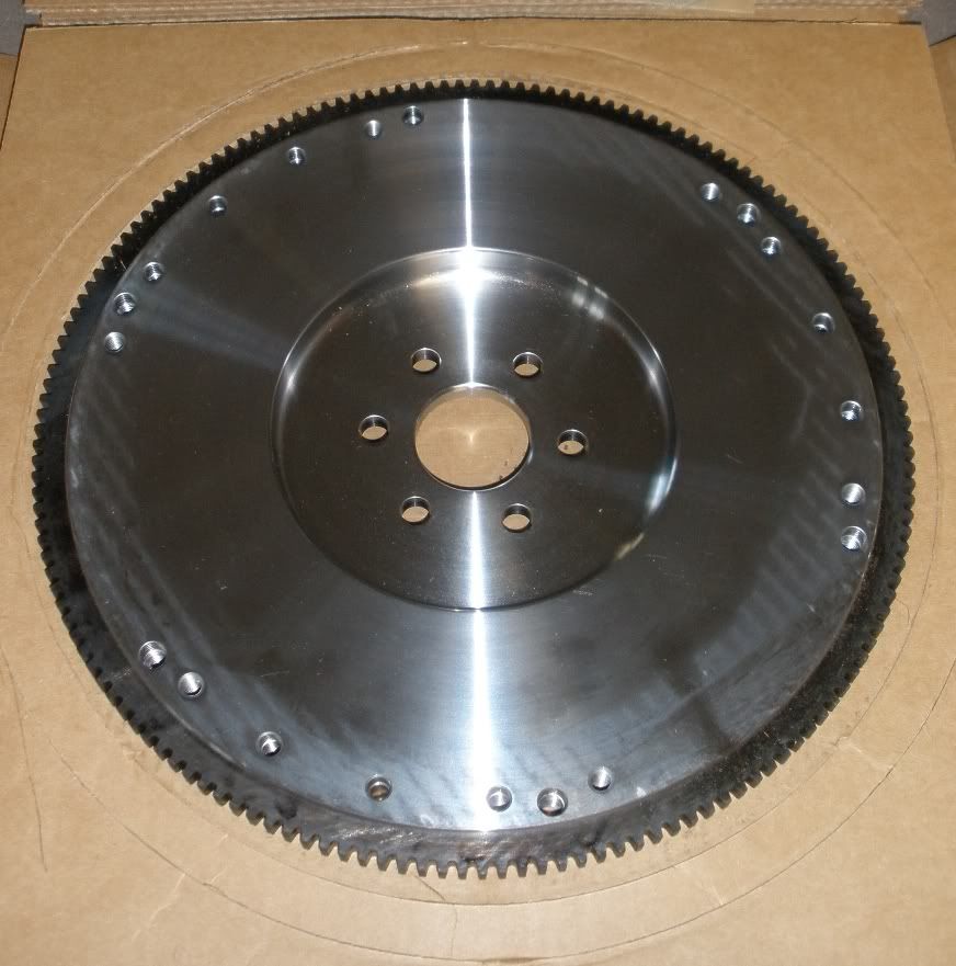

SFI billet steel flywheel...........check. Once the clutch pressure plate gets here, the crank comes out for rotational balancing.
Crank is out and with the flywheel, pressure plate and harmonic balancer getting balanced. I am using the same guy who built the engine two years ago. Because he weight matched the rods and pistons, he does not need them.
I am doing this because the engine was balanced with a flex plate.

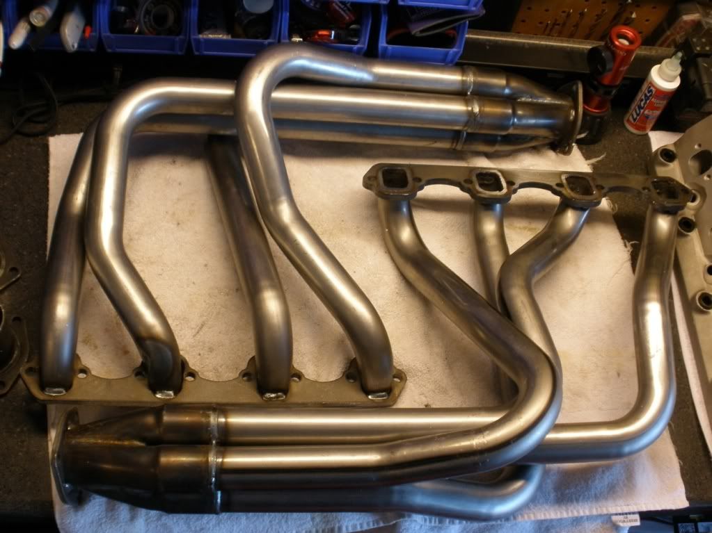

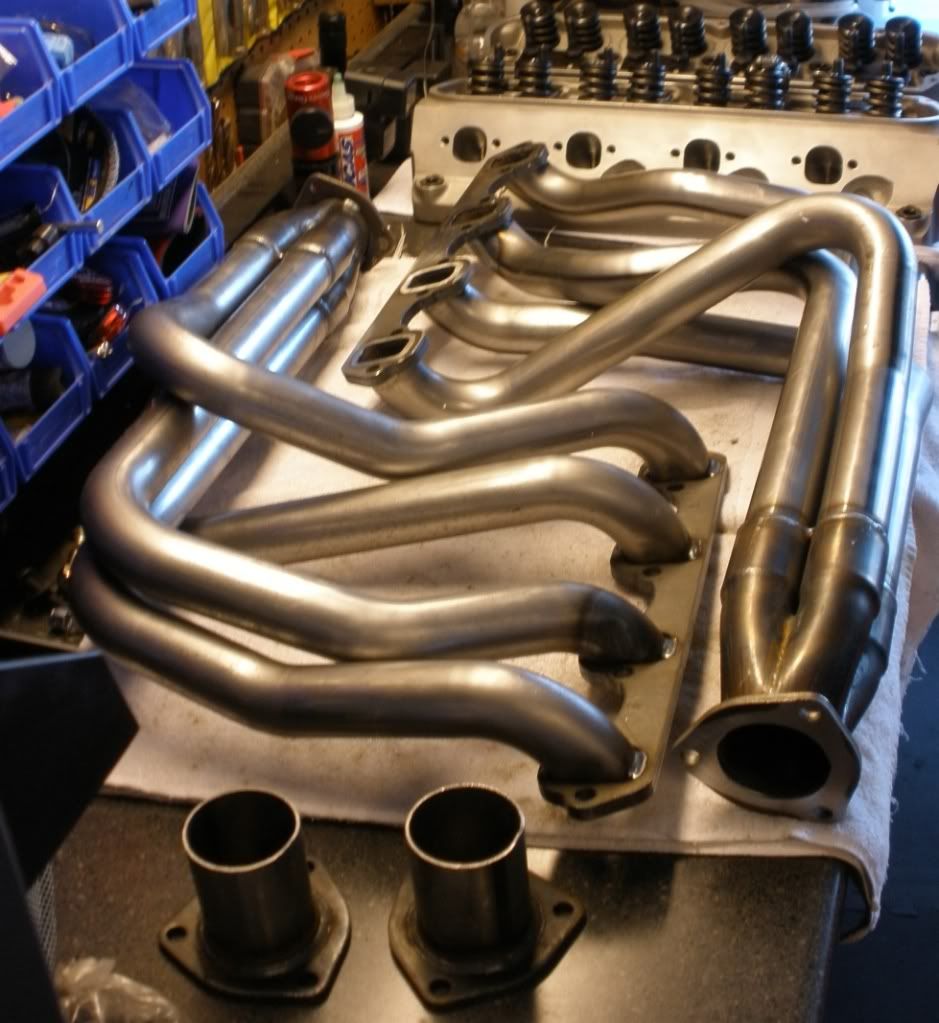

SNAKES IN DA HAUSE!
Not Hartge prices but close.
Will be mounted on the engine, installed, all clearances checked, engine removed, Jet Coated, then installed again. R&Ring headers while engine is in the Tiger is impossible.
Price you pay for BIG engine, little car.

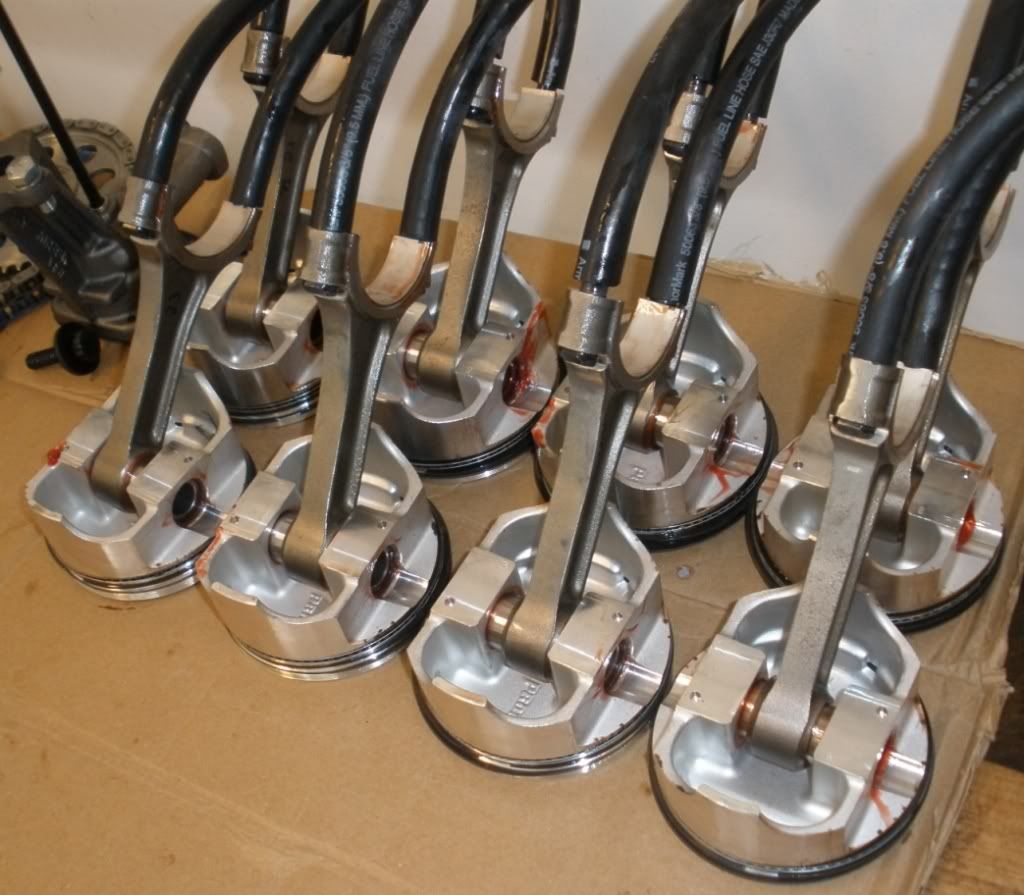

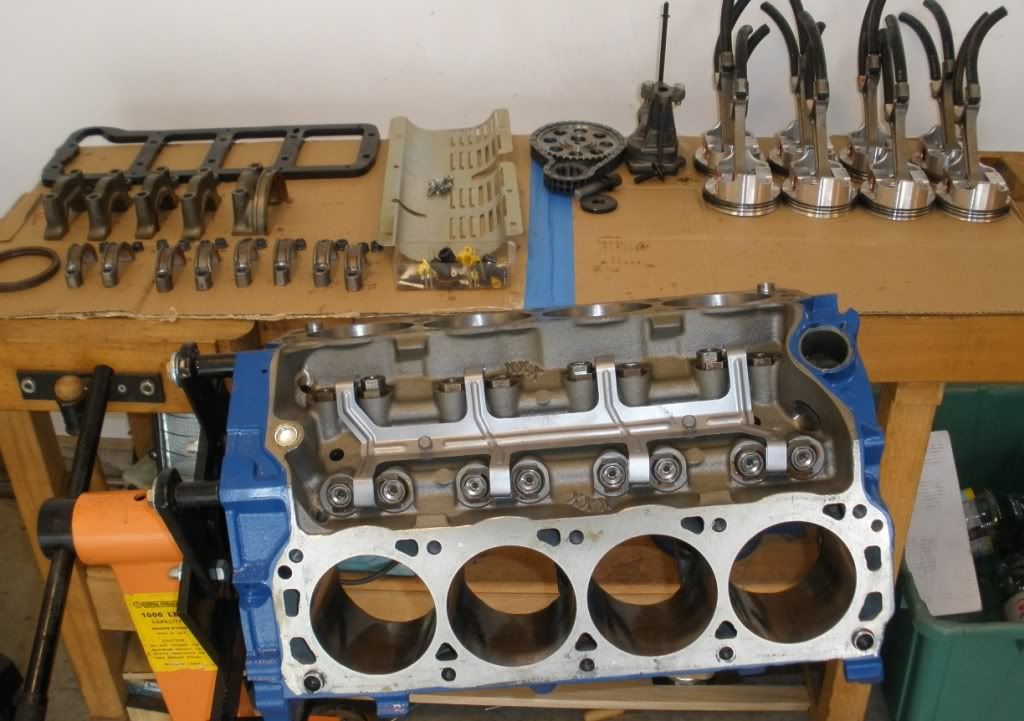

Crank is back from being balanced with the new flywheel. Short block is assembled.
Today I cleaned up, painted and installed the 1964 timing chain cover. Also installed the harmonic balancer and water pump. I'm gonna pull all of the lifters and soak them in oil overnight. Heads go on tomorrow.
