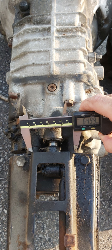

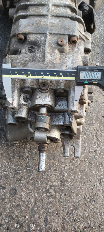

I call "shifter mecanism" the whole complete thing,all the parts comprising the shifter.I guess I could call it a shifter assembly.
I got my two transmissions side by side for a comparaison.I wanted to know how different they are to shift and if I could adapt
the shifter assembly from a 260/5 to the 265.I found they are too much different.
I partially awnsered my questions;
-"Could someone adapt shifter assembly from a 260/5 to a 265 ?" -NO
-"Would someone be better finding 265 shifter parts and adapt to specific car ?" -YES
-"Must have parts one cant do without" -DUNNO
Here are some pics showing key differences:
The selector rod travel length is significantly longer on the 265.This alone disuaded me from attempting to adapt.
Selector rod sits lower than threaded mounting holes on the 265,higher on the 260.
Threaded mounting holes are spaced wider on 265(may be dependant on tail housing)
Hope this help others navigating through the amazing world of M30's various transmissions.
